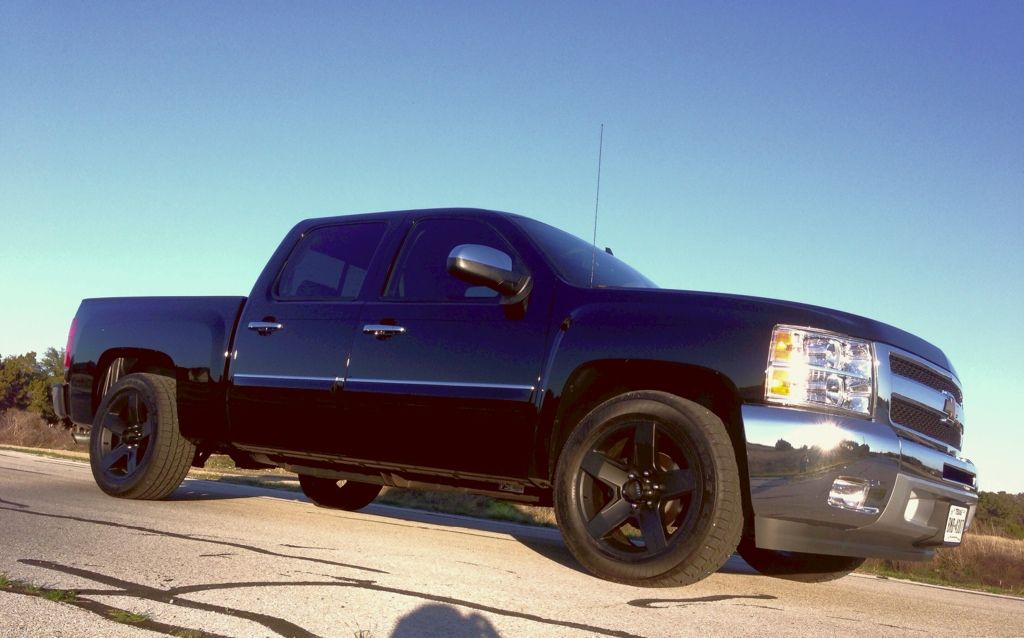

20" method fat 5s would look good and are pretty cheap as far as 20" rims go. They would tuck pretty well into the fender well with the backspacing they have.

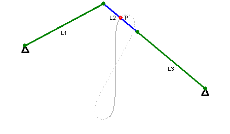

Can you explain How the watts Link works jim? Wanting to go full air ride on my dually n looking for info
Sent from my SCH-R530X using Tapatalk
rat49f6
1,259
Vernon,NJ
The benefit is it will give a larger range of motion (up/down) with out side to side axle travel a trac bar causes.

If I were to have used a triangulated 4 link I would not need a watts or panhard
The watts is more like a double panhard if that makes cents ill try to find a utube video

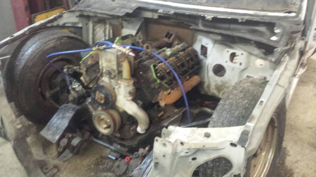

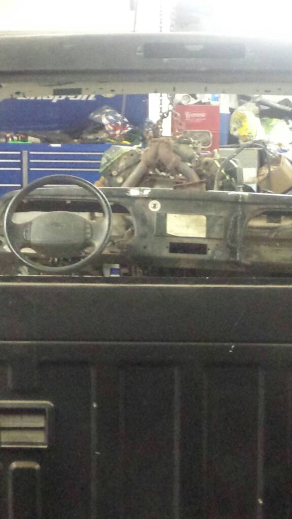

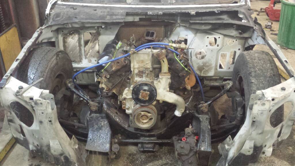

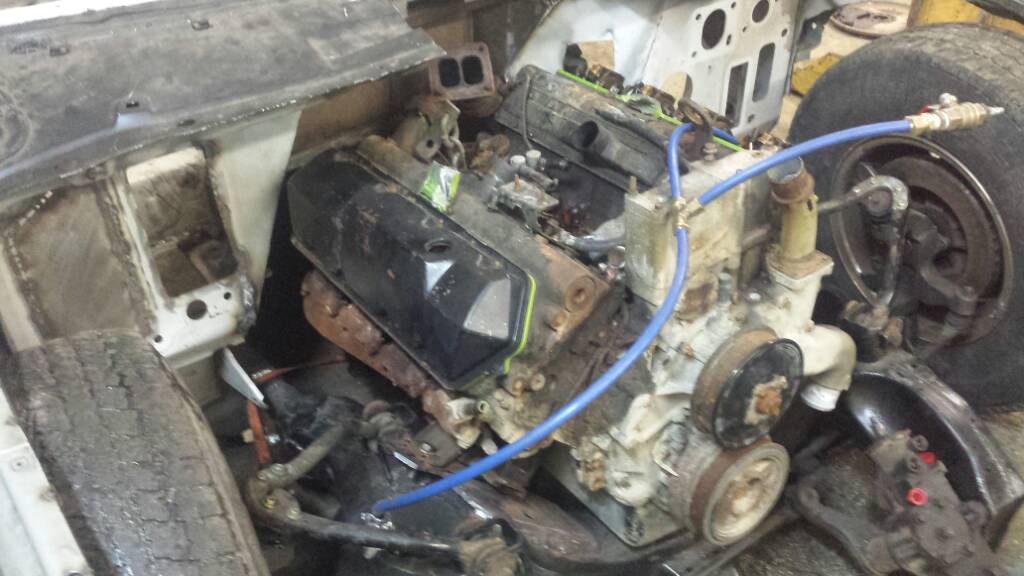

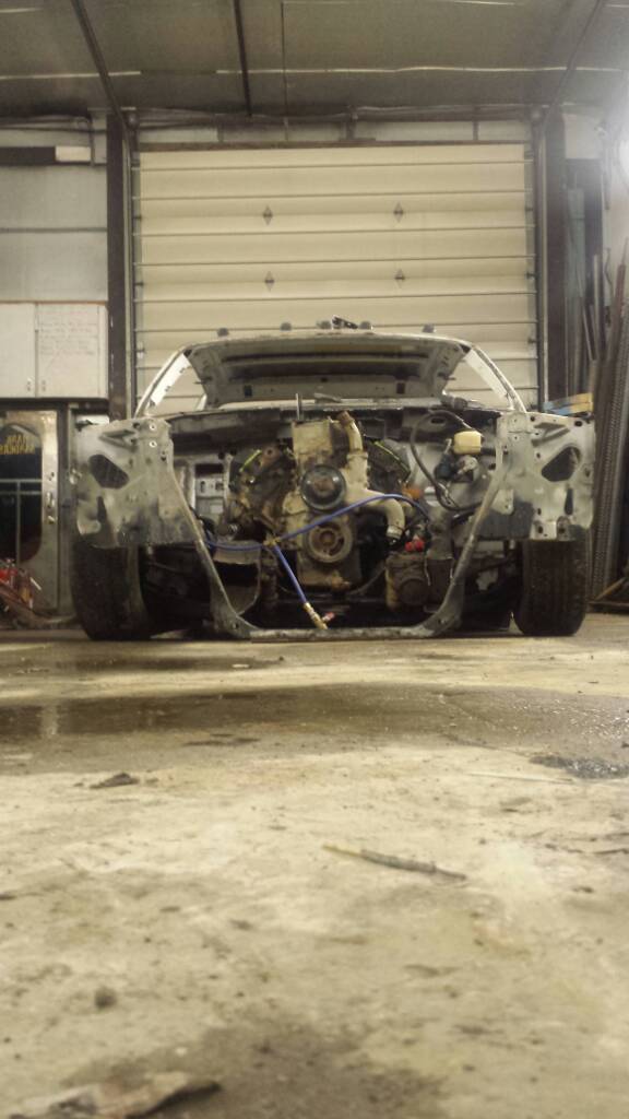

Engine going down into the bay
Mocked up in the bay
Today we have to make mounts for the frame that mate with the stock mounts
I think i have an idea how
Sent from my SGH-M919 using Xparent Green Tapatalk 2
rat49f6
1,259
Vernon,NJ
Engine and trans are mounted... trans ials 100% and the engine mounts are about 90%
