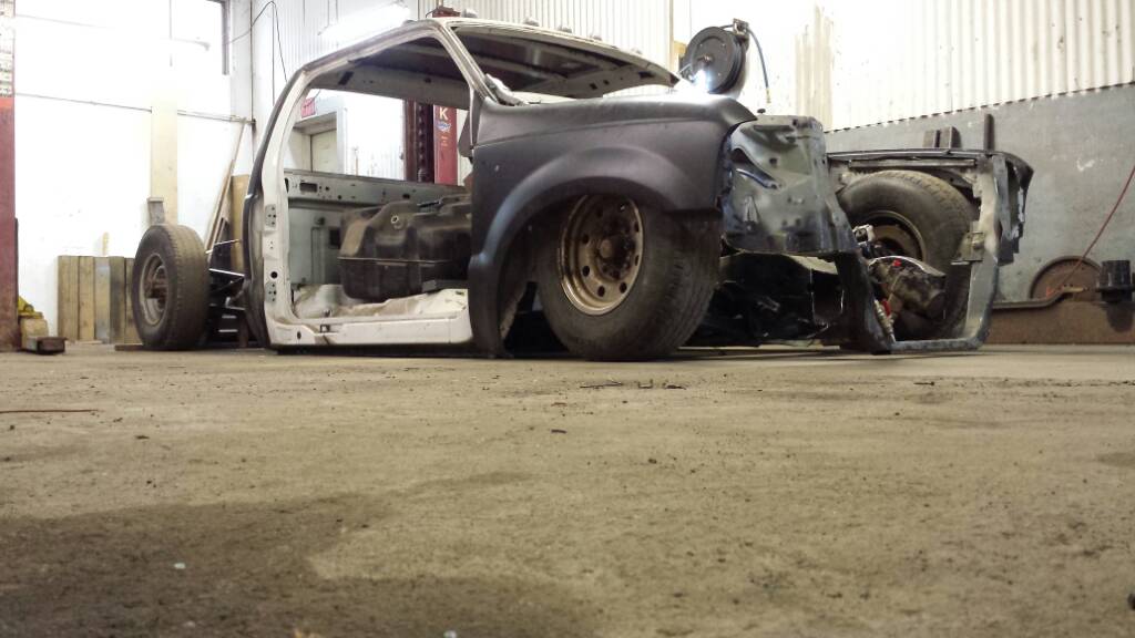

Swagger is a roller for the first time in over 3 years!!!
Full lift...
Lowered... it eill go much lower once I clearance the fender supports

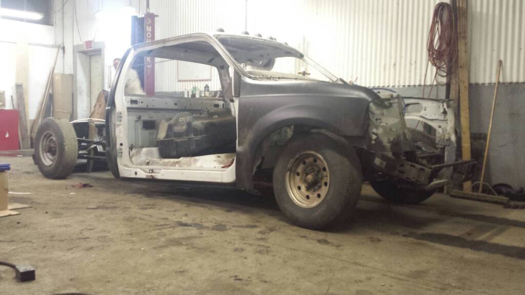

Ad8 PRODIGY
Nov 15, 2011
7,742
Orange County, NY
Yep. Front and rear of the pinch welds touch and all between them. Ride height is only set with a ball valve and shop air so don't judge it too closely.

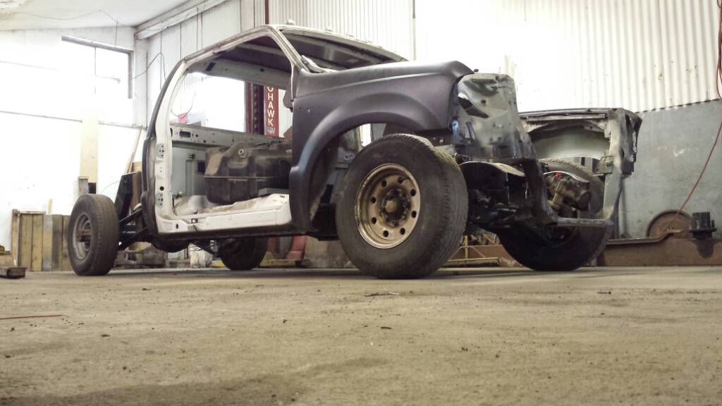

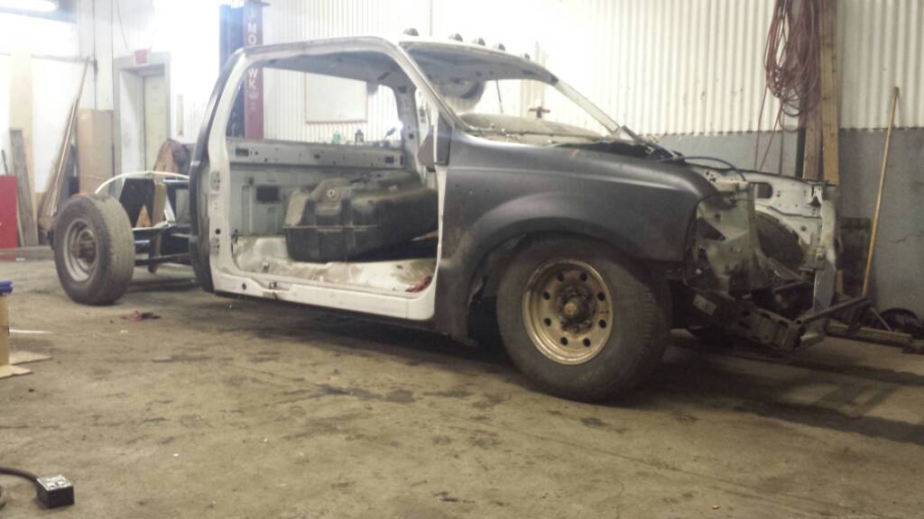

More pics taken from the same perspective as each other
Full lift
Fully down... pinch weld lays from front to back
