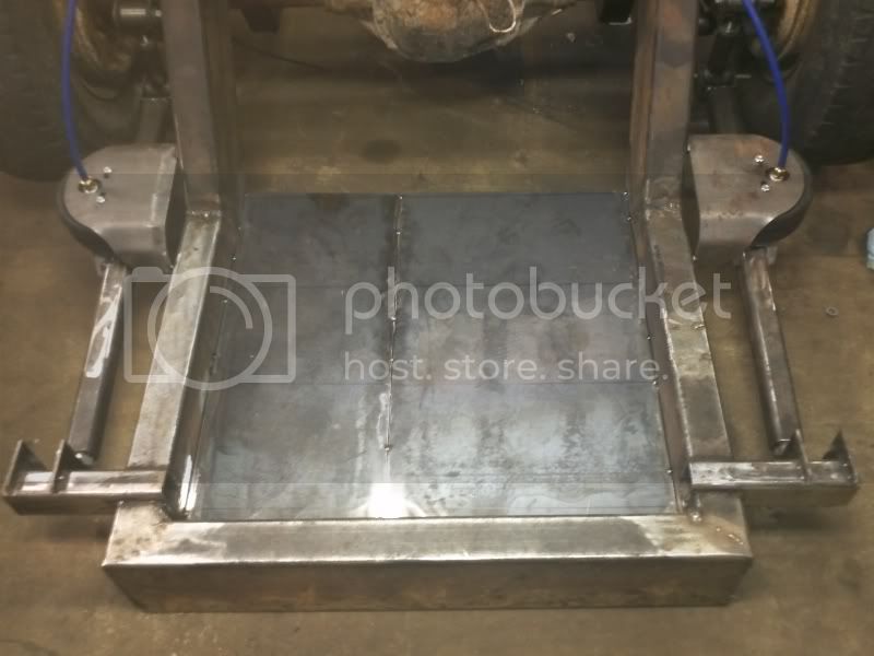

so greg headed down for Friday night and today worth of work
figure i wont have power so he headed home before it gets bad

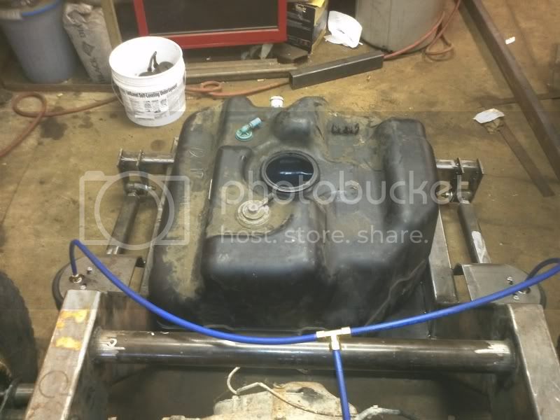

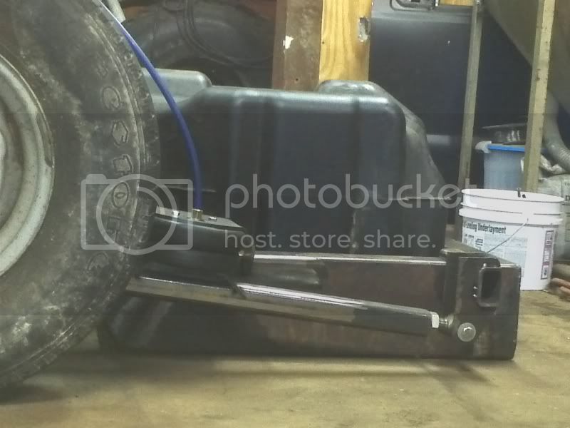

made a platform for the Excursion tank to sit on
the factory skid plate was just to much and way to heavy
the 18 gauge is laid on top of a frame of 1"x1" 1/8" wall grid 4" off the ground
tank in place

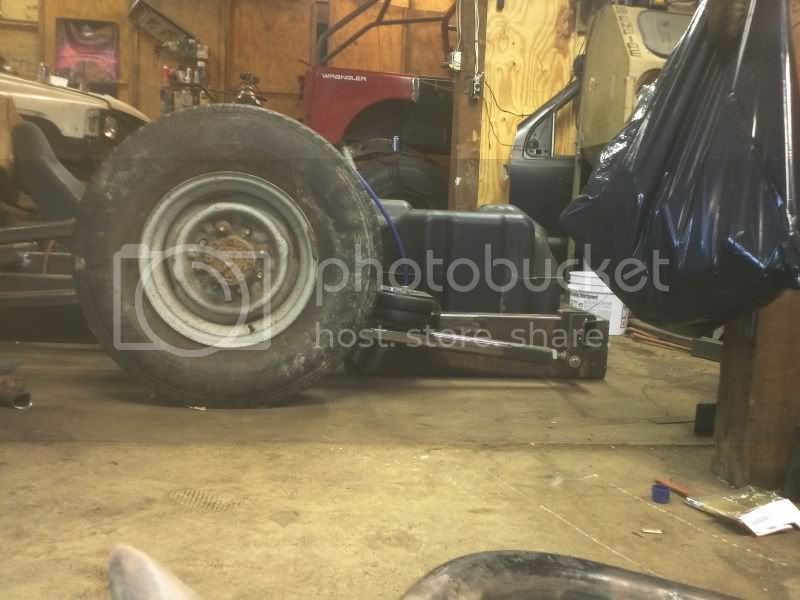

from the rear
drivers side
front

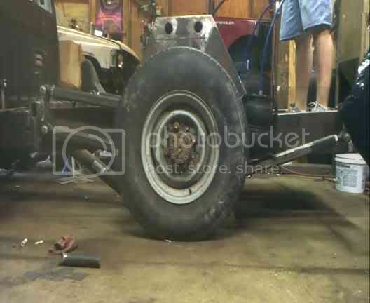

video of the suspension (click)

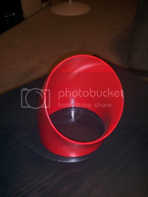

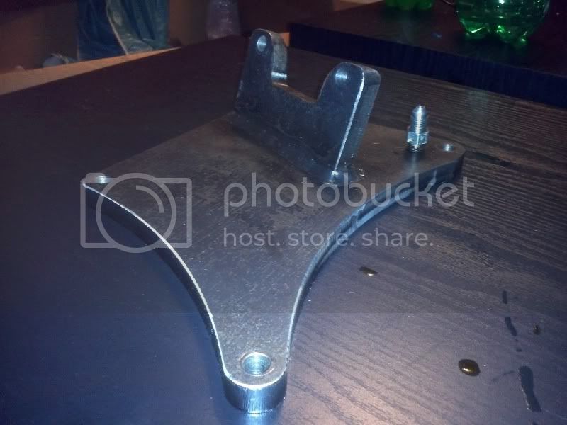

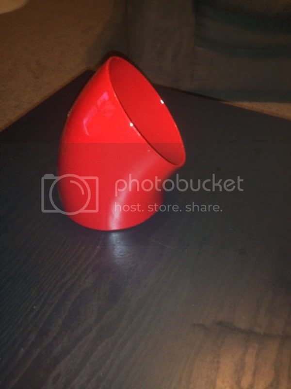

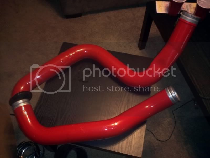

got to work the other day and found a huge box wrapped in yellow tape that weighed like 30 pounds
this was inside:

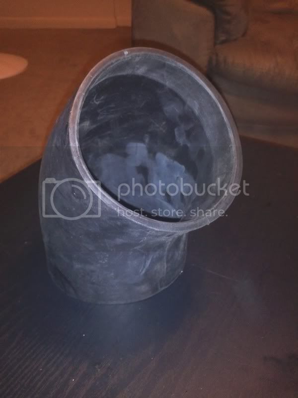

t4 turbo mount
t4 uppipes
inter cooler pipes
intake elbow
turbo elbow

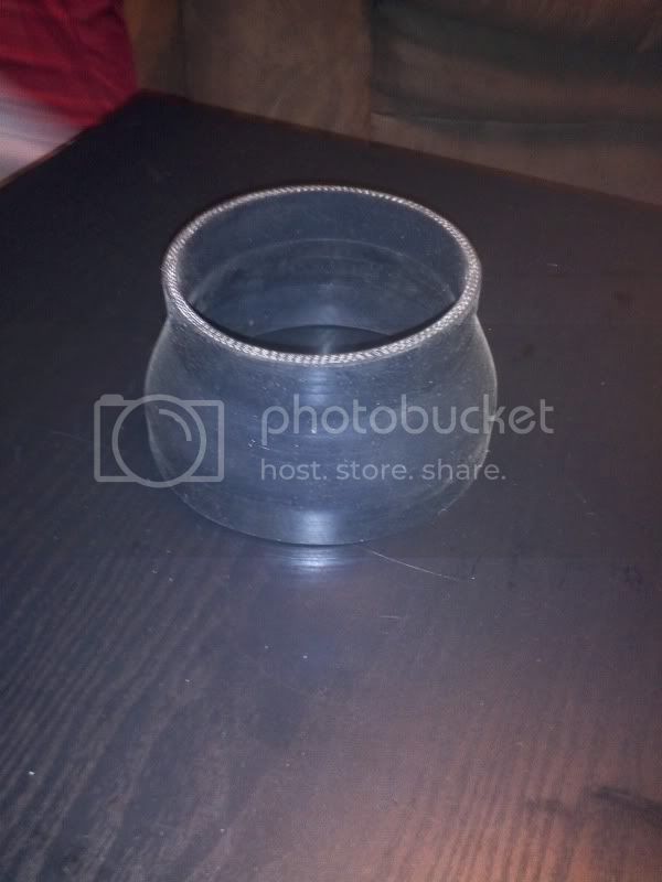

intake adapter
Misc clamps
the pipes are powder coated the wrong color for my truck but that will be an easy enough fix
all these parts are custom one off as of now so if interested you will have to call Clay @ Riff Raff about building another set up
