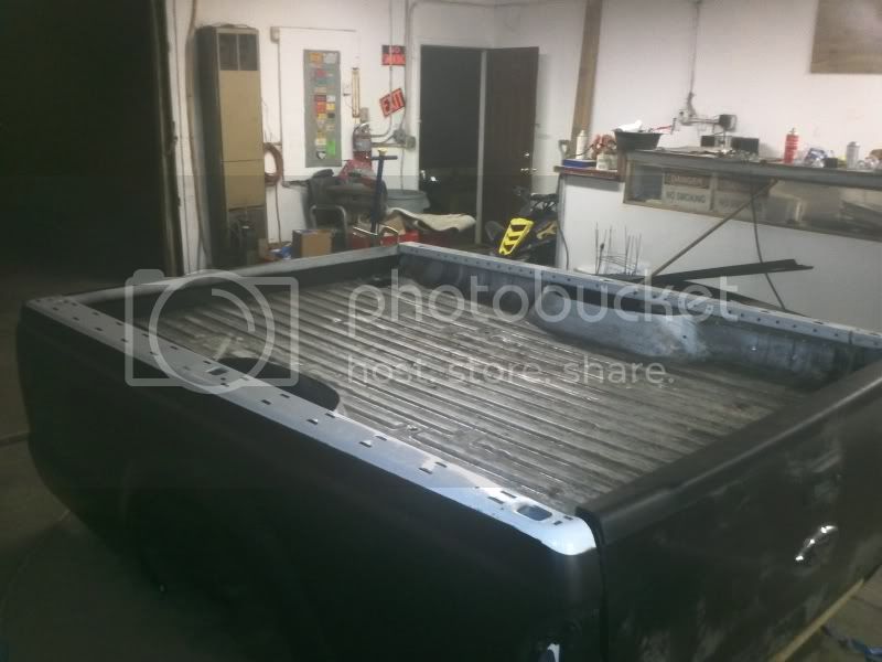

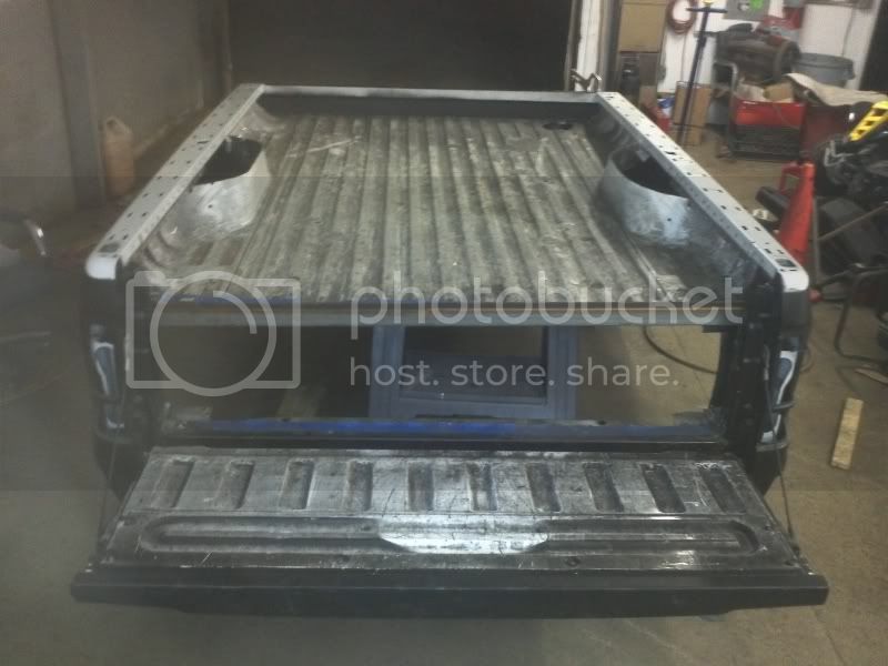

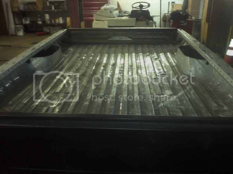

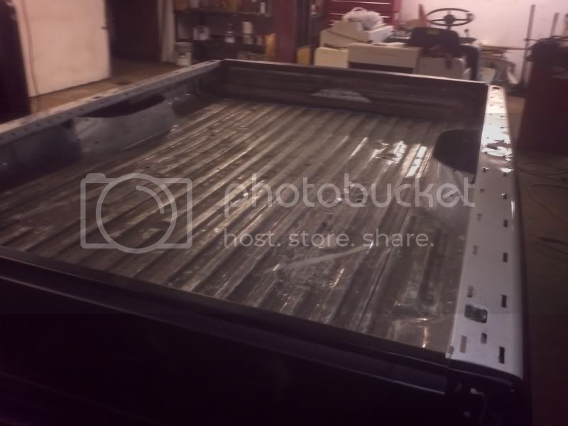

floor mocked in the bed sides:
from the front
back with tailgate down
from rear drivers side with tail gate down
from drivers rear with tailgate up

Thats crazy. I know I have seen the bed floors lifted like that before on trucks, but just never that high. Gonna look crazy when its all finished.
Just a thought, but are you going to put anything below the bed floor between the tailgate and the "C-notches"? Seems like it would be a great lockable weather tight storage spot or something of the sort. Probably plenty of room between the cab and "c-notches" for compressors and tanks too keeping it all below the bed.
rat49f6
1,259
Vernon,NJ
in the back under the bed will be the the fuel cell our excursion tank...not sure which yet
20 gallons of air up front of the notch straddling the drive shaft
Water/ meth tank somewhere under there
all the valves will be mounted back there if I can't get them under the seats
Also plan on putting, dual sd pumps on the rear rails rather than under the cab
