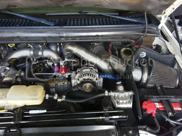

All said and done I didn't have to swap VC's just had to do a little firewall/doghouse hammer time im running a 5.5" inlet to 4" to 6637.. its tight but works.
It looks like it isn't sealed in the pic at the intake pipe.. but it is.. theres maybe a 1/4" gap idk why it looks so bad in the picture
