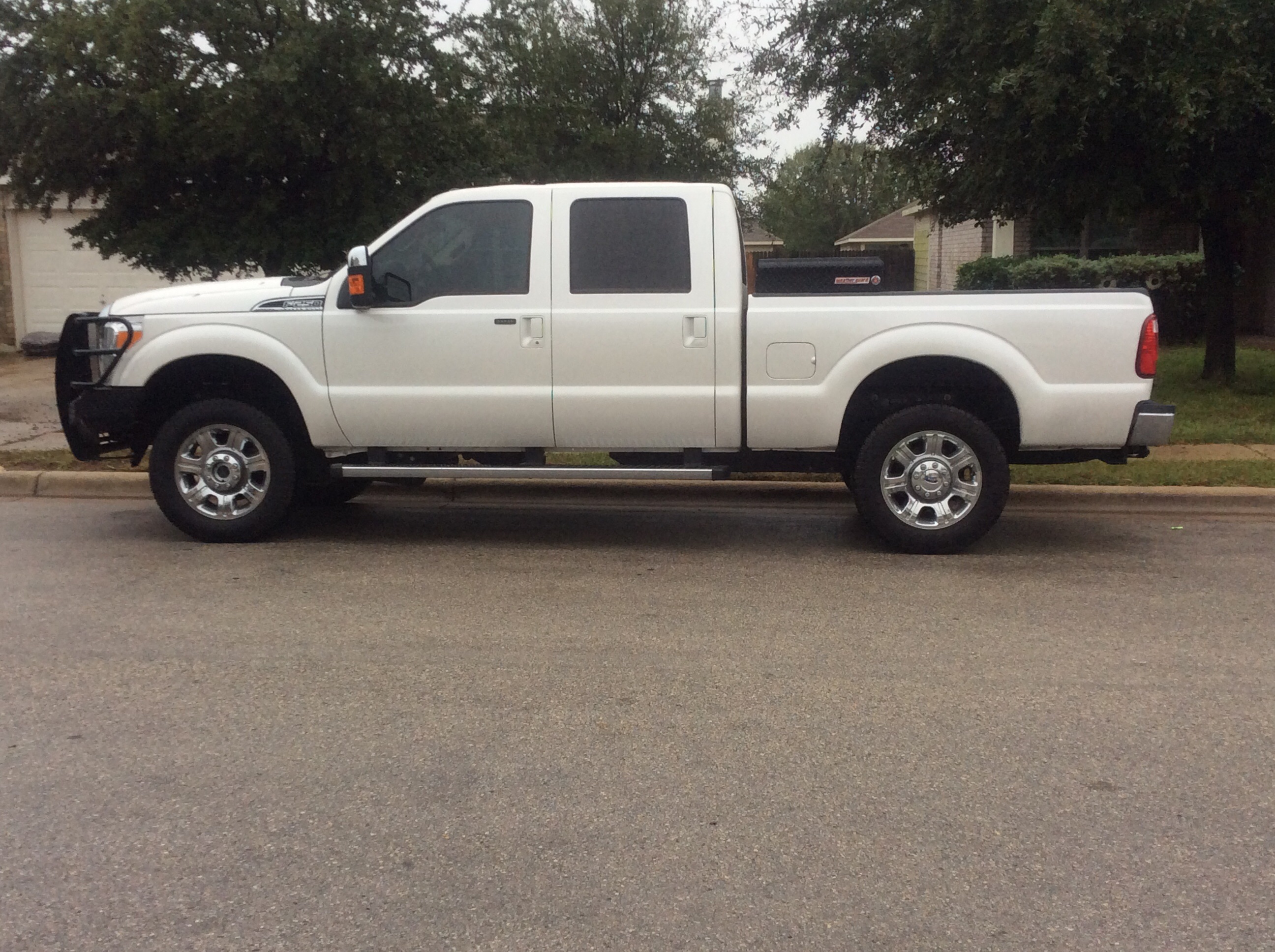

Here it is on this drizzling morning...dirty too.
ETA: 2.5" Carli springs, blocks in the rear, track bar relocation bracket, Bilstien shocks...nothing too special or extravagant, but I love the way it rides. Next will either be traction bars or Fox. Next set of shocks will definitely be Fox. This side sits an inch lower than the passenger side. It was the same way with the factory springs, so not a leveling issue...other than I haven't messed with fixing it...

1/4" spacers (3) needed to level it driver to passenger side. Worked perfect on my truck. It sat an inch off as well
I know...now that you and someone else have posted about it. Thanks for the reminder. Did it help the rear a bit as well? It's just not in the cards for me to mess with right now.

Yes my truck sits exactly 45" now on all 4 sides. Truck looks much better now. Before you could tell something was off with how the stance was. I started with a 2.5" level kit(added 3 spacers to driver side) and f350 blocks

Thanks, bud. I had an 800# electric motor in mine the other day. I thought it looked like it was low in the rear. Bothered me enough that I put a tape measure on it...level front to rear. Tells me I prefer a bit of rake, especially so it doesn't sit ass low with crap in the bed. I'll fix one thing at a time though...lol. If I can fix the right left discrepancy, it'll tell me what blocks I need in the rear to go with the bars.
