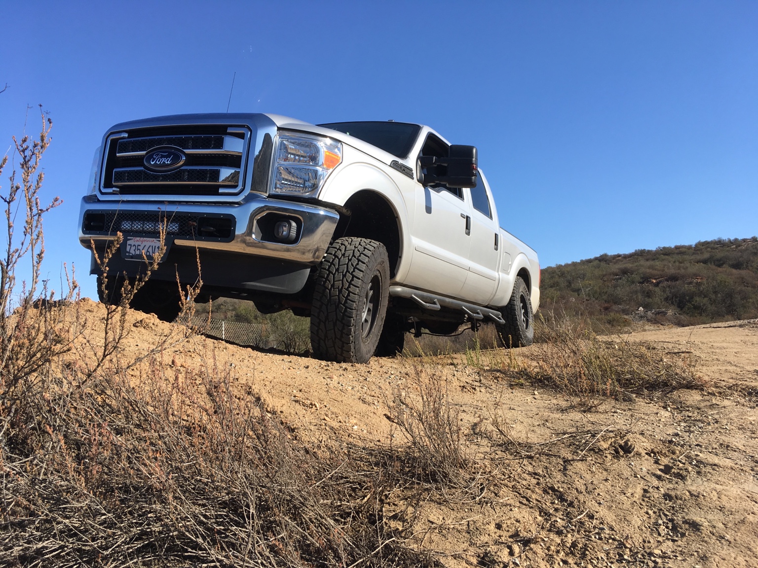

Took the truck up a small trail to test out this new Carli kit. First time it's seen dirt with the new kit and tires installed. Felt good. Can't wait to play some more.

You'll be wanting kings soon LOL.
Looks great, I'd install a 2wd valance, would make it look perfect.
ImAti0n
May 8, 2016
225
Trust me. My wishlist are the kings, steering stabilizer, and Carli radius arms.
And yes I agree. I've been searching the classifieds looking for one.

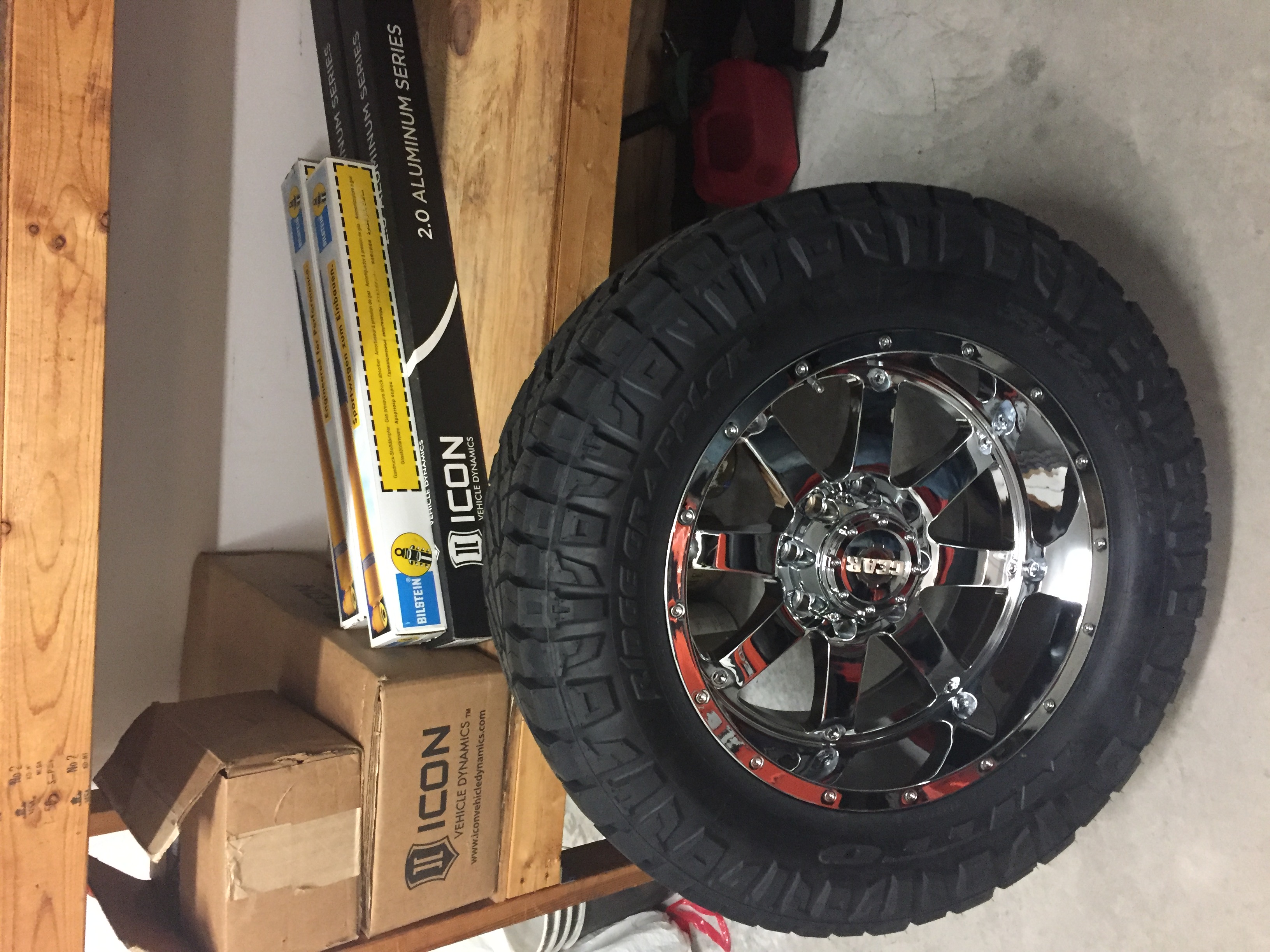

12 days of Redneck Christmas:
-2.5" Icon stage 1 kit
-2.0 Icon front shocks
-1" BMC spacer w/ radius arm brackets (temporary until 3 link)
-5" rear blocks (in the mail now)
-5100 Bilsteins rear shocks (F350 w/ overloads so it's not exactly smooth anyway)
-20x10 Gears -19mm offset w/ 35x12.5 Ridge Grapplers (load rated for what I needed)
Ready to get all the parts in and installed. The truck already has a readylift 2.5" kit on there so I am going to utilize some of those parts for this new setup like the track bar bracket and sway bar brackets. Was going for what would hopefully be similar to what triplee44's old setup used to look like. Still need to get traction bars, a 3-link kit for the front plus an EZ LYNK at some point hopefully. But in the mean time I'm just looking forward to installing all of this when we finally close for Christmas!

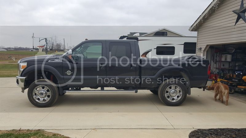

ReadyLift 3.5" SST kit. Will be putting on 35x12.5 Firestone Destination MTs on the stock 20" oem wheels this coming week. Will go with Fuel Hostage 20x9 or 20x10 black in the future.

How is your ride quality with the 3.5". I just bought the 2.5" but haven't got it installed yet.
