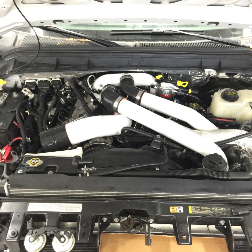

Made some good progress today. Finished up the fuel up top, relocated the regulator, installed all the piping.
Still need to adjust the clamps and line everything up better. Also have to run the return from the regulator to the low pressure pump.
Tommorow I think we're finally going to cut and shorten the frame and then next week we will 4 link it.
Coming along good now. Hopefully it should be driving in the next few weeks.

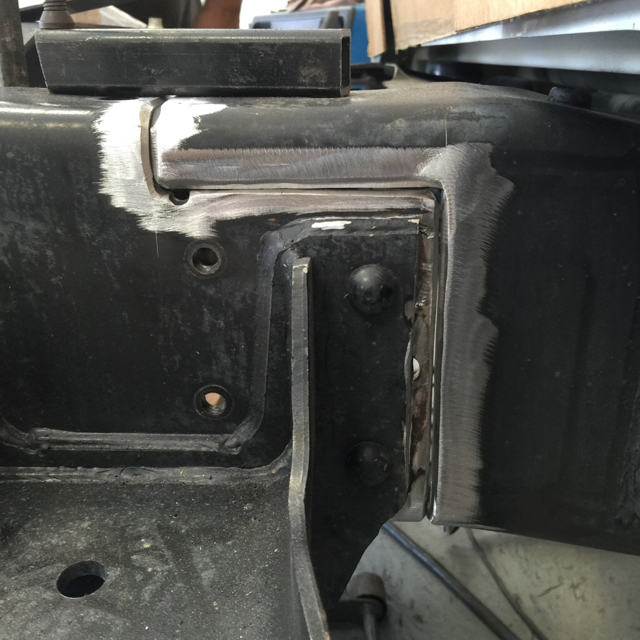

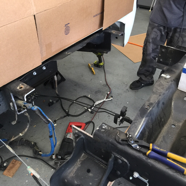

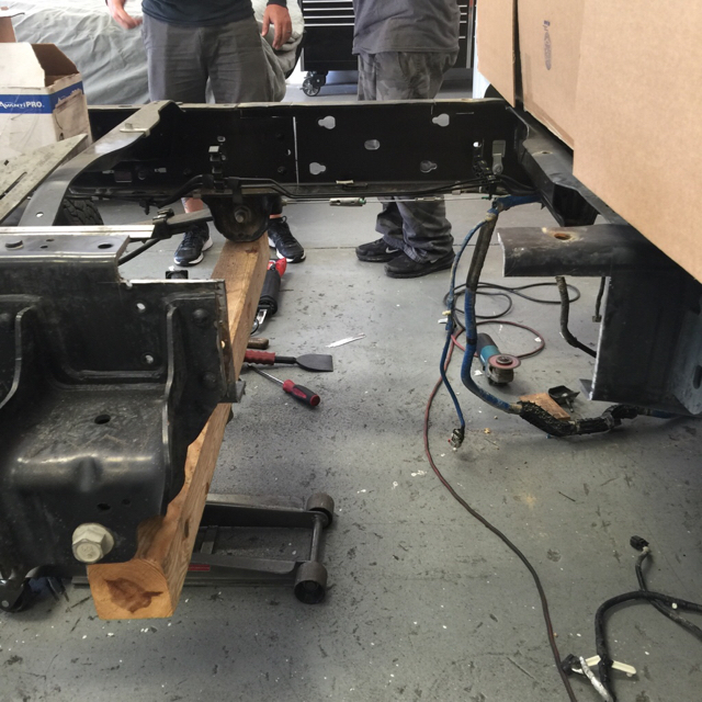

Made some big progress today. Finally fot the frame cut and reassembled. It worked out so nicely that we have decided to keep the leaf springs and just remove the blocks to lower the truck a couple inches. This truck is a fun toy and a shop truck. We would still like to be able to move around a trailer if needed so the leaf springs seem to be our best option. ImageUploadedByTapatalk1437438910.133591.jpgImageUploadedByTapatalk1437438919.750584.jpgImageUploadedByTapatalk1437438936.452115.jpgImageUploadedByTapatalk1437438946.337309.jpg
1,759
South Florida
If you look close, we had to cut part of the front leaf spring hanger back in order to make room to do what we needed. We also zig zagged the frame to get more welding surface area for extra strength.

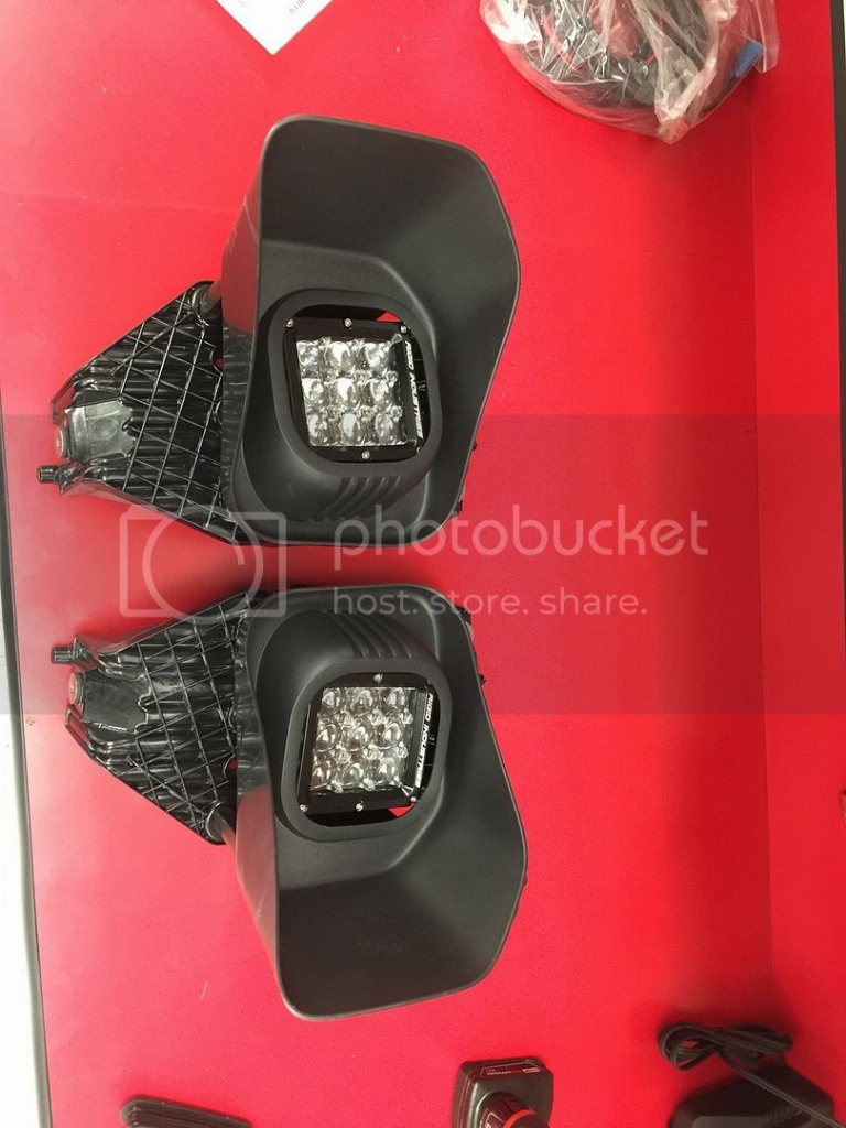

Thats the exact way I had my mirrors done! I sure do miss the way it looked :( BEST of luck to you bro, cant wait to see it finished! Wish I got around to installing the duallys in my bumper also.

Josh, That thing is looking awesome! I'll trade you an old clean 97 standard cab when your done:)
Lmao!
It does look awesome, Josh, but if you would have let me know I would've given you my Recon mirror signal smokes. I put the Recons aside and had my stock lenses and third brake light spray-tinted, and they both look awesome!
Damn I just bought some lmao
