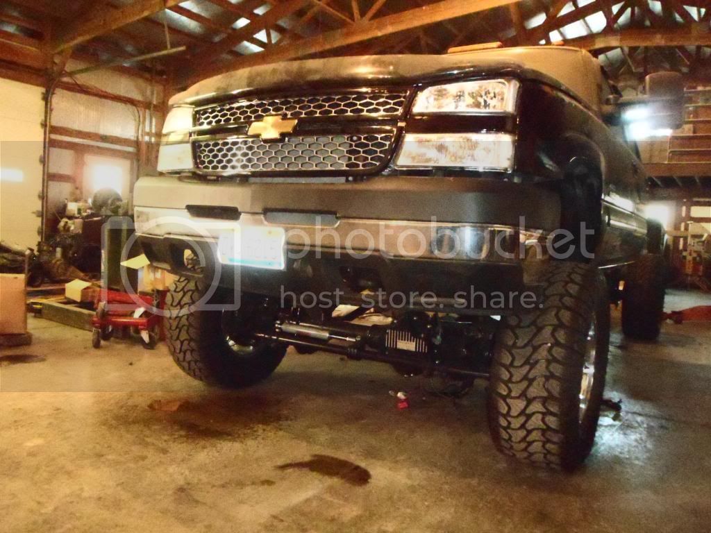

Mocked up the bumper, grill and headlights for the first time at the end of the day - pretty sure I'm going to be real happy with this with just a few more tweaks :D

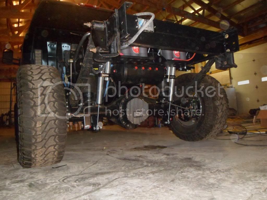

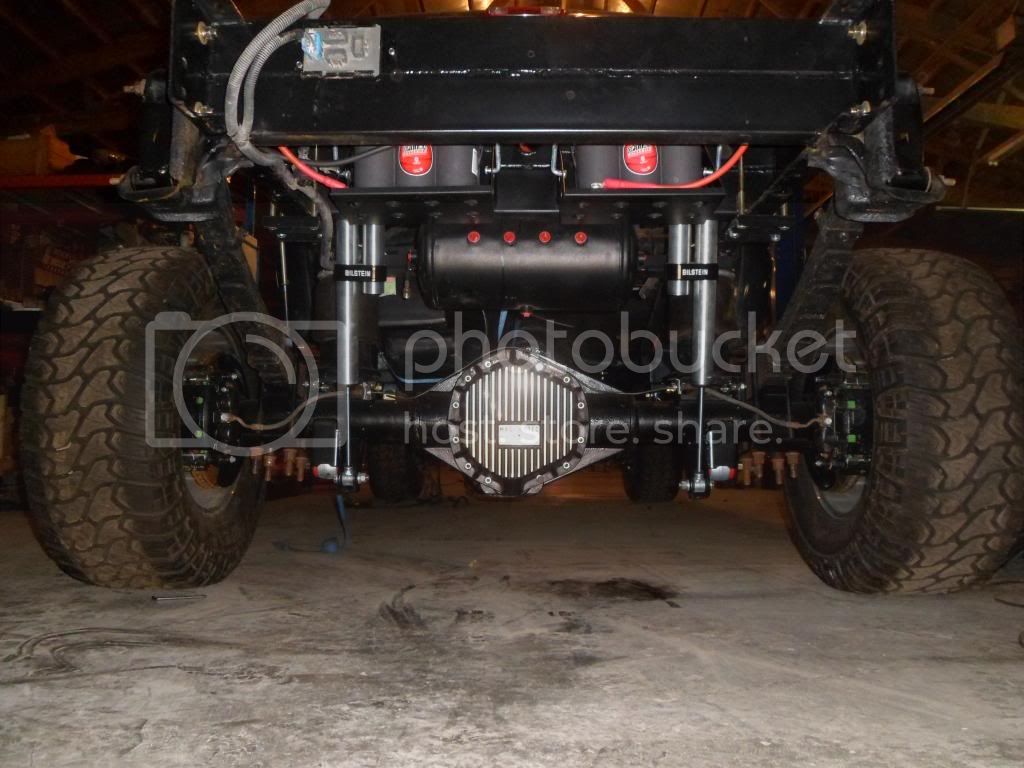

Assembled rear rolling stock:
