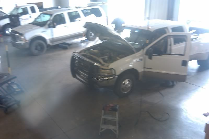

So I walk in and Brian says 'you changed tire sizes since you were here, how does it shift?' I told him it shifts hard, just like he said it would if I went back to 285/75/16's (I had 325/60/18's when he built trans). He asks one of his guys to bring my truck in the shop, then 'asks' me if its OK for him to change the shift plate - I don't think he would have let me say no... I told him I thought my trans temps had been a little high in this HOT weather towing my TT, I had seen 220* pulling some grades in TN. He said something must be wrong and started looking. They found the bypass line was bent or something and replaced it. I am to call today and report temps from drive home - which were the 'under 150*' they are 'sposed to be!!
I asked how much for changing shift plate, filter and fluid (he didn't like my 20k mile fluid that had been 'warm') and he said 'covered by warranty'... Considering I changed tires after he built trans, I think that is an example of going above and beyond what is expected.
His tunes made 324hp/617tq in my X last weekend with a plugged up air filter. I didn't think that was bad for a 260k mile stock truck! There were other trucks on the rollers that day with AC codes and a 38R and live tuning from a 'popular' tuner that didn't make much more than that... I didn't look at the board to see all the other #'s, but I think Chris from Diesel World said he would publish them!

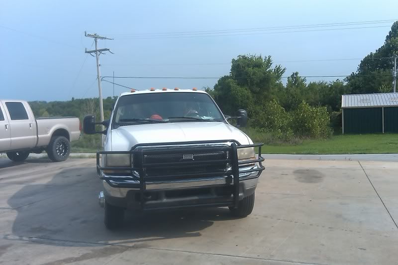

Here's my friend Frank heading out on his test drive with Brian!!
That Almost looks like Gare's(PTSuperD's) old truck in the second pic in the background
