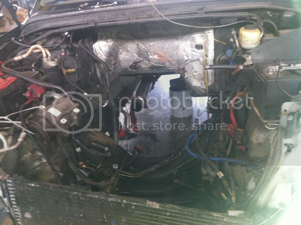

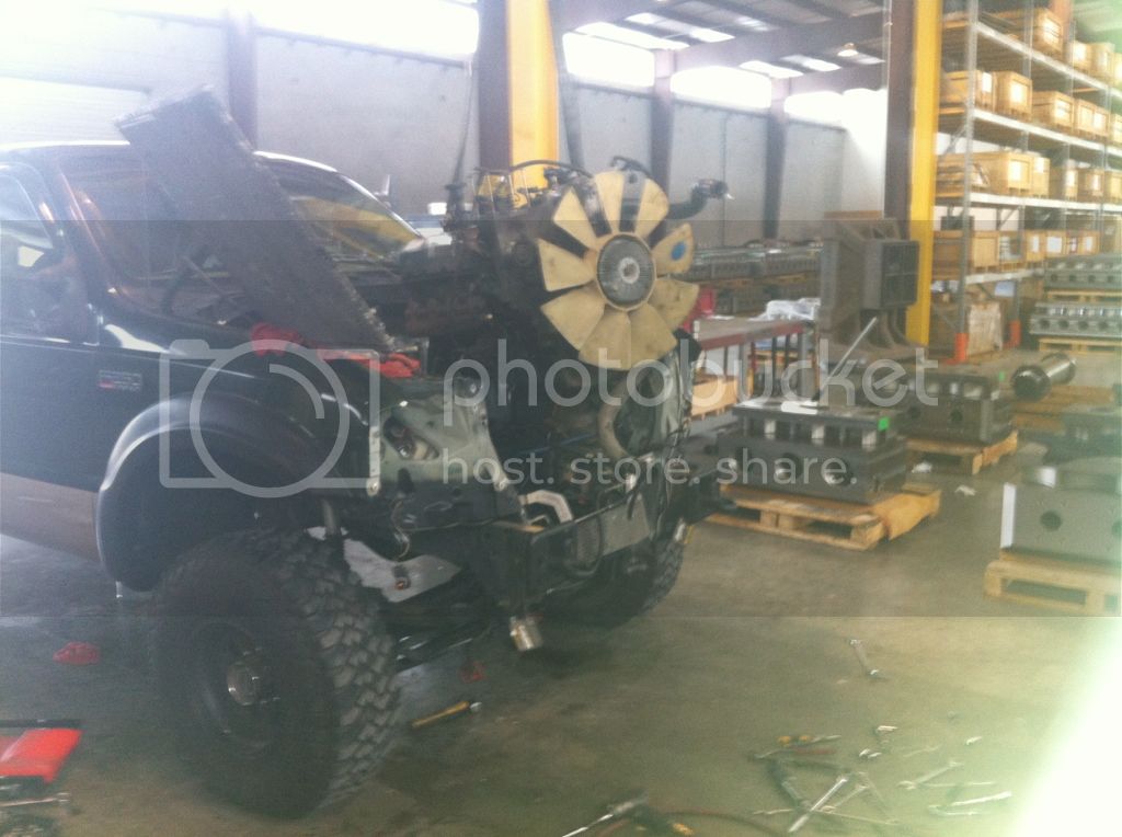

Take the whole front clip off and the engine and tranny will go in together. Its not an easy task any way you go about it.
Whole clip is out, that's how I got the engine out. It just seems like there is enough roof to slide the tranny and engine in the bay as one peice but I've talked to a couple of people that have done it before and both say to install them seperately. I was hoping to hear from someone that has done it both ways with pros and cons so I can weight them out for my application.
