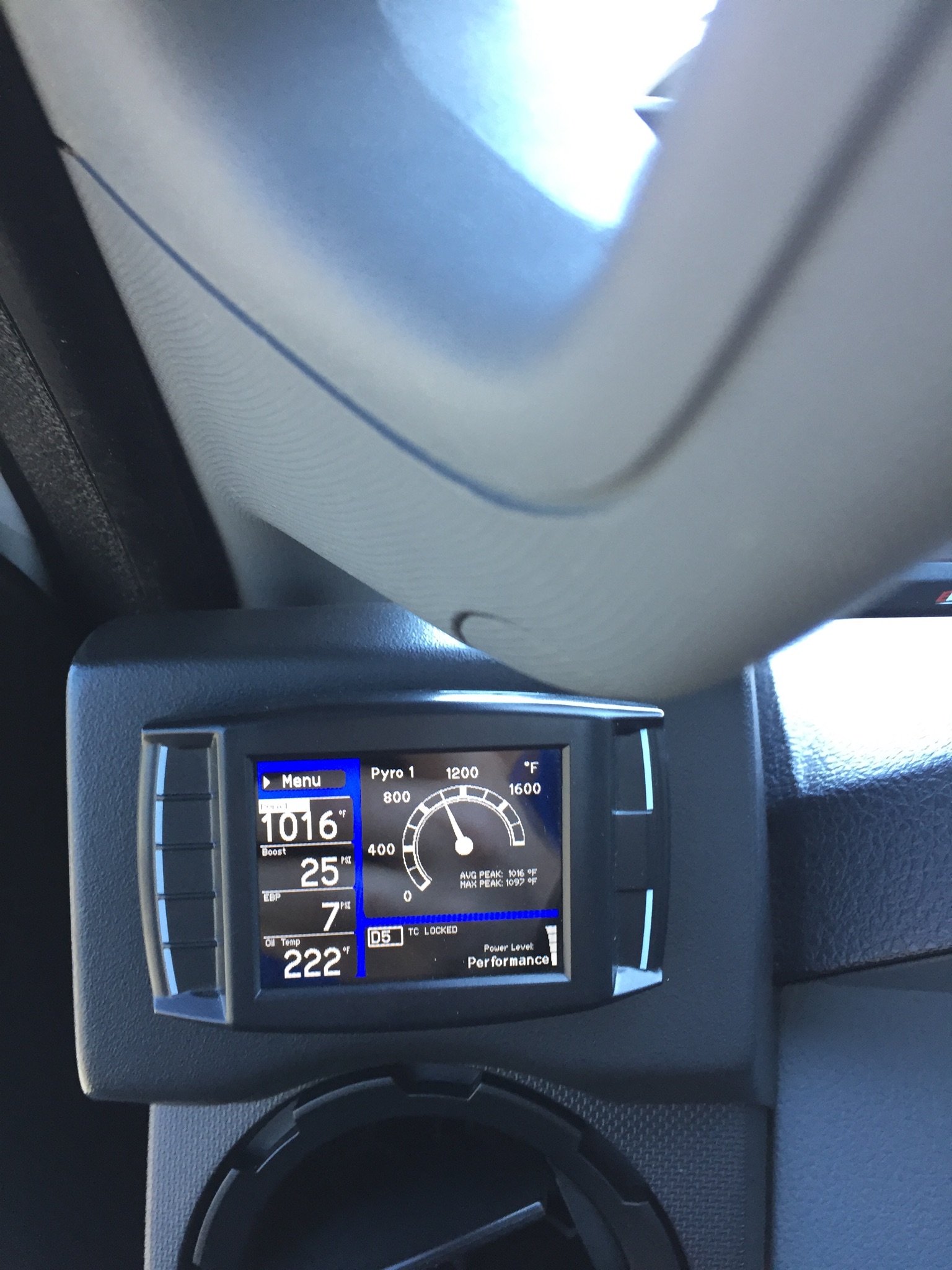

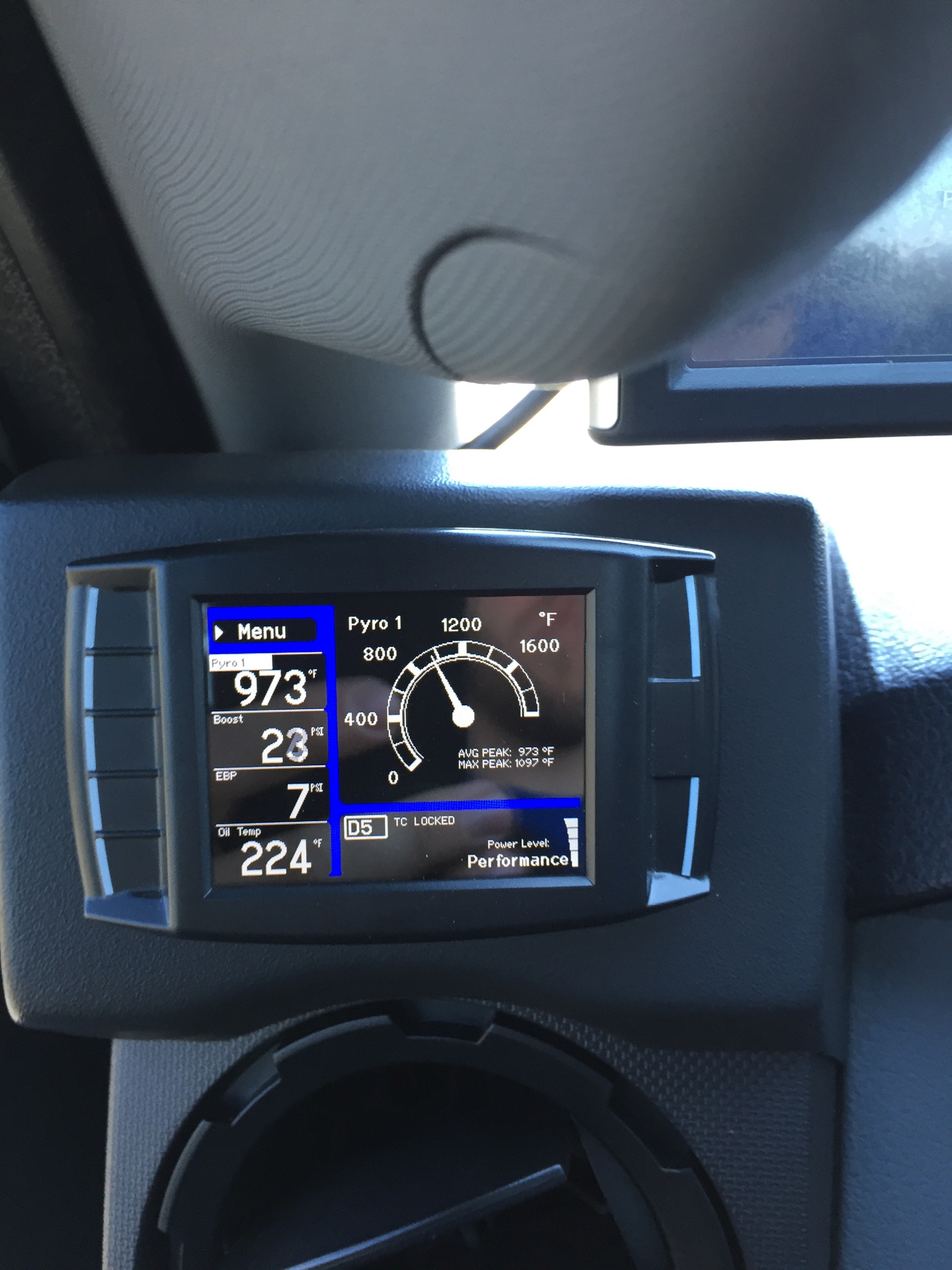

Here's a little example of what our 64mm turbo and dual fueler look like towing from over in my build thread.
http://powerstrokearmy.com/forums/showthread.php?t=64127&page=30

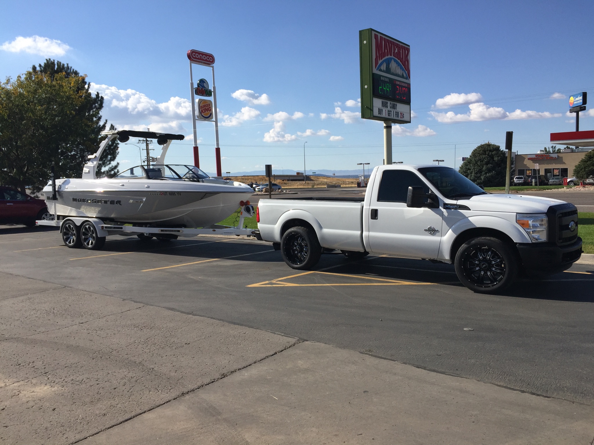

Did a little towing recently with the truck just to have a little bit of fun.
I towed a 25 foot Wakesetter weighing about 11,000 pounds from St. George to Salt Lake. There's one particular hill about 20 minutes out of St. George that we generally use to test product on. The hill is a long, steep grade between 5 and 7 percent and is about 10 miles start to finish.
Below are a couple of pictures we snapped of the PID's from that pull. Speed varied from 70-80 mph like it had nothing back there.
I was really impressed with the EGT's pulling that hill. We waited until we were about a mile from the top to snap the first picture and almost to the top to snap the second picture so you can see that the max EGT temp throughout that entire pull was (1097 degrees).
