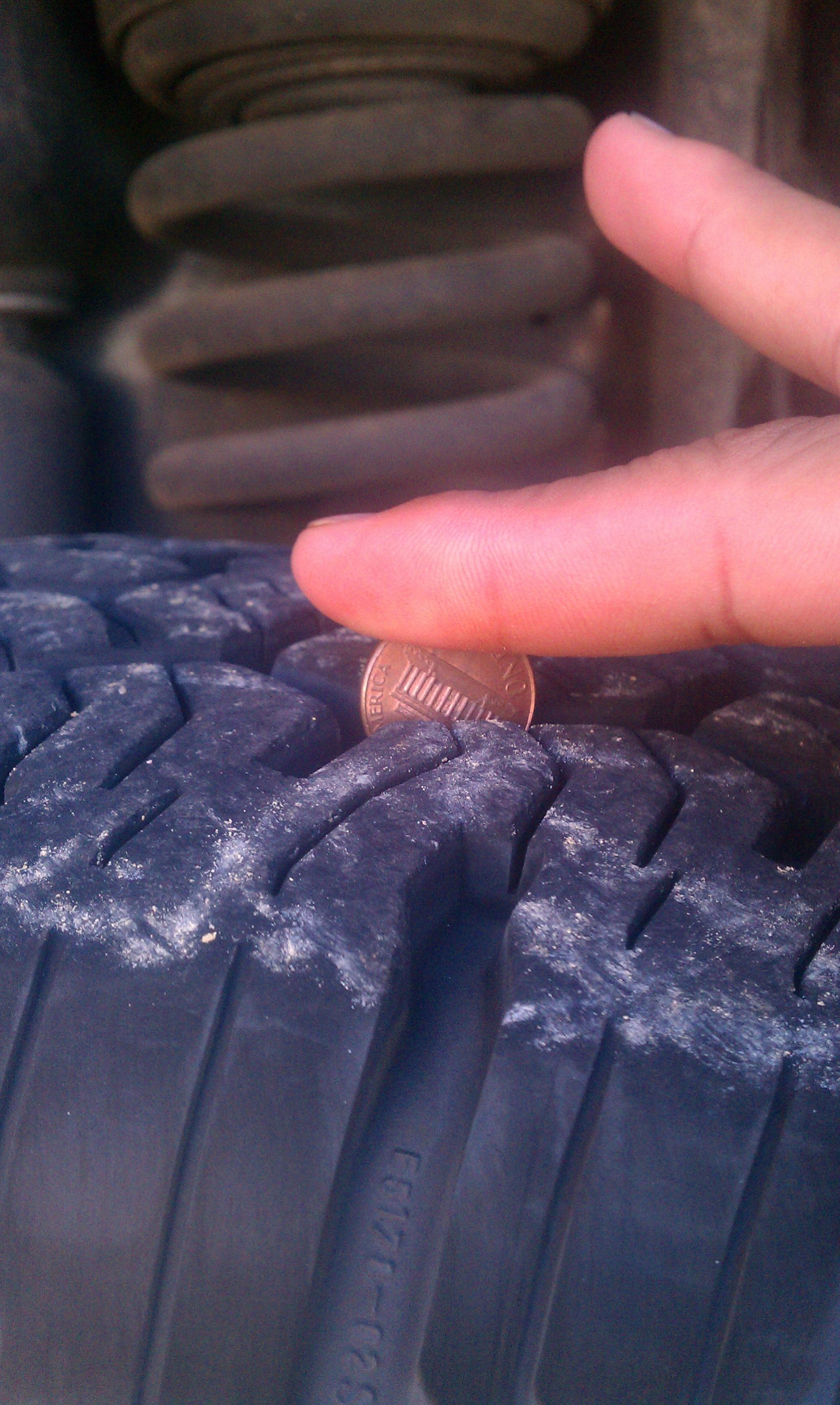

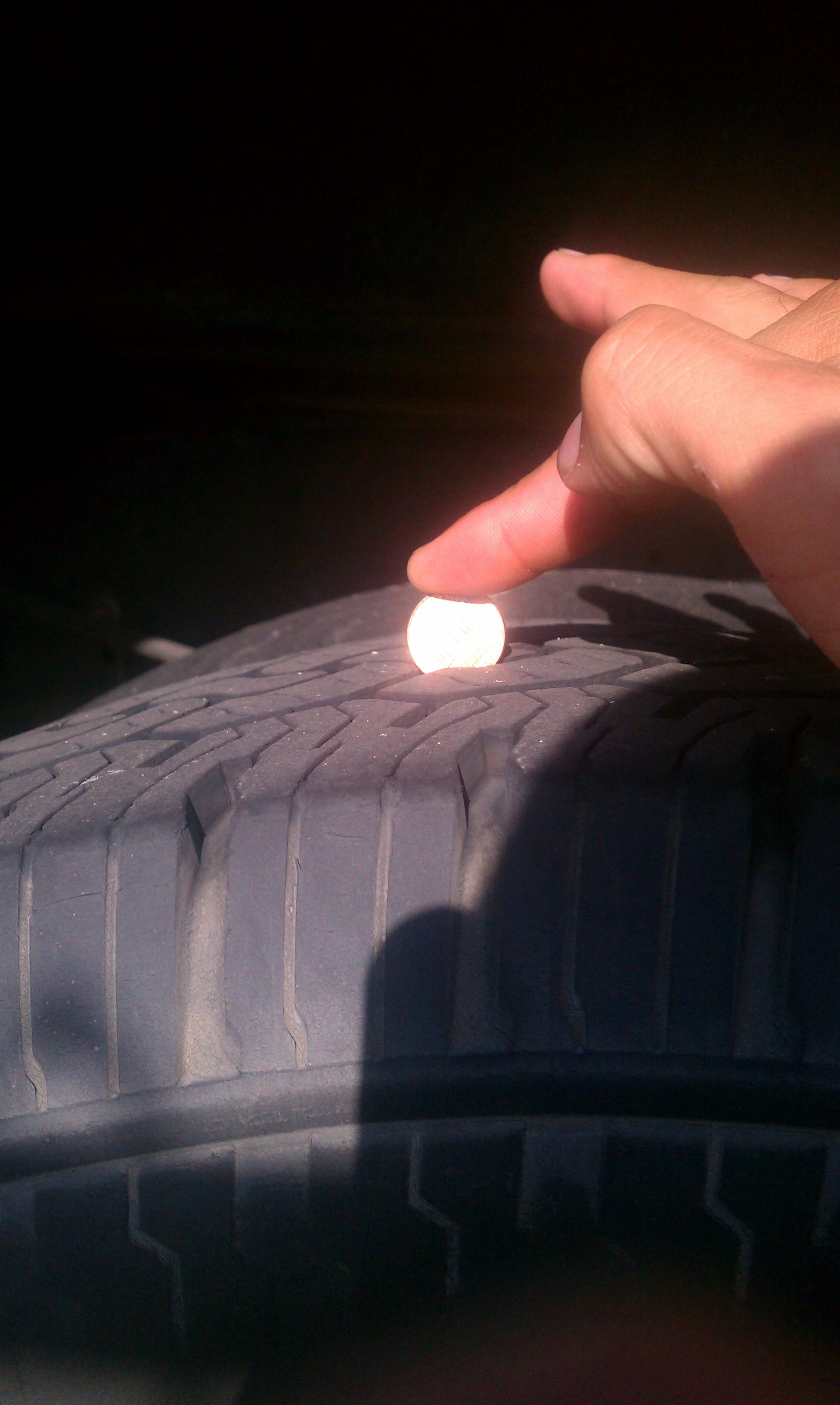

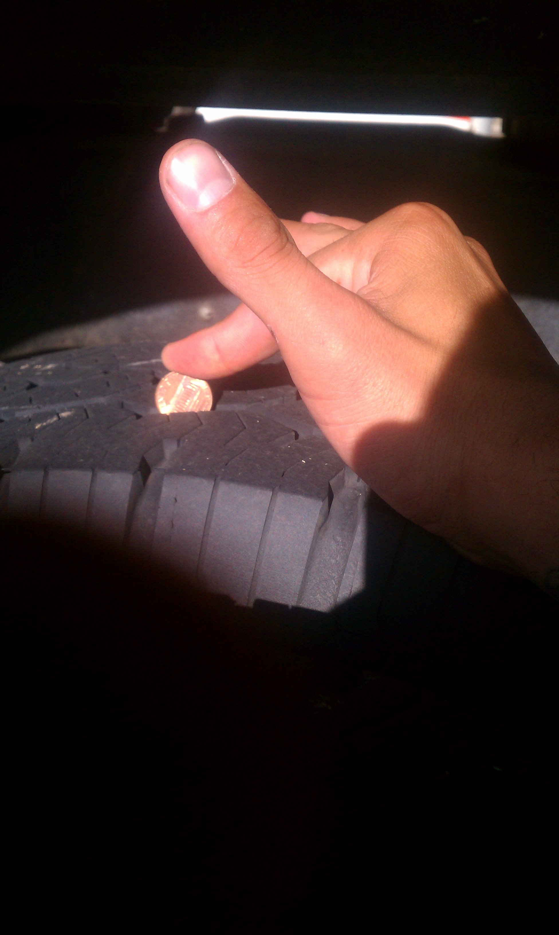

I'm in kind of a pickle with my tire situation. I'm considering selling the stock wheels and tires and running 19.5/22.5s due to the longevity. Basically I have a stock F-350 CC DRW truck and the dealership I bought it at replaced the front two tires but not the back 4. The front two are pretty much brand new and 3 of the back 4 are in good shape and have a really good amount of tread and one had a wheel weight get knocked off and is all FUBAR'd. See poll for my potential courses of action.
