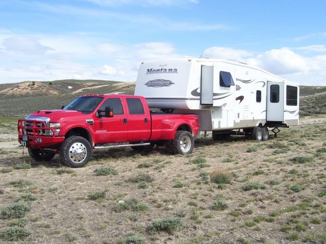

Were'nt you originally shooting for a 6" and 37s?? I'm a bit late to the party here but I would not go to a 19.5 or 22.5. My favorite dually I've seen to date is a 6" lifted truck on shaved 22's tho... $$$$$$$$$$$$$$$
