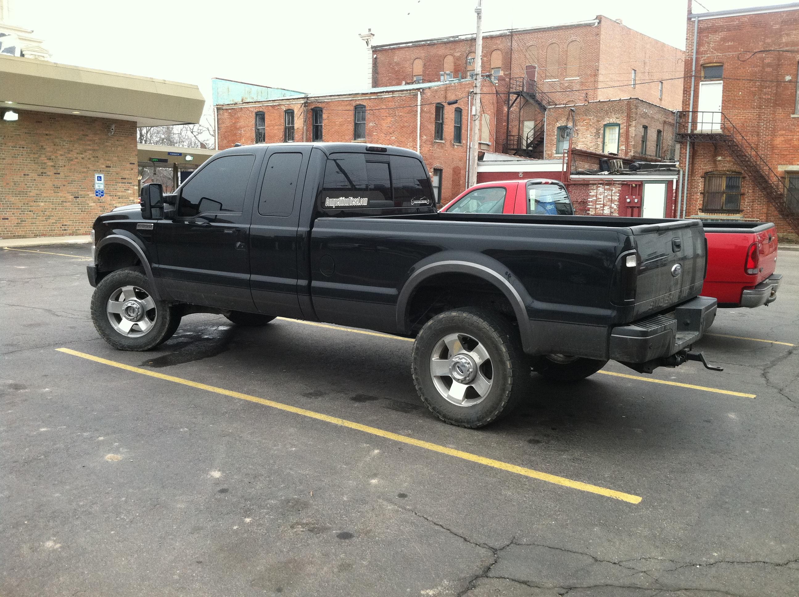

Another question, will 13.5 wide fit the stockers? If they do, would they rub?
They'll definitely rub.

I love the 295/60/20 Terra Grapplers that are on my truck. Perfect tire for stock wheels and stock height in my opinion.
BFG A/T, Mickey Thompson ATZs. Toyo M/Ts would be some options for you....Im running a 325/60 (35") Terra grappler on factory twentys for my winter setup with a leveling kit - 35s sre close but they do fill out the wheel wells great.
Inner fender liner is the only thing...
What's the size difference between the 295 and 325s? Do you think the 325s will rub without the leveling kit? Do you guys have any good pics of your terra grapplers?
And the radius arms...
A 295 is roughly 12.0-12.2" wide and a 325 is roughly 12.75-13.00" wide. When I had 325/60/20's on my truck with factory wheels, they rubbed the radius arms. Once I went to BMF's, the backspacing kept them off the radius arms.
Mine dont....and I run the 325..

I honestly don't see how yours don't rub. I had 325's on 3 different sets of factory wheels (18's, 20" HD's, and 20" Lariat) and always had tire rub on the radius arms.
Your truck is one of a kind in many ways I guessoke:
Ill take some pictures and post them - Ill make sure to zoom in on my non scuffed radius arms.
I've seen a few other trucks with the same issue.
