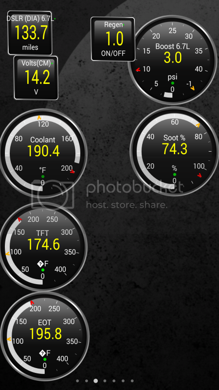

Yours seems a little different than mine. This is at 40mph in town (regen).
lincolnlocker
27,913
177
Central Michigan
holy chit! yours is way more even. but after I took that pic the last 2 sensors started climbing to around 1k° also... so I dont know if it was just warmijg up or not. I know the 2nd egt sensor hit 1220 then started to fall.. thats when I took the pic...

are those min and max arrows on the dial?
live life full throttle
Yes. Yellow is min, red is max. Only problem with them is if they are not on the screen, it does not record it. Those are two different screens, so if I'm not looking at the egt screen, it won't record the highest value. I really should add an egt sensor to the other screen that I watch the most.

Central Michigan
there ya go!
