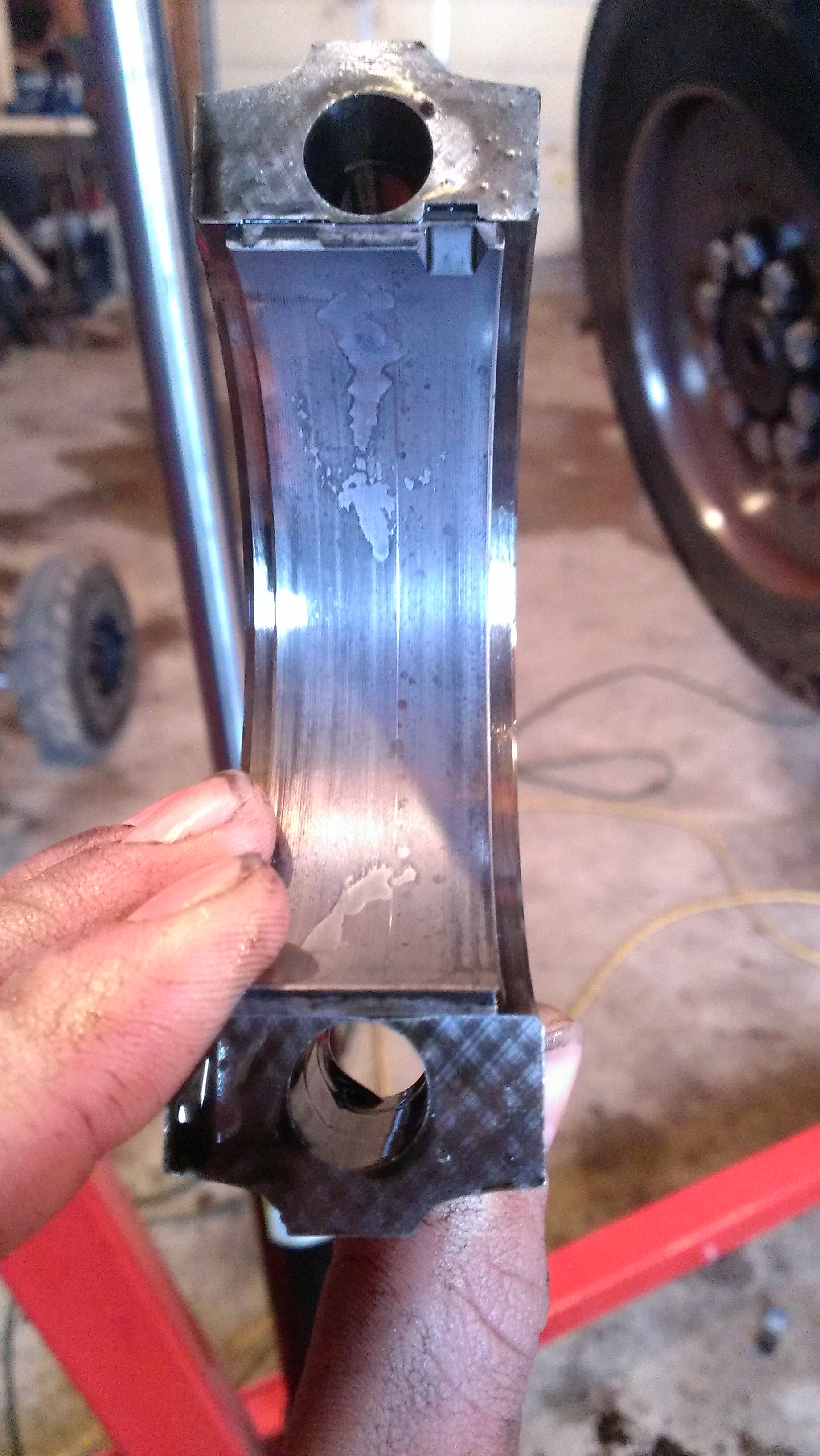

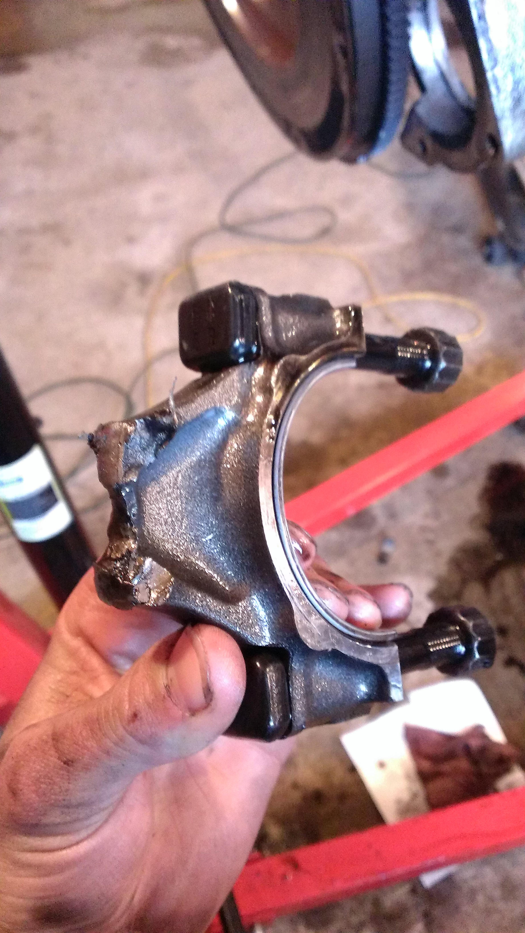

Not at all. It's the 68 and the 200 nozzle matched up in a cylinder. Boost comes on early, lots of fuel, rpm and cfm, too much pressure on rods
IMO that is not what happened on this motor.
the broken rod is not a compressive failure (would be bent)
it is a tension failure. piston went up but didnt come back down with the rest of the rod.
if it was too much cylinder pressure it would have been driven down in to the carnage

Piston that went had Vavle slap and the valves pushed it howerever far down they go and that's where we found it so yes I'm guessing the rod pulled away

I'm thinking it was stress cracked before hand and it broke on the compression stroke, piston kept traveling upwards and contacted valves

Just my humble opinion...Metal fatigue is what broke his motor...I think he has a real well balanced and thought out setup, put together and tuned by good folks....stuff just breaks when you make power. It just sucks when it's your truck :) Billet rods/girdle/coated pistons blah blah...just move the weak point to your trans...or elsewhere in the system.
Build it back stronger than before!

more carnage. chunks out of cylinder 4 is the one that let loose
