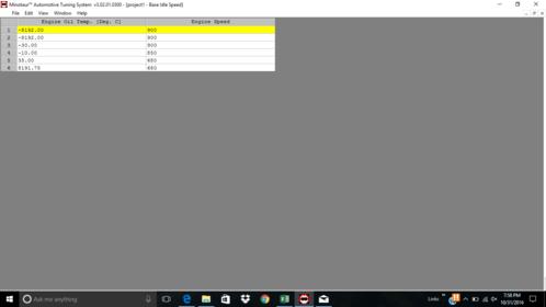

Been following this for a while even though I don't tune or even have custom tunes for that matter. On my late 99 with stock injectors, chip off my cold start idle is say 600rpm until high idle kicks in but there is zero haze at startup. Running any tune my cold start rpm is near 1000 and I always get a little cloud/ haze for the first say 5 seconds of run time. What rpm is everyone else seeing on initial start up?
Here is the base ide speed control for your stock file.
This is decided by Oil Temp in C*
There are a few other things that decide idle speed also.
One is a multiplier that will build RPM by time at idle and can be used as an automatic high idle that kicks back down when you touch the break.
Let me know if there is anything else you want to see.View attachment 45413
Thanks for sharing. I kinda missed my target on the post, I was kinda digging back to a year ago when the discussion was about cold starts. Since we are at that time of year again (have already had a few days below freezing) I noticed the return of my cold start smoke. I'm aware there are many parameters that would determine the idle speed. I guess the question I'm trying to ask is why is the target rpm set higher for cold starts than factory settings? I recall reading some of the other guys speaking about how their trucks started better cold with less smoke with no chip, even with larger than stock injectors, but smoked/ hazed with tuning.
Tuning on or off the high idle still functions, it just doesn't change as much tuning on because it's already at 900-1000 rpm.

Idle speed control is just a part of the puzzle. Unless it was a custom tune I do not know why a tuner would adjust the idle speed parameter unless it was a whisper mode tune or high idle. As for haze and cold start timing may have a part in it. Most tuning has different timing profiles over a factory calibration.
Sometimes to get the idle perfectly smooth, a change of +/- 20 RPM makes a monumental difference. Obviously a couple hundred isn't ideal.
