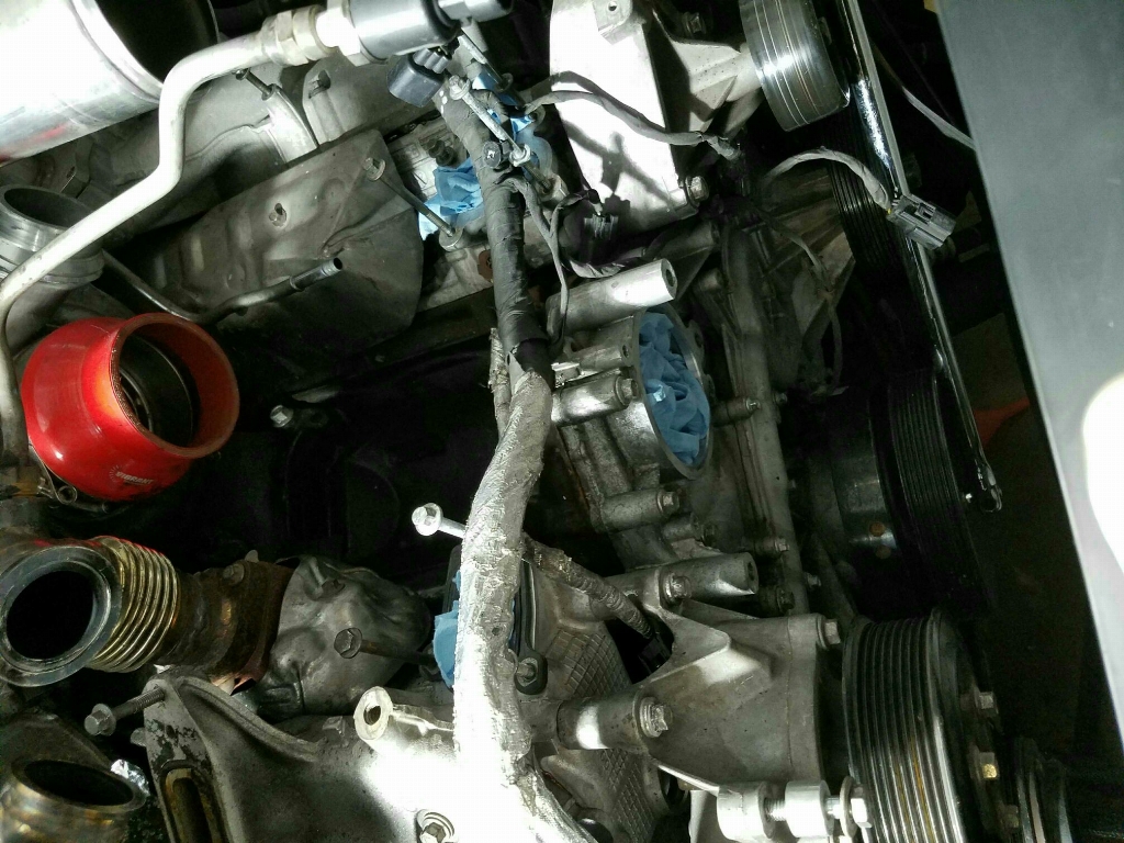

Pretty straight forward as I had hoped, just fan clutch, idler, vacuum pump. The gear even comes off easy which I was elated that I didn't have to try and make a puller that would fit in that tight space.

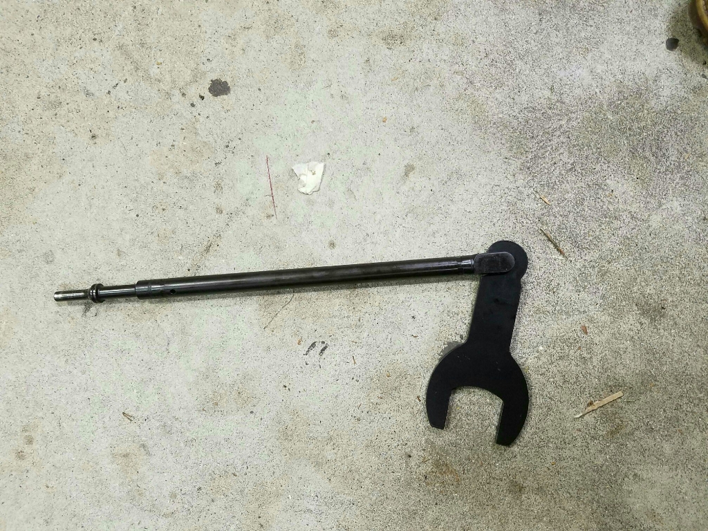

Picked up this nifty adaptor for the air hammer
Which worked out very nice since I didn't have the serpentine on to help me hold the idler in place.

Where did you buy that tool?
Those are a life saver, matco has them as well in a kit with about 10 different sizes. They work wonders on hydraulic lines that have been tightened a bit to much too lol
