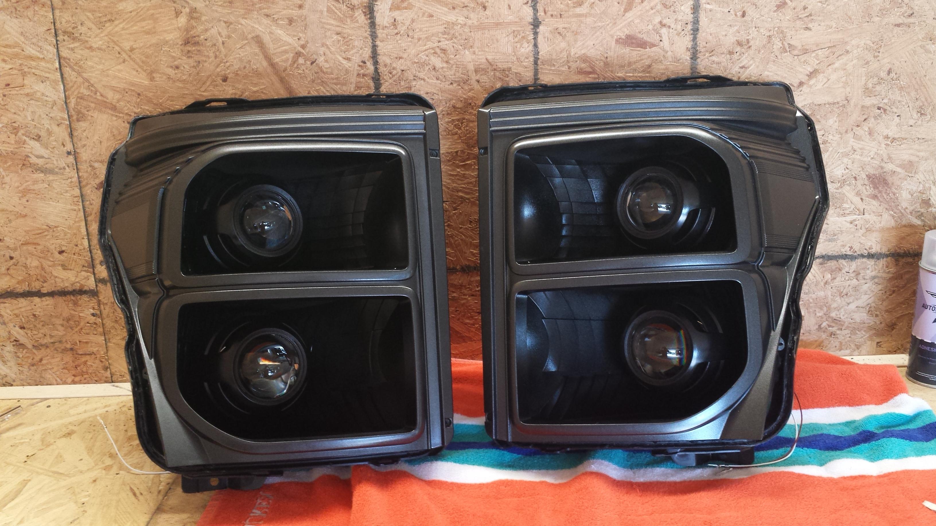

jwalk09
Aug 8, 2014
461
VA
VERY CLEAN MAN! WHAT ARE THE SPECS? AND WHERE DID U GET UR SUPPLIES. ALSO WHERE DID U GET THE SUPPLIES TO COLOR MATCH THE PAINT?
D2s projectors with Apollo shrouds
Dummy projectors up top
35w 4500k hids
Ordered all hid/projector stuff through Jeremy at retroshop.com. He can build you a set or hook you up with everything to diy. Great guy
Ordered all painting supplies through http://www.automotivetouchup.com/ . you can get oem paint in aerosol cans
Adhesion promoter, primer, bases, clear
I used paint code J7 and UH

Was it really hard to mount the projectors?
jwalk09
Aug 8, 2014
461
VA
Not bad. To mount the projectors I had to dremel out the bulb socket and shorten it. The dummy projectors mounted with screws and nuts through the back of the housing.
