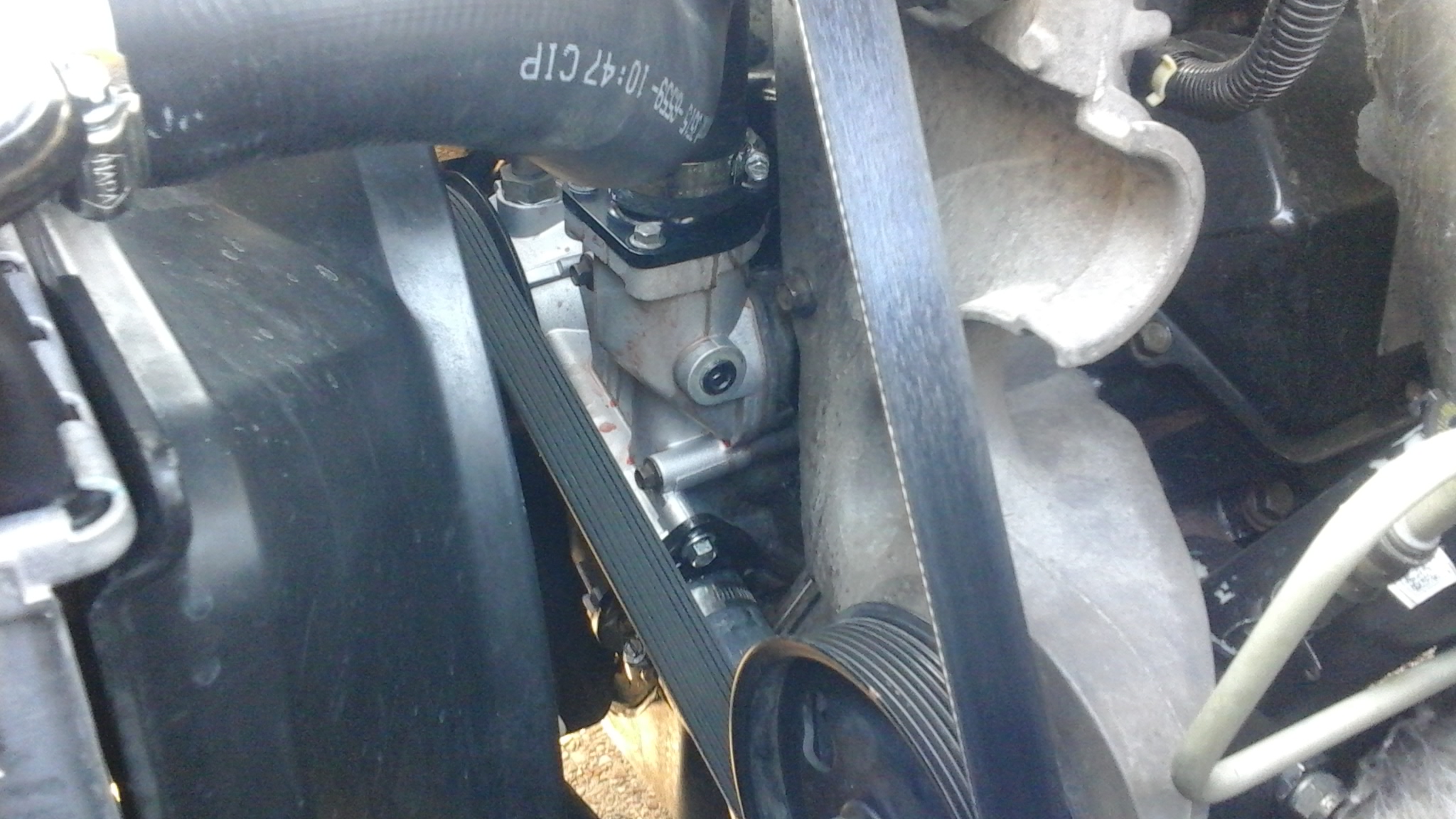

You can see its leaking worse now.

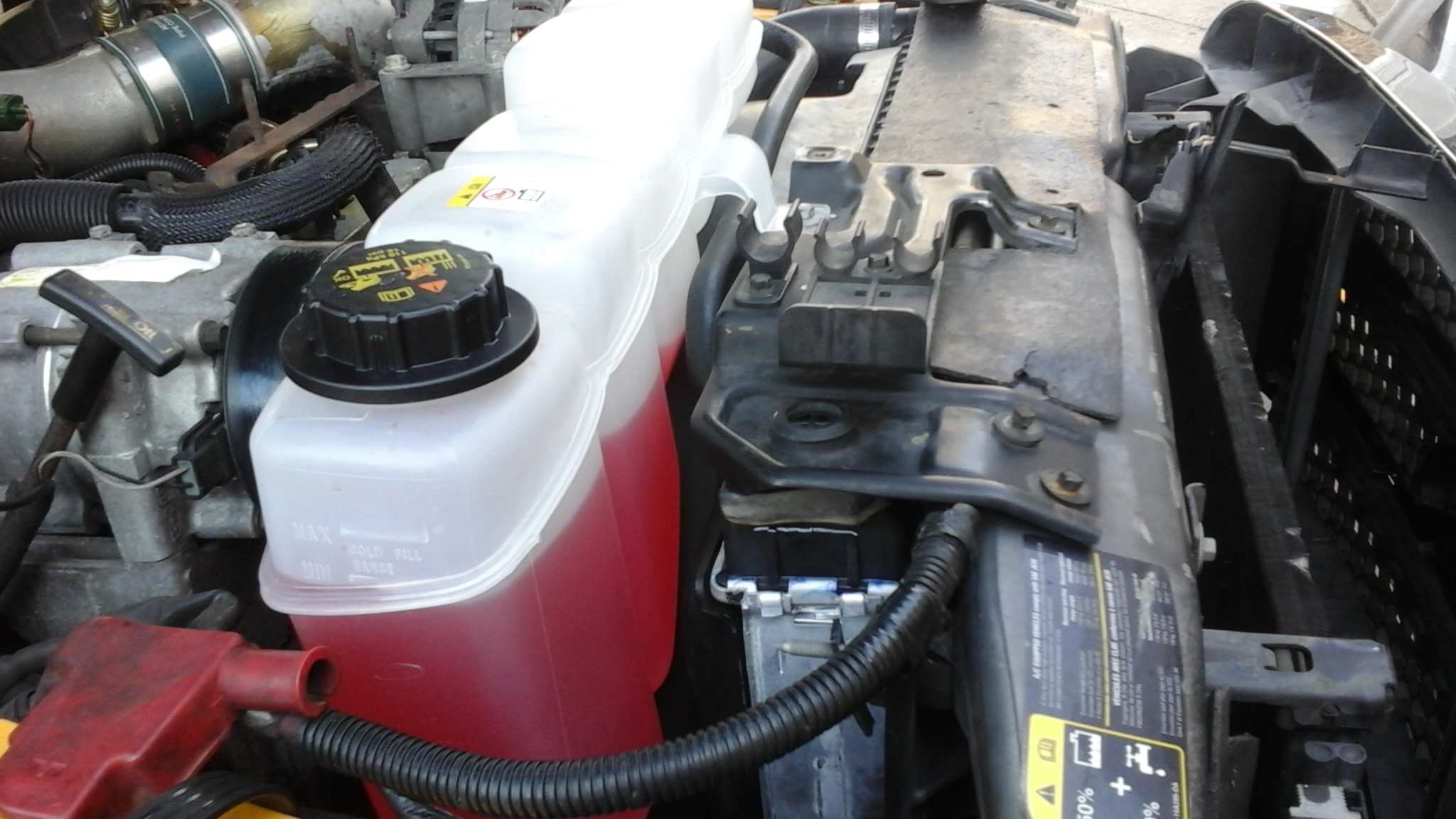

New radiator and I also put a new degas bottle and cap running elc coolant also.

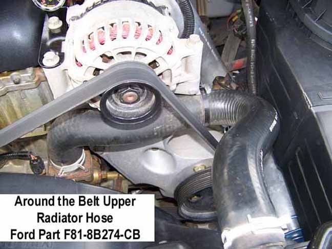

Maybe the bolts are to tight? I think they only call for like 8-10 lb/ft
You know they make a hose that routes around the hose right?

I don't have a torque wrench but they are almost stripped out from being so tight. I don't believe they need to be this tight. Yes I do now I should have ordered the other. I'm no mechanic at all I had to watch some videos to figure out how to change this stuff. I can get this leak fixed I will be happy, but I won't lie and I can admit I don't know what I'm doing. I do know I can't afford a mechanic so I'm learning as I go plus everyone here has been super helpful.
A buddy asked me if I could put a ring of gasket sealer on it is that something that can be done? I just hate draining 2 gallons of coolant for the 4th time to take the housing off. I hope I only have to do that one more time.

remove the water neck, see if the oring is ruined. if it isnt then reinstall slowly and carefully.
sealant is a dumb idea. it is an oring it needs no sealant if you install it properly

Since you have to drain the coolant, go pick up yourself an upper rad hose from a dual alternator truck. The SD trucks that have a single alternator, the upper rad hose through the serpentine belt. If you ever have to replace the belt, you'll have to drain the coolant.

Thanks but i just payed 30 dollars for the hose I have on and my belt is brand new so I hope I don't have to change it anytime soon. I replaced all the hoses that hose from the bottom of the degas bottle was 30 dollars also they sure aren't giving them away lol.

Honestly I hate to say because I'm gonna look dumb as hell. I did say I was no mechanic though. When I pulled off the original water pump I didn't take off the Thermostat housing because I had all new stuff going on new pump. Well long story short I put it in wrong, I thought the gasket went in first, I hadn't seen one changed but I wondered if it was correct so I watched a video and sure enough I did it wrong. Gonna pull it apart and change it around and hopefully I didn't wreck the gasket or housing from wrenching on it like a monkey.
