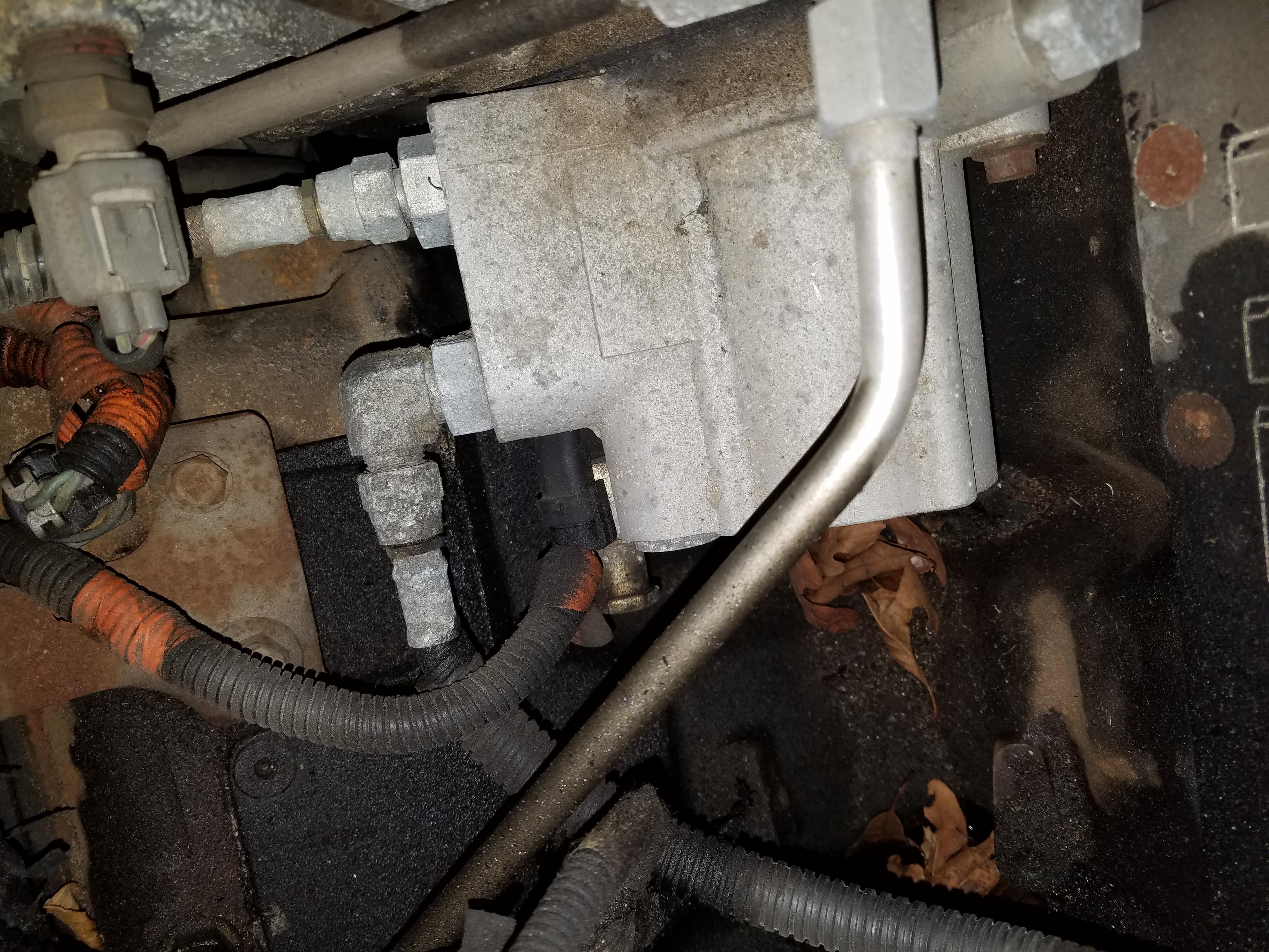

Well not so good news on this truck, I drove it for 20 minutes, came back let it idle for 15 minutes and it started acting like maybe injector issues, not sure but then I looked on the bottom side of the motor and she leaks like a siv.. I'm not looking to dump a pile of money on fixing anything, I don't mind fixing stuff but I just don't have time to mess with it.

Looks like the backside of the motor, It's really hard to tell, my problem is, it was cleaned before I looked at it and that don't go with me.

Could it be the hpo line o-rings?
I don't really know much about the 7.3, The 6.0 forces you learn so I know that one pretty well but the times of fixing trucks is pretty much over for me so I think my best option would be to up my budget and buy something newer, I may wait to see if I'm going to stay here in Maine or not, if I decide to stay here I will likely buy a one or two year old truck and let Ford fix it if something is wrong.

Gotcha, the hpo lines that connect to the hpop. When the o rings go it sends oil through the valley, down the back of the motor normally diagnosed as the rear main leaking. The car lot I bought mine from had the rear main replaced and was gonna have it done again after I test drove it since it was still leaking. Told the mechanic at the shop they used it was the hpo lines and he said "the what?". Anyways could be an easy fix just have to take a light and look at the back side of the hpop and where they connect to the heads, while the motor is running you should see oil if that's what it is. Good luck whichever way you go.

that might work out.. if it is really leaving a puddle uner it then I would lean towards hpo lines.. easy fix honestly. just a couple o rings or new lines all together but they are pricey if you go that route. 60-80 bucks each i want to say but an o ring kit is like 10 bucks.. if it is just a drip or a seep then it is probably the ebpv leaking around the rod.. could be the hpo rial plugs on back of heads but that isn't extremely common.. it happens but not a lot.. turbo pedestal orings could also be bad. hpo plugs on top of heads could have a bad o ring, icp sensor oring could be bad, hpop seal could be bad.. only one that would realy suck are the plugs on back side of heads. turbo pedestal o rings are a lil time consuming but its prolly an hour job if never done it before and the v bands pop lose easy. hpop seal is a bit of a task but isn't the end of the world.. id hose it off with brake cleaner and drive it to see just where it was coming from. if they don't know better then can say it is the rear main and have him knock a grand off the price but in reality, they rarely ever leak...

Okay, thanks for all the info, It is going in Friday morning to get checked out, I'll let you guy's know what the story is. I figure for $50 that he said he would charge me to check it out is money well spent.

You can probably get steel braided lines made for cheaper rather than buying from Ford.

If your not familiar with 7.3s,I'd say for a 50, it's worth having it checked over. These are fairly simple machines, generally.
Umm, 40-50 for a Parker setup, tops. If you deal with parker, ask your guy about 90 series hose and fittings. Maybe it was 91 series, been a couple years, lol. It's 450* rated, 2500 psi operating pressure, ss braided line. With a 5x burst pressure, it'll be fine.
You'll need the fittings for the heads and pump to swap over to the jic style fittings, as well. #6 orb x#6 jic at the pump, and #5 orb x #6 jic at the heads.
If it's easier, I believe riff raff sells the lines, which come with the jic connections.

You are correct, that was the issue. I decided to buy the truck and have the Ford garage fix it along with a couple of other things including front brakes, brake lines, oil change, fuel filter change, trans flush and coolant flush and what goes along with it. I offered $7000, he said no so I told him my offer stands until I find something else, he called me two days later and took the 7K.
