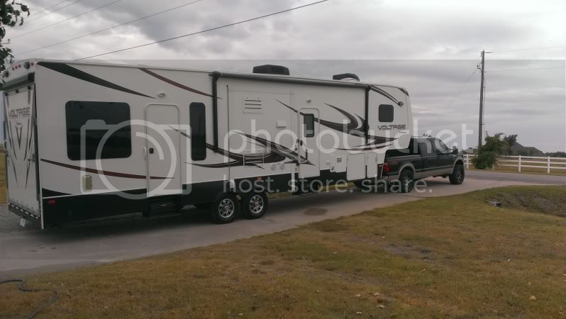

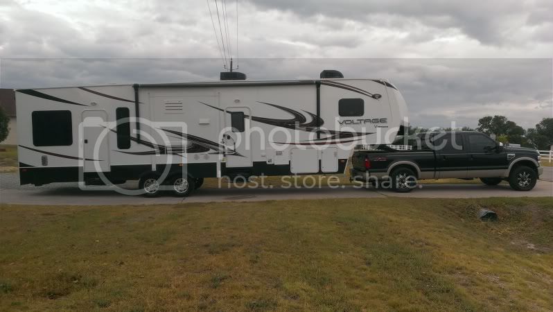

Just picked up a toy hauler last week..
I am thinking about adding timbrens but, do you think an f350 block would help ? This is the most pin weight the trailer will have because my SxS is not loaded up.

Helper bags imo

Timbrens are a good low maintenence alternative. I like mine work well with my camper but not nearly as big as that one

I think since the camper is down hill from the truck in this pic that it is pulling the tuck down further than it would on flat ground. It does have a 2600 lb pin weight with no toy in the back though.

Airbags. Check the tounge weight and and make sure the tires and rear axle are rated for that. It looks heavy.

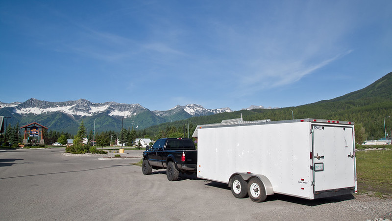

Used this to haul our mountain bikes and gear for our 2 week trip through the West Coast. Whistler, Fernie, Sun Peaks, etc. Trailer was around the 4900-5000lb mark, depending on how much beer we had with us. Trailer brake module on the trailer decided to give up 3 hours into the trip, so I had to do the rest of the trip (up and down 9% grades) with no trailer brakes. Luckily the ZF6 and wind resistance slowed it down nicely without more than the odd tap of the brakes. The only time I REALLY wished they worked was when having to deal with Vancouver traffic... that being said I wouldn't do it again. Also broke a trailer leaf spring 2 hours from home after driving 4,000k, that sucked, but could have been worse.

I vote air bags, w/compressor. I like being able to fine tune my ride height when towing my camper, weight changes trip to trip, like bringing the quad, water weight, etc..
Also something to think about would be the rear of your trailer being so low to the ground. Bringing the rear of your truck up will pivot the rear of the trailer down even more then it is. Not to mention the weight of your SxS.

The driveway has a pretty good incline upward towards the truck that makes it look a lot worse than it actually is. The picture doesn't really show it but, it is there.
