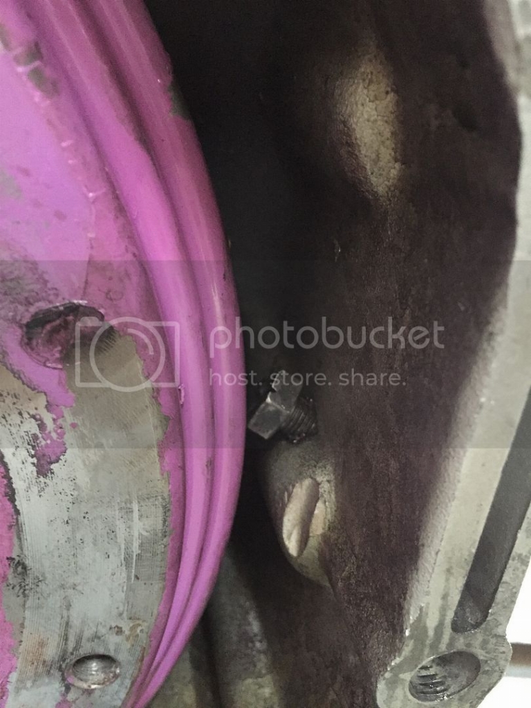

Pulling the trans to get recased. And hopefully find where the mystery bolt that caused the damage came from. All the flex plate bolts appear to be there.

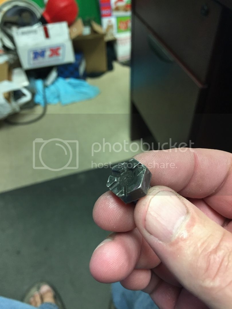

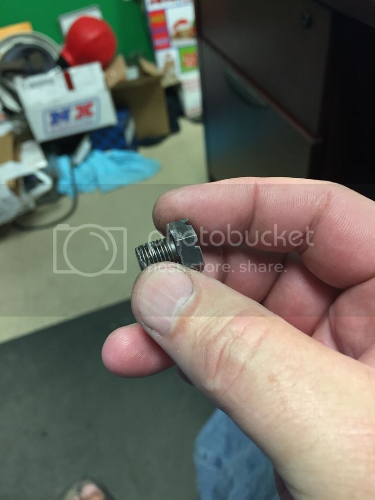

Found the trans culprit. Looks like an old stock flexplate bolt. No idea where it came from as I have aftermarket zinc coated ones and they were all there. Only thing we can think of is it must've bounced in behind the converter or something. Which is still weird because I never heard any odd noises or anything out of it. Only reason I even knew it was there was I saw the cracks when I pulled the cab a while back.

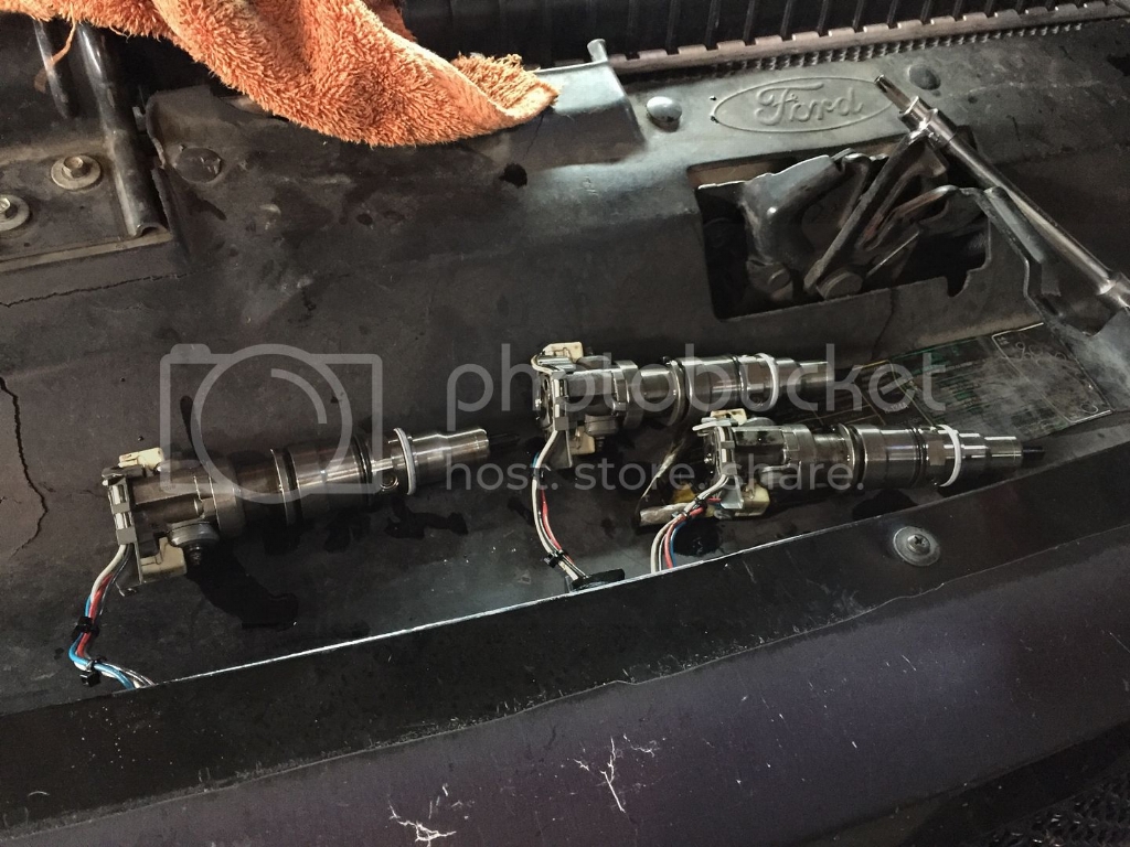

Also pulled my injectors and sent them to Warren Diesel to be upgraded a little. :D

wtf? how dafuq does that happen?
whats a "lil" upgrade?

Only thing we can think of is it must've bounced in there at some point during assembly or something.
And going from 285/150 hybrids to 330/150 hybrids. They should actually be arriving at Warren's today.
that's messed up.. lol
nice!!!
