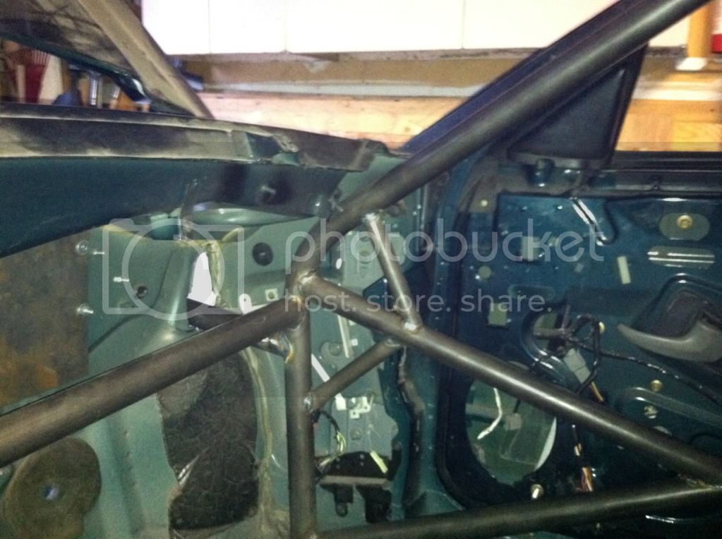

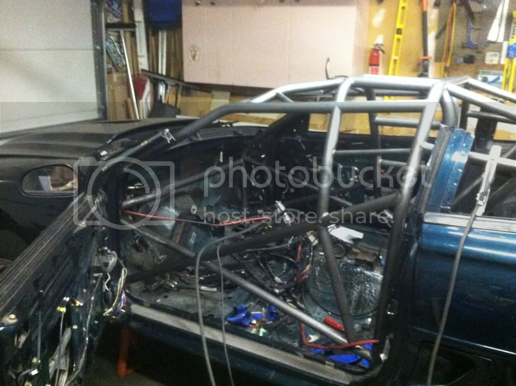

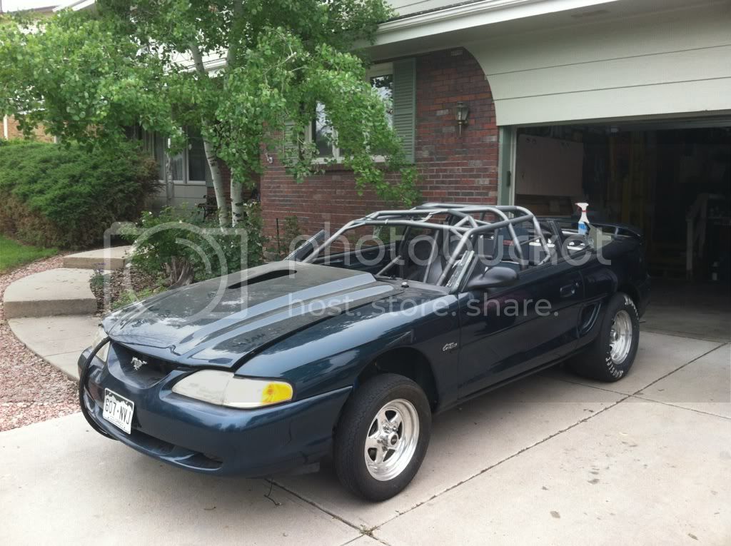

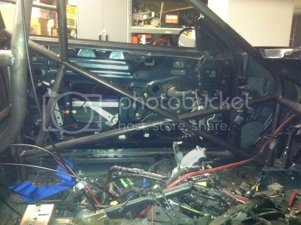

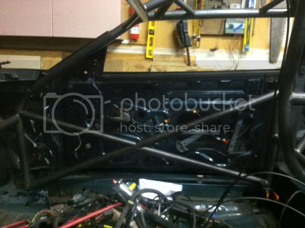

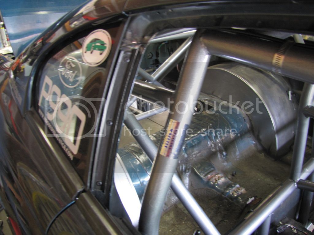

Got everything basically all welded...
Started the x door bars and passenger door bar. Got the passenger side tacked together, and the drivers side all welded in. Almost done EVERYthing I can til I get the roof back on!
Taking donations for shocks and springs now :D
Got another window net kit too. I will beable to use the spring loaded part to the bottom of the net and have a totally removeable window net in a matter of 2 seconds. Spring loaded top and bottom! Need to beable to remove it quickly so I can still street drive the thing and not have to mess with nuts and bolts.

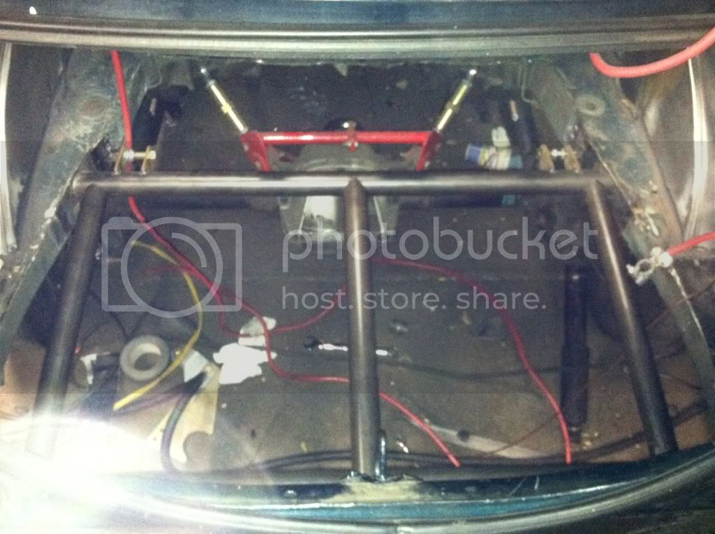

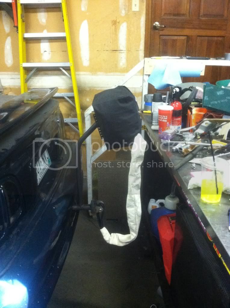

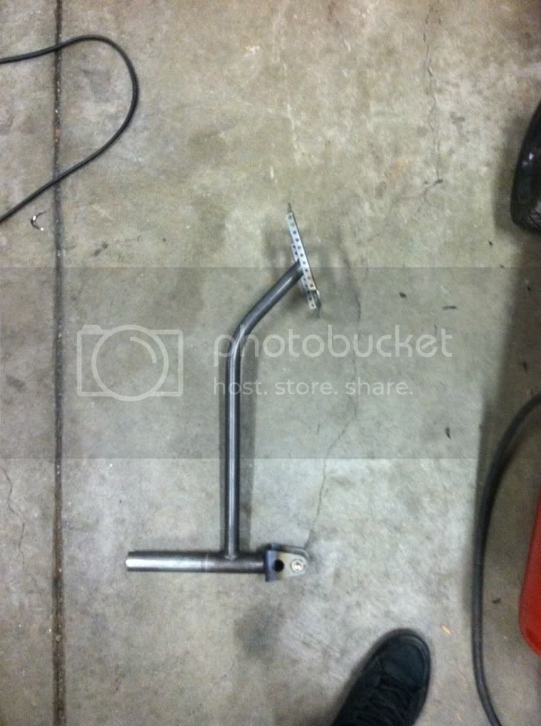

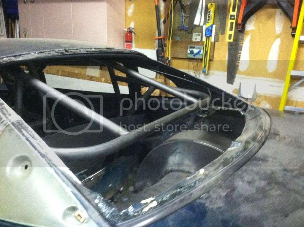

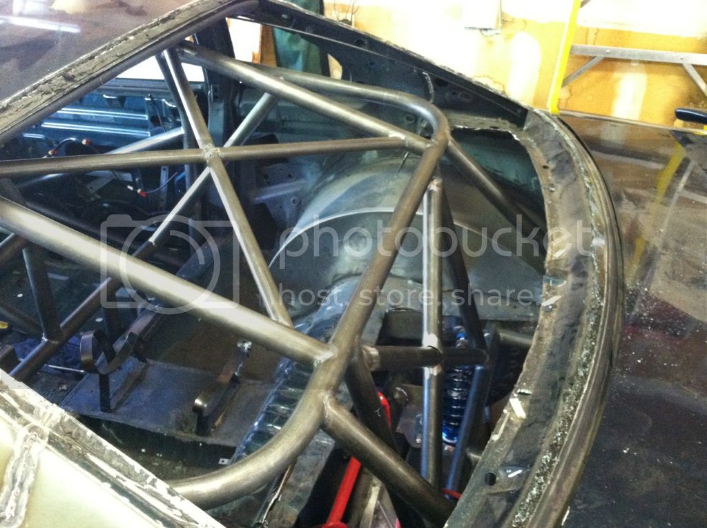

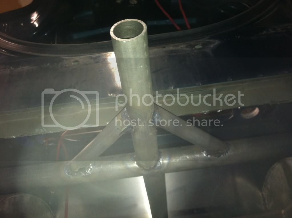

Finished the removable parachute mount and rear floor structure.
Cable Holder

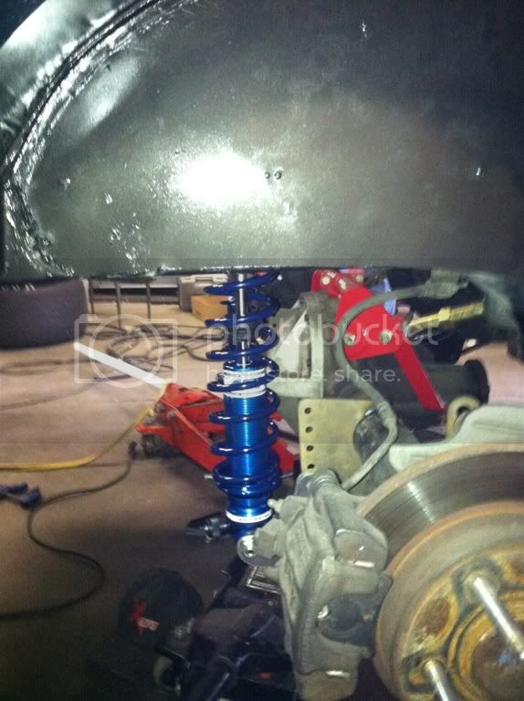

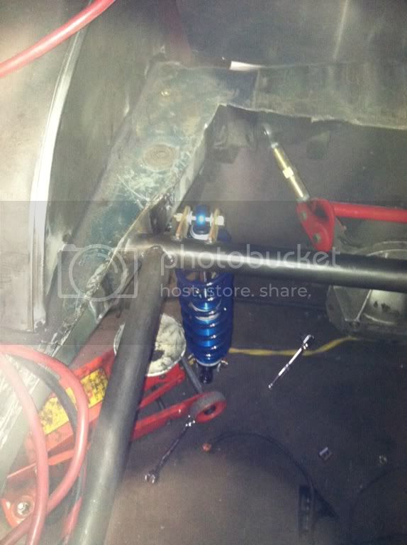

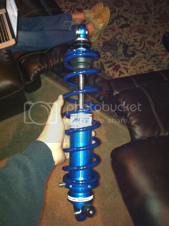

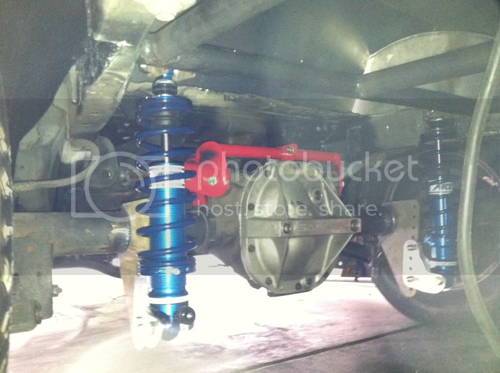

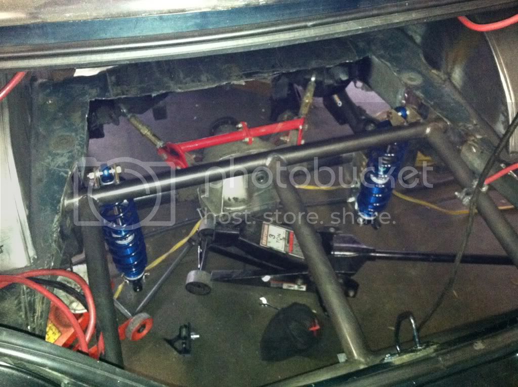

and actually Shocks and springs showed up today. I got the lower coil over brackets welded on and made sure they fit. Tomorrow they will go on for good and then the car is going back on the ground.
Then the roof will start going on finally. Itll look like a real car again!
(I have 800 bucks in the shocks and springs, and I have a fox body mustang I paid 100 bucks for complete minus a motor and tranny)

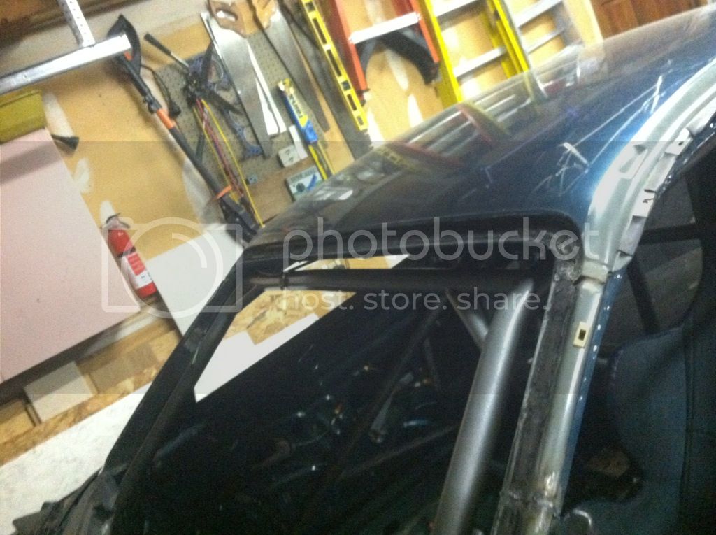

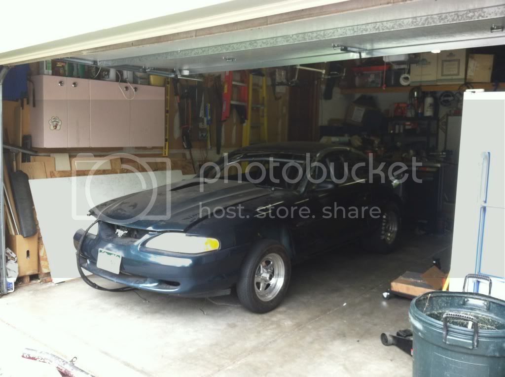

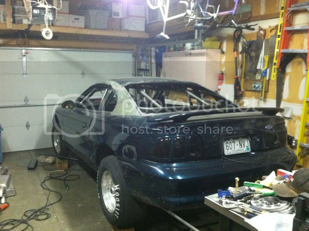

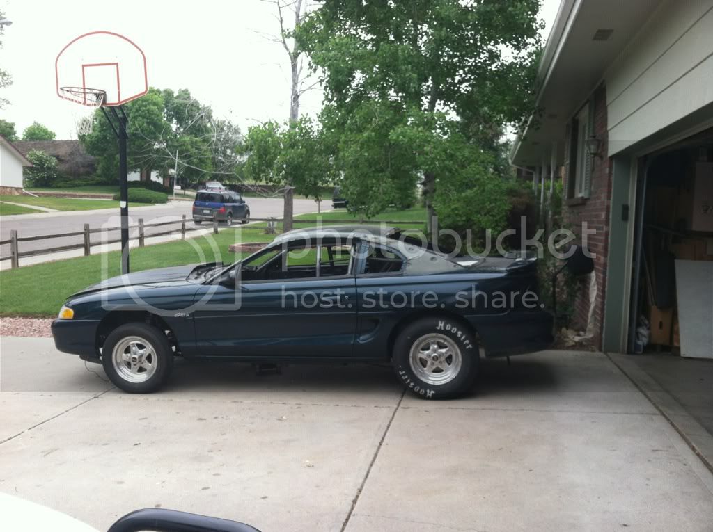

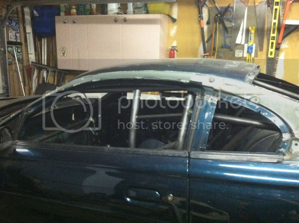

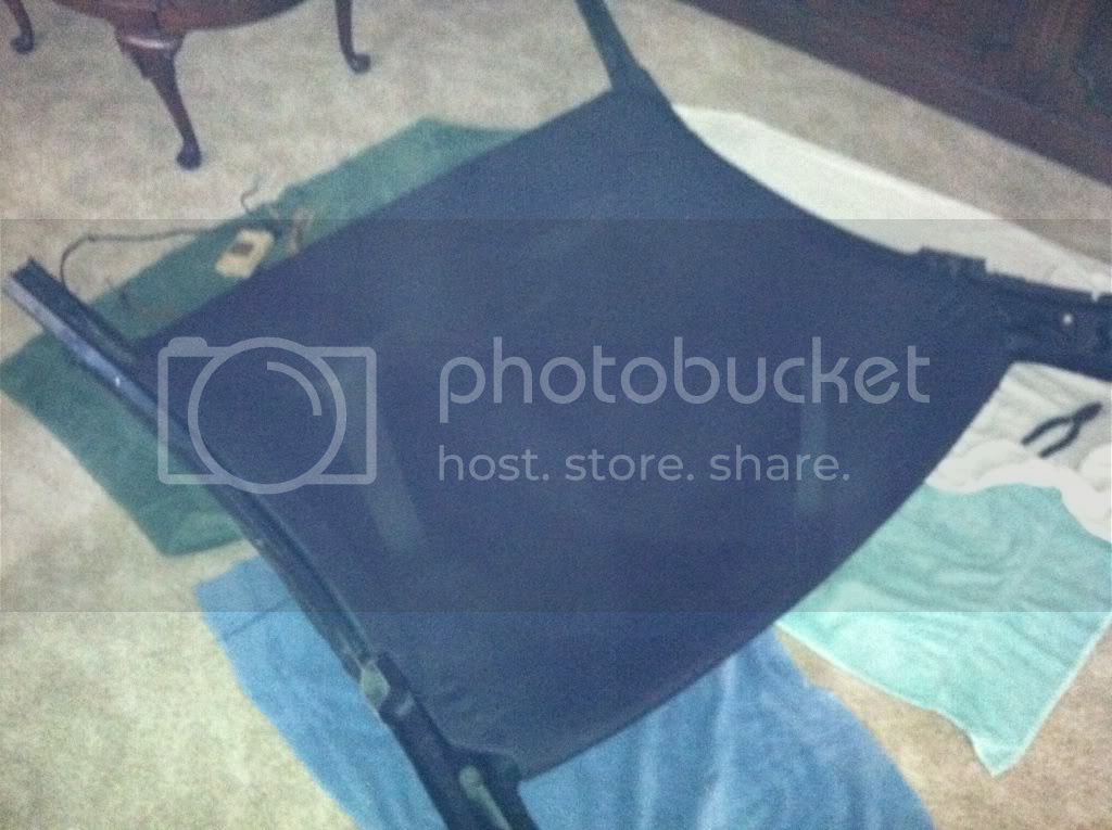

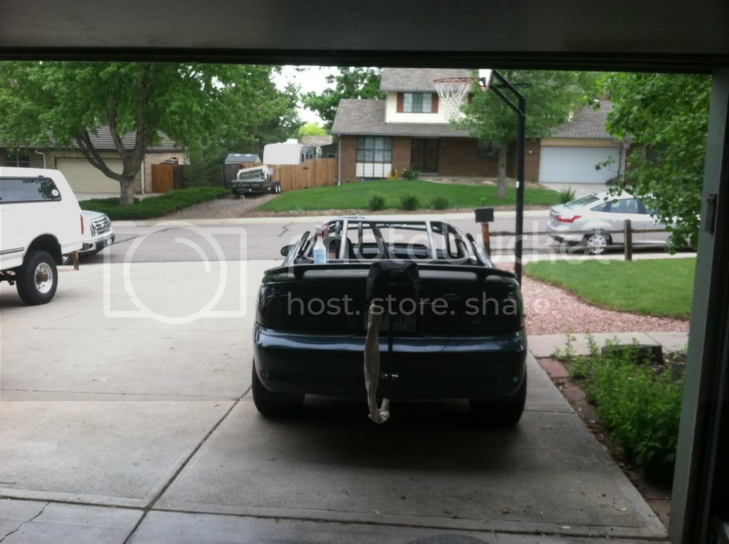

Got the car back on the ground. roof goes on this afternoon.
using moms living room for the install of the headliner.
The doors open and close now too without issues, cant wait to get the roof on and then finish the rest the car up!
lincolnlocker
27,912
171
Central Michigan

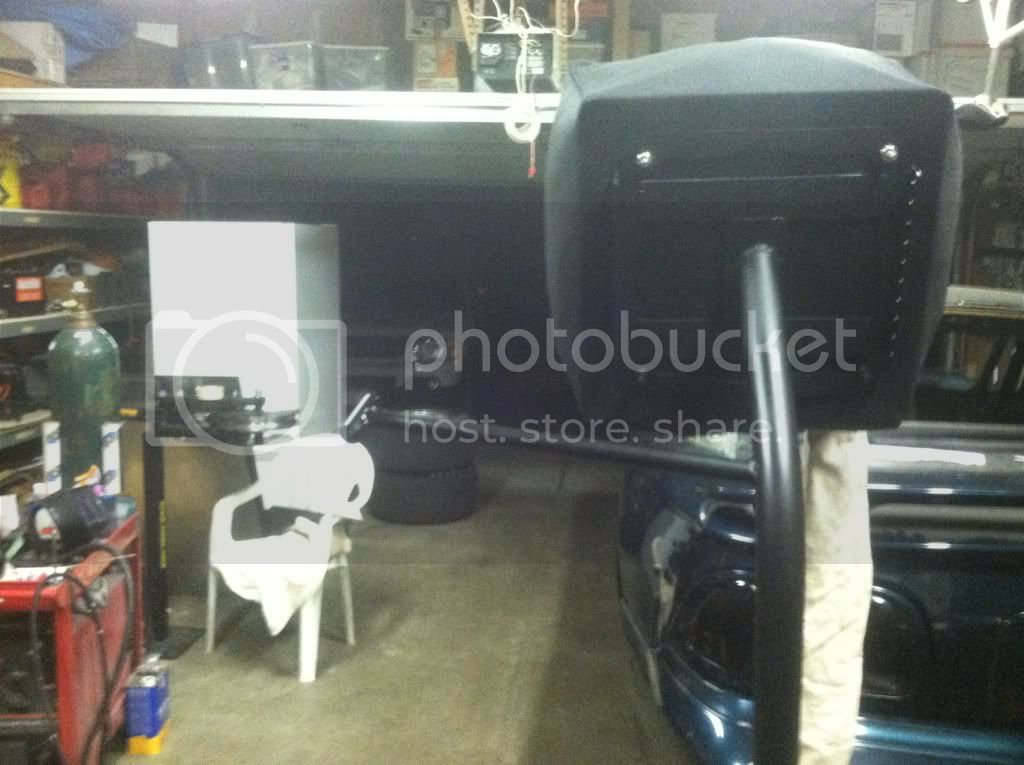

look's great, but you might want to reinforce the vertical rod on the shoot... add a gusset or another bracket to the trunk... that's going to be a ton of pull on that pipe. you will either rip it off or horseshoe it... if it doesn't do it the first time you open it i'll be surprised...
MustangMatt96GT
Feb 25, 2012
101
Denver CO
The only pull that the pack mount bar gets is wind resistance, the tether is attached to the bottom piece which is what matters on forces.
Also if the car starts going 160+ I'll have to put a wing on the car and it'll direct the air above the pack mount.
Thanks for the compliments guys!
lincolnlocker
27,912
171
Central Michigan
oh ***!! i'm a retard!! don't mind me.... didn't see it attached there!! looks ***in awesome man!!

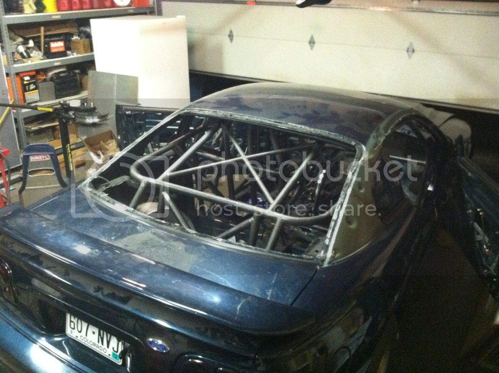

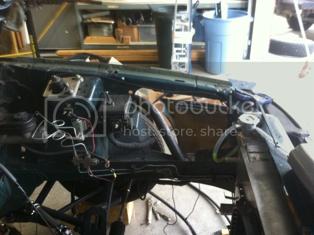

Well I ended up working at my grandmas landscaping most the day...

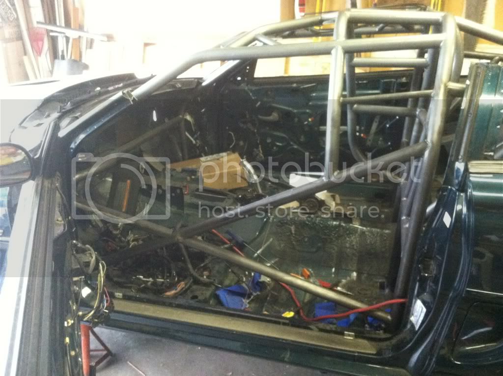

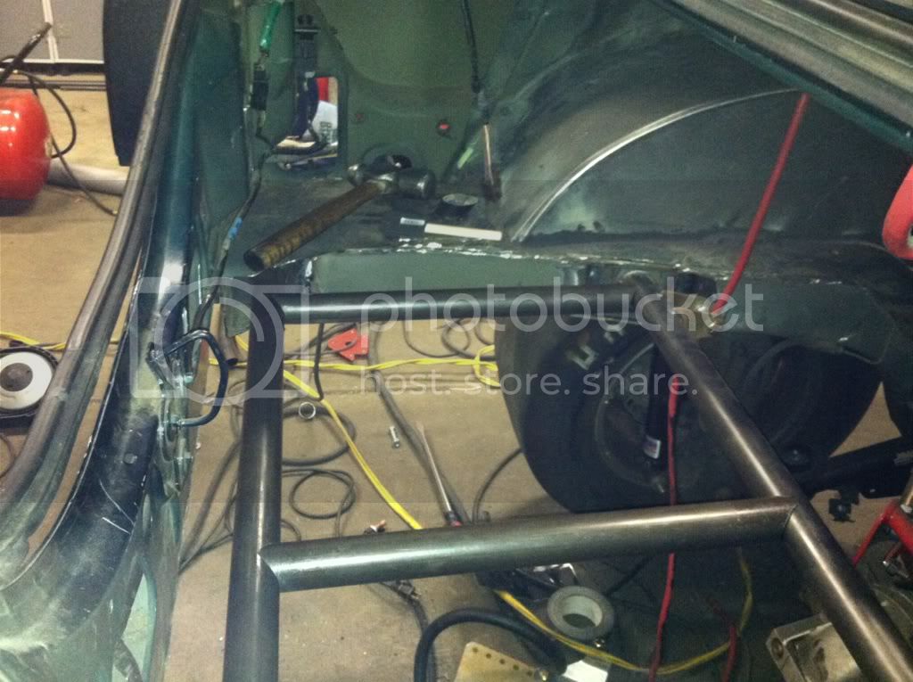

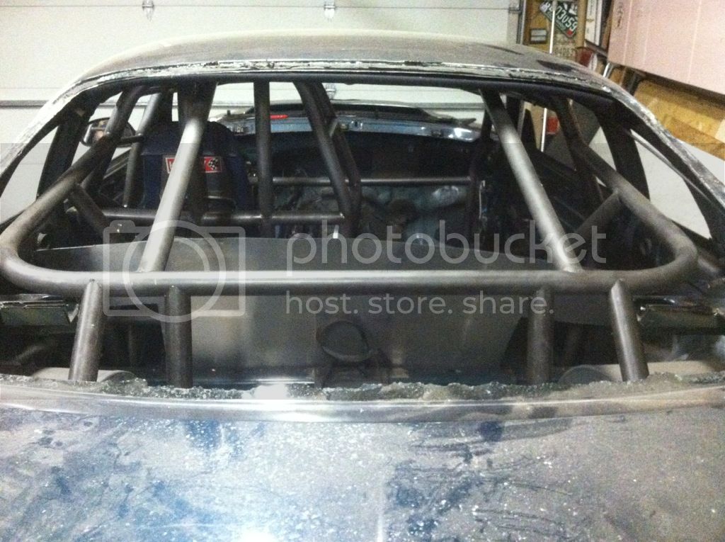

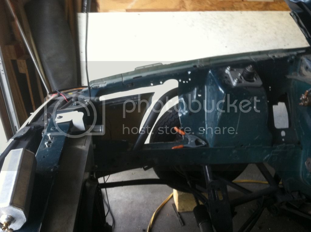

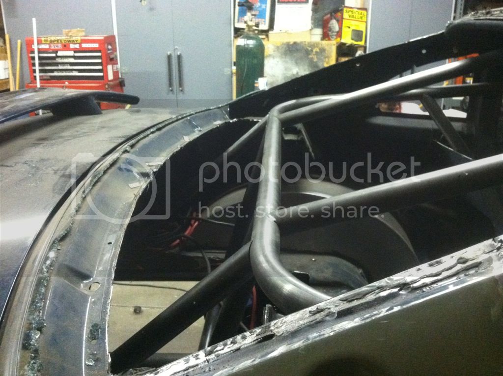

But I did get the cage tied to the car in the back of the structure today. Ill do the front strut bars tomorrow after work mostlikey.
Had to cut more out of the car...
Not too much more and I can get a chassis cert done on it.

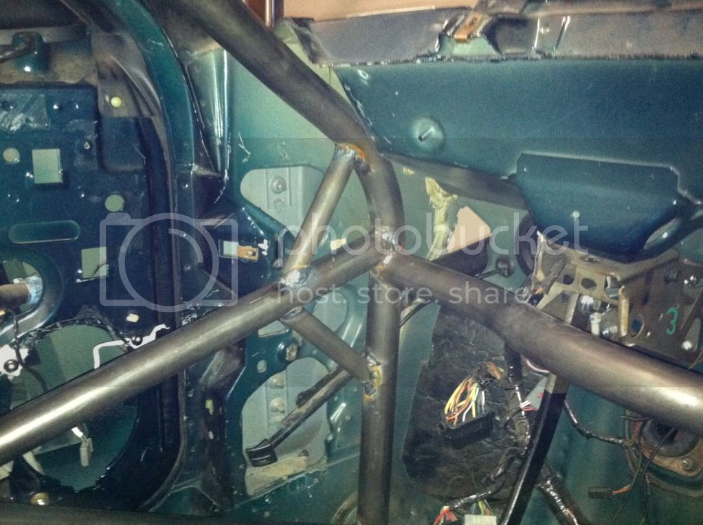

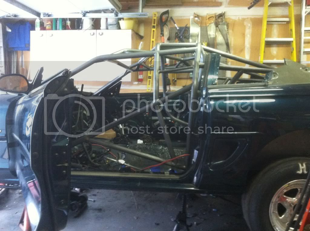

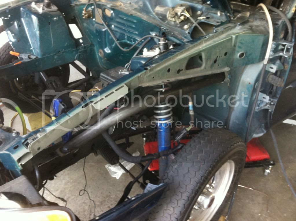

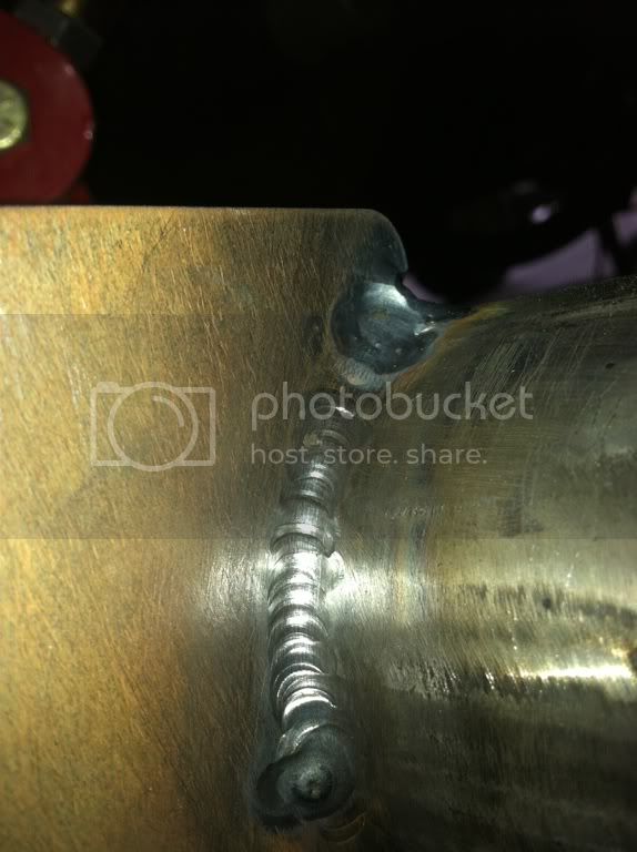

Got all the bars done. I have a few pieces to finish welding, and then paint goes on... I think I will make it!
And here are the harder bars to weld...
Im really happy how the front subframe bars came out. Car is really really stiff. It is no longer a death trap.
Here are finished pictures of the back end too.
I have a chassis certification on Thursday afternoon. Gotta finish it up completely.

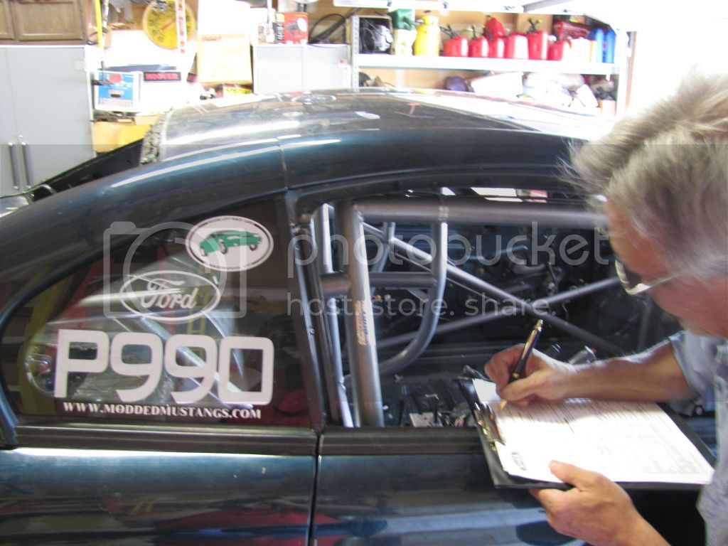

Got my first SFI certification today!
Inspector said he really thought it looked nice and was well built.
It looks like the car and he didn't even realize that the roof had been off.
Now to save up for the engine combo to stick in it!
