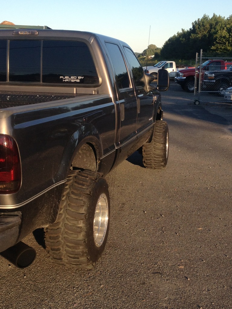

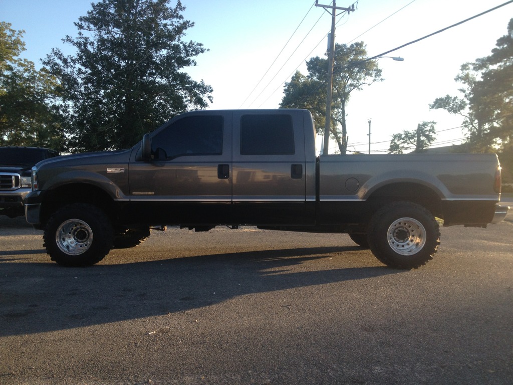

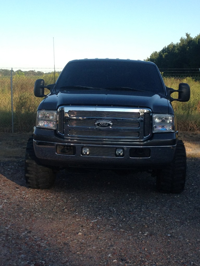

Let a buddy of mine borrow the all terrains to pull on this weekend so he brought me his extra set of tires to ride on for a little. ImageUploadedByTapatalk1347497526.513888.jpgImageUploadedByTapatalk1347497659.255864.jpgImageUploadedByTapatalk1347497701.279225.jpg
33x14.00 on 16.5x14 weld stone crushers

lol Would ole buddy sale those wheels n tires maybe??
I juust ordered 20x12" Nutz rims an 35x13.5 fuel offroad tires.. But Id like too have those too pull with maybe..
Ohh yea, Pics too come with the Fuel setup :D

Nah he is def not gonna sell them. Your new set up should look good. I saw the exact wheel and tire you ordered when the MHT rep stopped by our shop a few weeks ago.

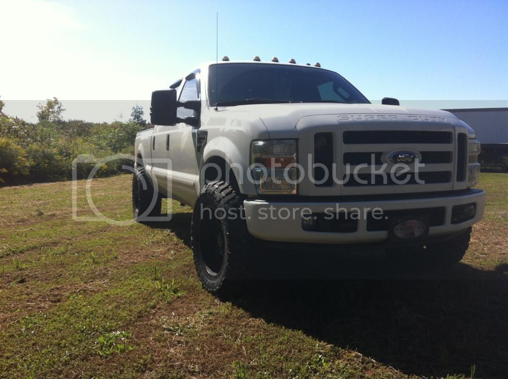

18x9 Method Street wheels, 5.75" backspace/+18mm offset
35x12.50 General Grabber tires
Icon 2.5" leveling kit, 3.5" block height
Barely rubs the lower rear section of the driver side fender liner at full left lock, and that's it

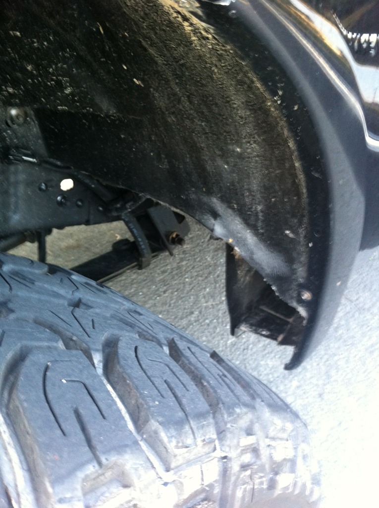

20x10 BMF S.O.T.A.'s, 35/12.50/20 Toyo Open Country MT's, stock height. It rubbed before I zip tied the fender liner back. No rubbing at all now.
