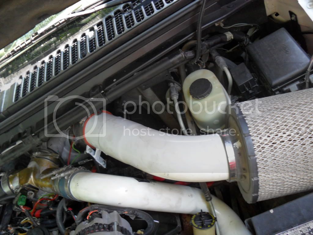

napa, wix dealers, or fleetfilter.com
:whs:
The part number is 6637 for the filter, hence 6637 filter. They will most likely not have it in stock unless you live in a bigger town. Call up your local NAPA and tell them what you need along with a 4" 45* exhaust elbow.
It shouldn't cost you more than a $100 to do.
This is what it will look like with a 38r. Stock will look slighty different connecting to the turbo. I'll see if I can't pull up a pic with the stock turbo.

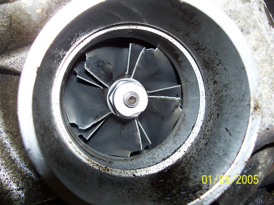

K&Ns flow better but at the cost of filtration. dirt is the #1 enemy of these engines.
