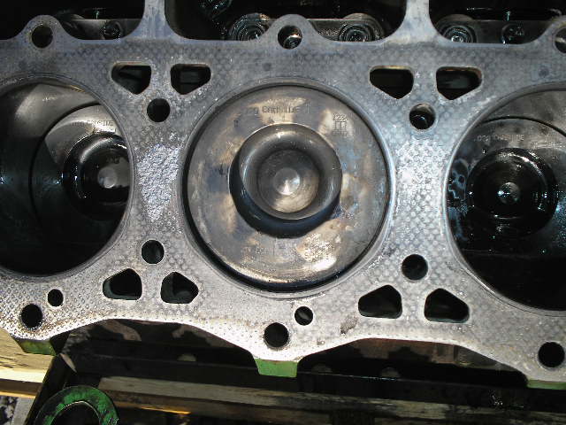

I use mine for mainly towing and a little daily driving. I was running dp when the engine hatched. Had 180/100's at the time with 96000 original miles on it
CurtisF
2,347
Well I'd say it's tuning.
Your pistons perty much prove it. They have some nice cracks on the top. The star pattern in the bowl is actually half in and half out of the bowl. That is advanced inj timing. Even if your bottom end didn't crack those pistons would of let go sooner then later. Those cracks coming from the bowl will just grow to the outside till they hit the ring land .
The spray pattern should be in the bowl not up.on the lip like yours. That's from the piston still coming up the bore while the fuel is being sprayed early.
That one piston has 4 cracks that I can see and 1 of them is almost half way across to the edge. .
Pics don't lie, you asked why, this is why.
It did last a good while tho!
The cracks in the pistons and the crack in the block aren't related.
It wasn't the tuning that caused the crack in the block.

You don't think pre-ignition puts extra strain on the crank?

I don't want to say it's 100% the cause here, but combine that along with this being on the last main (whom takes the brunt force)....

Assuming those 100% nozzles have been in for a significant amount miles, I'd have to say early injection timing should have fairly minimal effect on the block via "extra " strain. Unless, of course, that military surplus I'd always running late, lol.

100,000 miles.
CurtisF
2,347
Depends on the amount of fuel.
If that were the case, there would be way worse piston damage to show for after 100k miles.
I'm of the impression that it was bad casting. Maybe it would have gone longer at lower power levels, but the tuning isn't at fault here. Joe sure knows how to pick out a gem of a motor though!!! :popcorn::popcorn:

Well I guess we will never know for sure , but I'm sticking to my opinion. Personally I think that engine has had a hard life with aggressive tuning that ultimately met it's own demise.

My block did the same thing. Split in a casting seam and was dumping coolant into the oil. Also had a main bolt fall out at the same location. My Pistons showed no signs of cracking though. This happened at 240,000 miles.

Want to see ****ty tuning...
Here is ****ty tuning.
You open up any motor, even stock, some of the spray is outside of the bowl.

Cyclical stress caused fatigue until the an imperfection allowed a crack to form and repeated use opened it up. To minimize this type of failure it means you need to reinforce the block from flexing as much.... ie girdle, bedplate, filler, etc...
You have to remember you have been running this thing at double the rated power for 100K miles. This happens. You crank up the power, you shorten the life. Is a 100K mile failure rate acceptable? If not - turn down the wick or decrease block stress as listed above. If its acceptable - toss in another motor and rock on.

Y'all crack me up with jumping to conclusions of shi! tuning just because there is some spray outside the bowl. I've seen a bunch of stock engines that I've torn down at work ( Komatsu dealer) that have spray outside the bowl. You wanna call cummins, Perkins, deutz etc. and tell them they have bad tuning? Here is a perfect example. 3 cyl deutz from a water pump. Timing belt failed as usual, bent push rods and valves.
