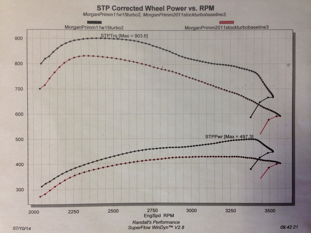

There is no fuel left. It doesn't maintain pressure on the top end now. These trucks only have enough fuel for low 500 area. It was only 20 hp less than the cast 66 single. This turbo is a great match for stock fuel. The bigger vgt that will be available in the future will be able to take more fuel with a dual pump setup. But that all the 11-14 can produce for now.
It was running the same h&s stock can tune on the highest setting. This truck has not been re-tuned in a year.

Thats a hell of a jump for nothing but a turbo swap without any tuning! So whats the pricing and availability of the 2015 turbo kits looking like Morgan?

It did get new fuel pump and fuel injecrors. Probably no way to find out the specs with out testing them.Based on the 'bigger turbo' and the 'stronger bottom end' promises, I'd bet the farm that there really isn't much more fuel than before.
So with dual fuelers a person might be right close to a cast 66. That would be cool and good news for the 15's when they get tuned. They are suppose to have more fuel available or so says ford.

Well. The dyno showed what I was hoping. Made 426/725 stock charger, without changing tune or any other parts besides the turbo kit with billet charger (didn't even clean the s&b) it made 496/903.
Extremely happy with those numbers.
71 hp and 178 ftlb gain with no other modification!
