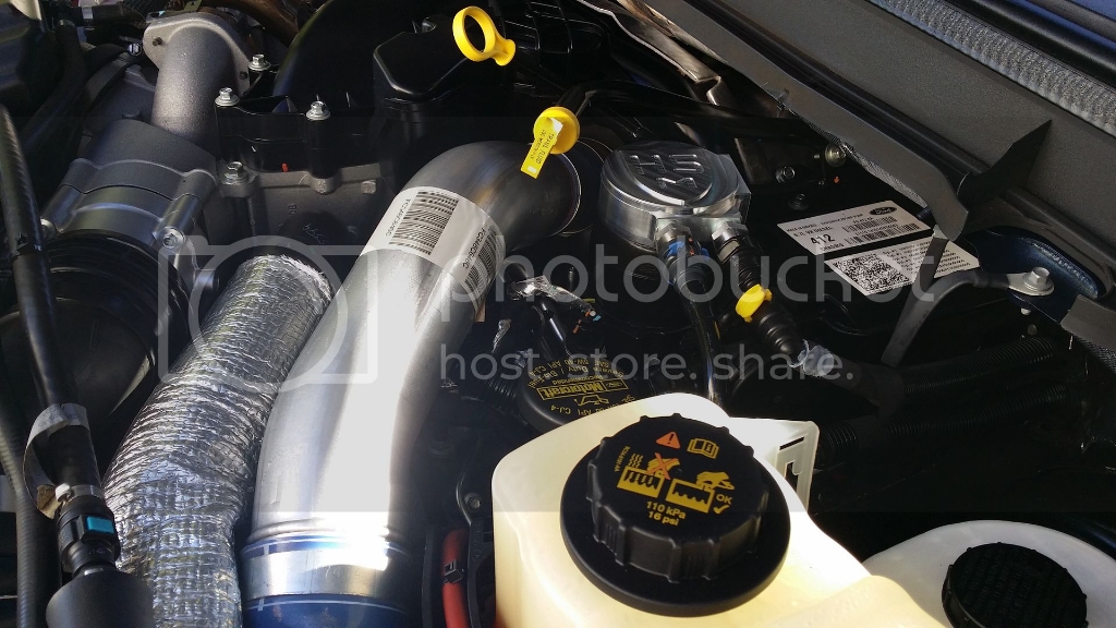

Just ordered the h&s fuel filter conversion. Will post pics of it installed and let everyone know if it stops the whine. Also ordered the AFE frame mount fuel filter. I should save quite a few $ in the long run.

Got the parts last night. Mike ships FAST! Will install this morning and post results!
Jomax
8,576
9
Arizona
Well, I installed it. So far zero whine. And maybe it's me. Motor seems a bit quieter. Will drive it for the weekend and report back if it is officially gone.
It sure looks good under the hood!
