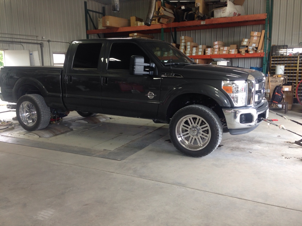

Not releasing any specs. But we are testing some different versions on the '15 as well as an '11 truck. The goal is to see what gains can be made on each. The '11 is tuned and ready to go. And with the added fuel to put through a '15 charger unlike the stock '15 that's undeleted at the current time. Once the '15 is deleted I will be swapping chargers with dyno testing all along the way.

This was a baseline run for all the upgrades to come. Made 380 rwhp and 725 rwt. Pretty stout. The '11 stock turbo we dynoed with h&s deleted with a s&b made 426/833 for comparison. Same gear, same load, same tire size etc.

Not bad at all! Did you have a baseline on the 11 or, what have they been doin stock?

Most bone stock 11-14 trucks were 340-350 that we've dynoed. We are using the '11 to get a power difference between stock 11-14 charger it has and the '15 billet turbo upgrade kit that it's getting next week.
