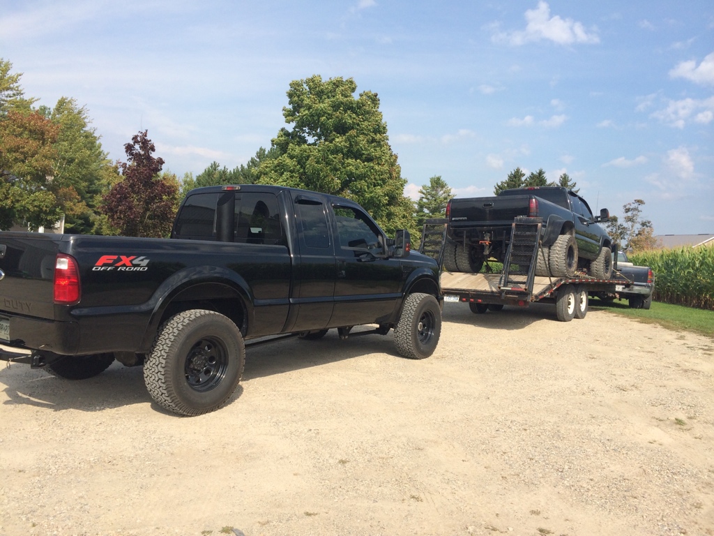

New traction bars on Friday night,2" .250 wall tubing with chromoly heim joints, they're pretty heavy duty so they shouldn't bend this time! Headed up to Collingwood Great northern exhibition last night...pulled 271 ft good enough for 6 out of 7, competition was real tough and everyone ran real good, blocked the rear suspension solid this time, truck still pulled smooth, just waiting on videos!

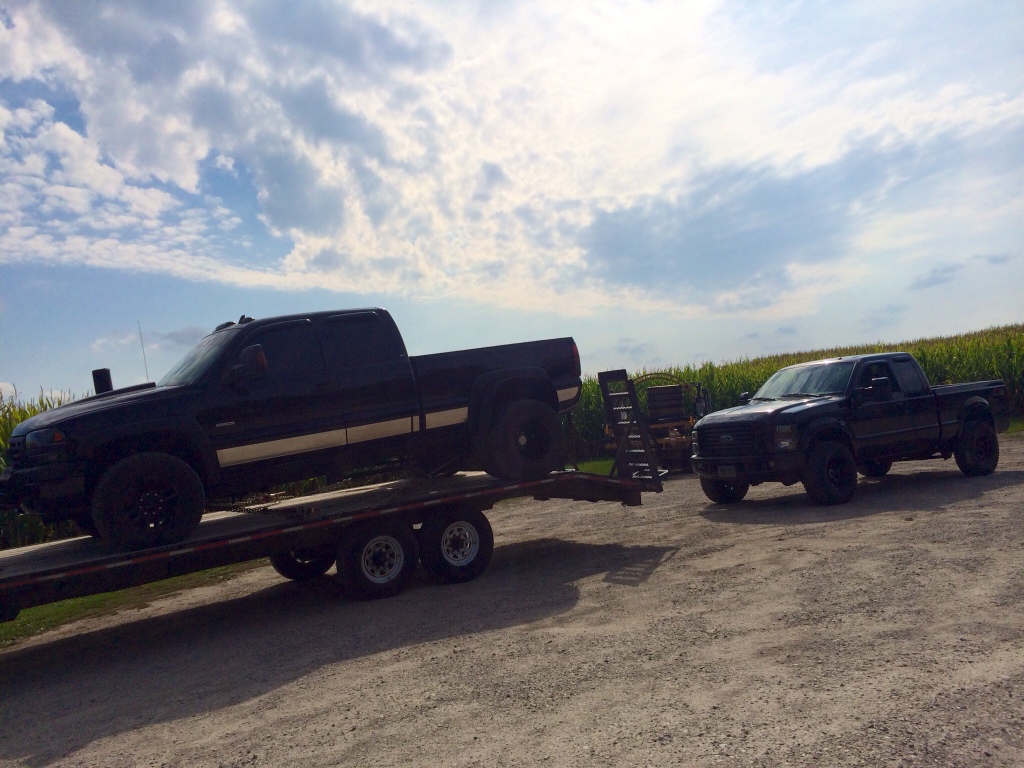

Mine and my buddies duramax heading out to the pull, he got first place with 318'

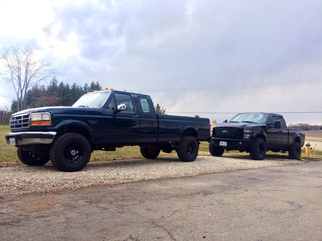

By the way here is the new tow pig I picked up a few weeks ago, bought a dodge cummins that I had for the winter but sold it to buy this rig :D 94.5 F250 7.3 powerstroke with a zf5 manual. Looking at deck over trailers in the next few weeks to haul the pull truck around.
