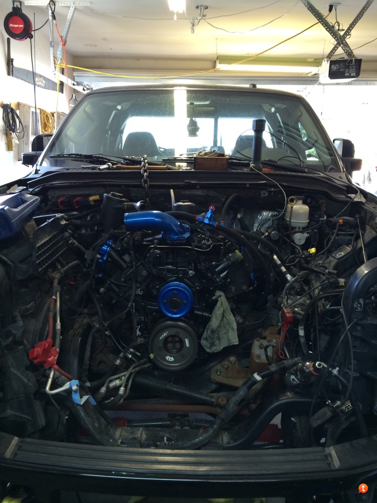

Fell a week behind waiting on a few parts for the transmission and engine, but got my rcd up pipes and midwest turbo kit installed this weekend, coated 6.0 manifolds buttoned up, and mpd regulated return mocked up on the motor, turbo ordered it should be here by the end of the week hopefully.

Thanks! Fwiw I only bought the flo pro kit cause my egr valve crapped out a week after I bought the truck and I needed a elbow and full egr delete so i went with the dirty diesels kit to get me back on the road, I'll be seeing you for a cold side and hot side pipe once I recoup some funds from this build lol

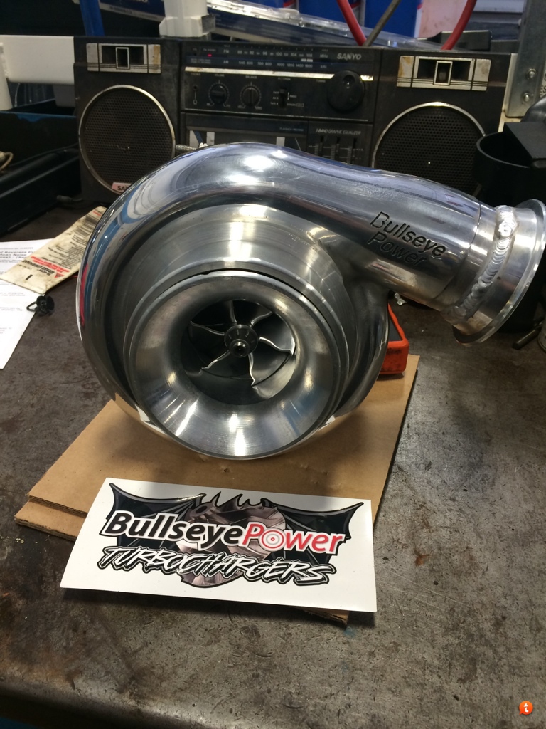

Good news and bad, this showed up today finally
Bad news is they sent me a s476 instead of a s472, had a few guys tell me to try it out and see how it works, but after all my research I felt the 72 was the max size I wanted to do on stock fuel for now, it does have the larger 87mm turbine wheel, with a 1.0 housing. What do you guys think? It will be going back asap, hopefully they can get me the right size quickly, the truck is pretty much ready to fire up, minus having no turbo.

I wouldn't run it, especially on stock fuel.
That's a bummer buddy... Hope they get it back to you quick!
Thanks, that's pretty much what I was thinking, I don't want it to be a laggy pig, not sure how they got the order mixed up but they're hoping to have me another turbo by Tuesday..shame to send it back..it's a nice turbo lol

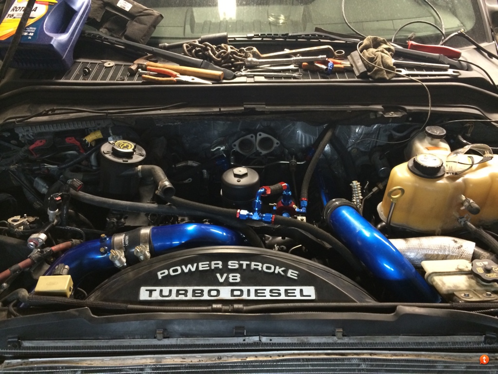

Sent the turbo back to bullseye to have the cover and wheel changed to a 72...took a few days to get everything figured out but it should be back by the end of this week...on another note after talking to a few people I've decided to throw the stock turbos back on for now to break in the motor and get the truck back on the road for an event this Friday, just waiting on a oil feed line for the stock turbos, hoping to fire it up tomorrow night. This is what it looks like now.
