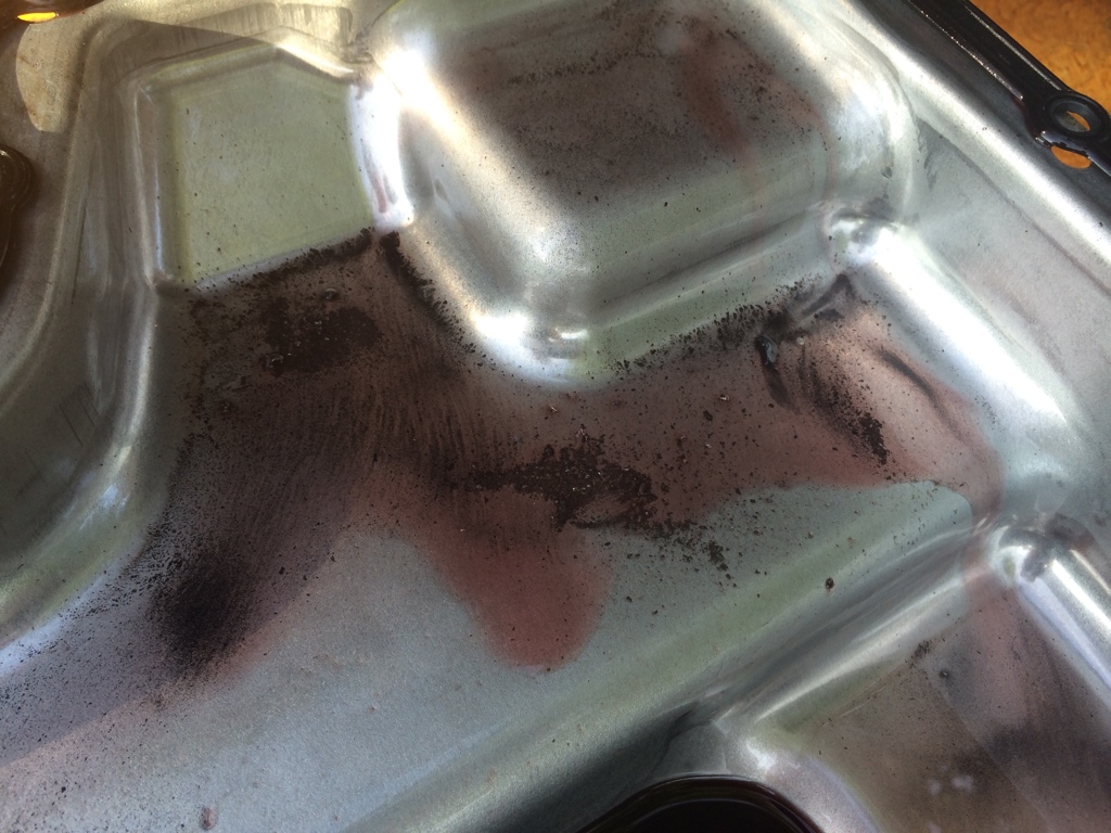

Well after pulling the pan down yesterday I found a lot of metal shavings and debris
The truck drove fine for the whole week before i stopped driving it, when it would get up to operating temp it would have a small shudder in reverse but that's it, until the day before I stopped driving it when it started getting stuck in 4th gear when I would slow down to a stoplight, still shifted fine up until that point, what do you guys think? Transmission or torque converter? I noticed when driving it my cts would say the convertor would lock but I could feel it lock on about 3-5 seconds later, I'd like to re use the tc since it's a new precision 2200 but I'd hate to put it in a freshly built trans to find out it was the converter that had failed and left all the metal in the pan. Any help would be great.

Any codes?
Nope no codes, no wrench light or anything, it doesn't seem to be getting stuck in 4th as much as it seems it wants to shift itself up into 4th gear, like I can get it back down to 1st but it goes right back into 4th right away.

Havent updated this thread in awhile, after having converter issues that took out the pump in the trans I threw in a stock trans and converter for now to get me back on the road, seems to be working good so I took it to a local bush pull this weekend and hooked it up to the sled, only have a video of the first pull, I was test puller so the sled was light on my first run, let off at the end cause the track was ending, very loose track, truck was bouncing off the rev limiter at 4450 the whole pull, pulled again at the end and ended up taking 3rd place out of 15 trucks, only weighed in at 7600 pounds in a 8500 lbs class, no suspension stops installed yet, pretty happy with it for a first hook!
