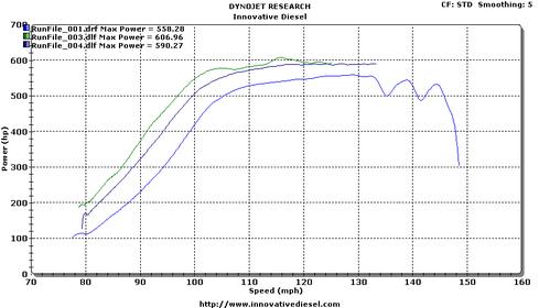

I received some news today from Nate, a customer that bought a stage 3 from me went and had his truck live tuned at IDP. He was also at Virginia dyno event and the dyno broke on his truck so he didn't get a number. He has the basic mods on his truck, running 190/100 injectors, stock transmission, 35" tires with 3:73 gears.
The first dyno number with a mail tune netted 550rwhp, after Eric did his live tuning on the truck it made 605rwhp. He is running the new stage 3 with the 11 blade billet wheel. Now Brair's truck put down 623rwhp on same dyno, difference was Brair had stock tire size with stock gearing and a built transmission. 18rwhp difference is not bad considering the tire size power loss. Also Eric runs trucks in overdrive not 5th gear, so number are going to be low. Brair took his truck to the track and showed that his truck as at 650-660rwhp, and so would this truck. So that is two trucks that made over 600rwhp on same dyno with a live tune at IDP, I have said that Brair's truck was no fluke and is wasn't. As long as your truck is a good solid truck to start with, you can put 190/100 in it and stage 3 turbo and get over 600rwhp, if tuned right.
Nate also told me that the customer is a little upset that the spool isn't there. He told me what he was having and I believe that he needs little more fuel to fire the turbo off faster, also think he needs to have the converter loosened up to get what he needs.

Ok, I am very proud to say that the 'customer' Adrian is referring to is me. Once I figure out how to post my dyno sheet I will have it up.
My truck did 606 rwhp on Eric's dyno. It was awesome and so was Eric. He answered all my questions without hesitation and gave me great customer service. Most importantly, the truck runs like a beast. Adrian's Stage 3 is no joke. It's a real powerful turbo and I'm real pleased with it.
As far as the spool up, I'm not 'upset' Adrian. All is good. I gotta drive it a bit to get used to how it's now running. And I'm a firm believer that these trucks, or at least mine, needs a couple weeks of in town and highway driving to really get used to and learn the programming of any new tune. So I am not ready to pass any kind of judgement on spool up. I think things will continue to get better with time.

Good deal Pete. Glad Eric got you fixed up with a good live tune. Now let's get that firm on the track.:thumbup:

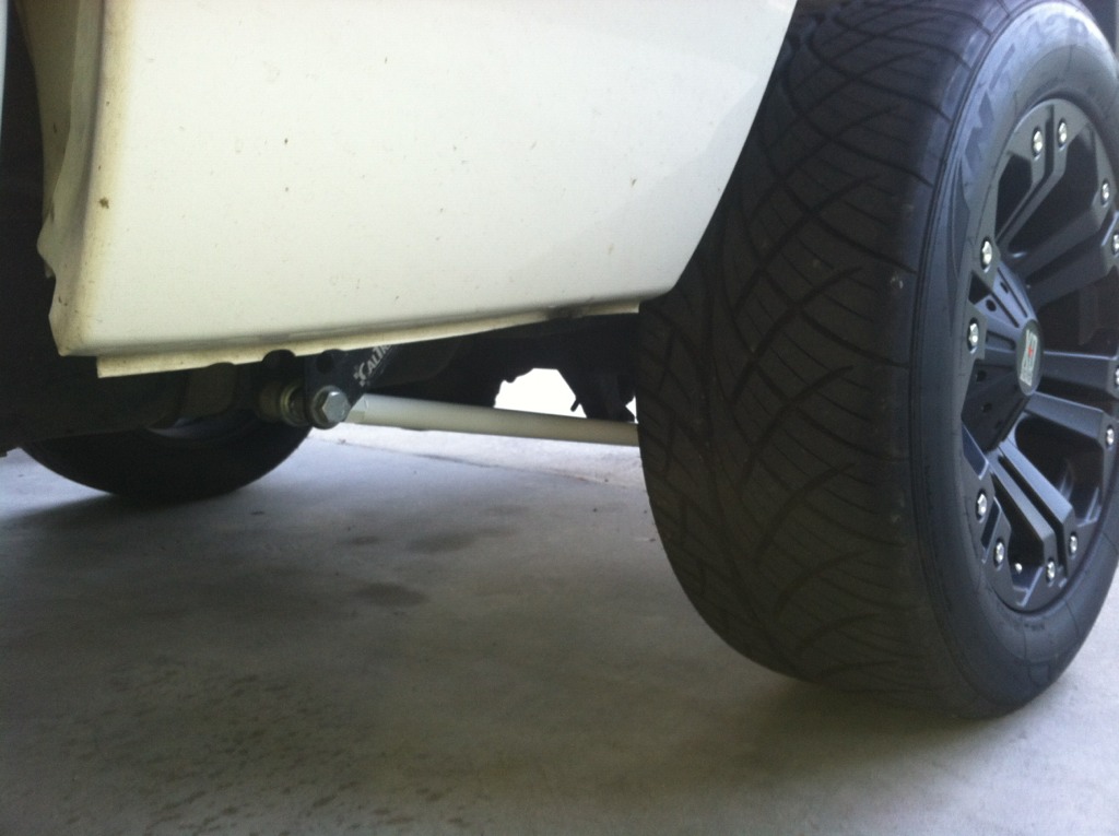

Those look nice. Which Caltrac model are those? Did everything you need come with the order? any welding or all bolt-on

I had to get shorter u-bolts bc I have the blocks taken out of the rear. Other than that very simple bolt on install besides gettin them bushings out

Caltrac will send you U Bolts to work with whatever you need for your application......just got tell them what you are doing. Doesn't take long at all to install, all bolt on.
