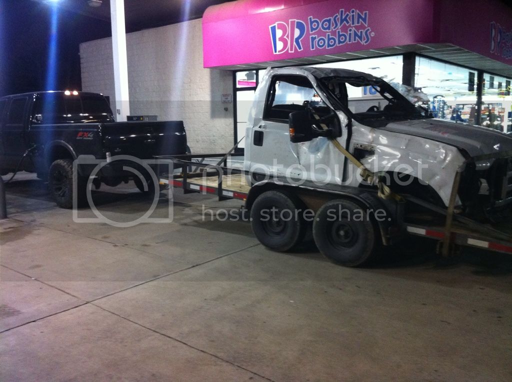

On the way back to college station from Missouri with the donor truck and parts!

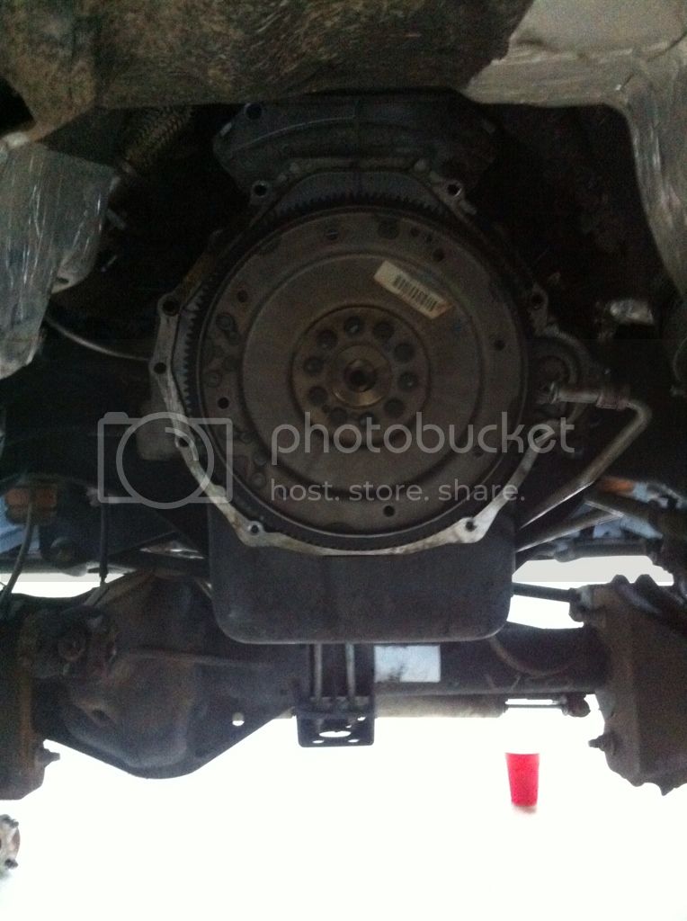

Having trouble getting my hands on the special tool used to reinstall the rear main seal, has anyone done the rear main seal without it

Never tried it before but I have usually had the tools at my disposal.
The problem is you need to put the seal and wear sleeve on at the same time to the same depth.
Do you know any dealer guys that could help you out in your area?

I don't use any special tool. I've put in a lot of 6.4 rear mains. They come with a plastic ring from ford. Use a small ballpeen and the plastic ring to drive the seal in while working around in circles. If you have a round seal driver the same size that makes it even easier. I've never had one leak yet.

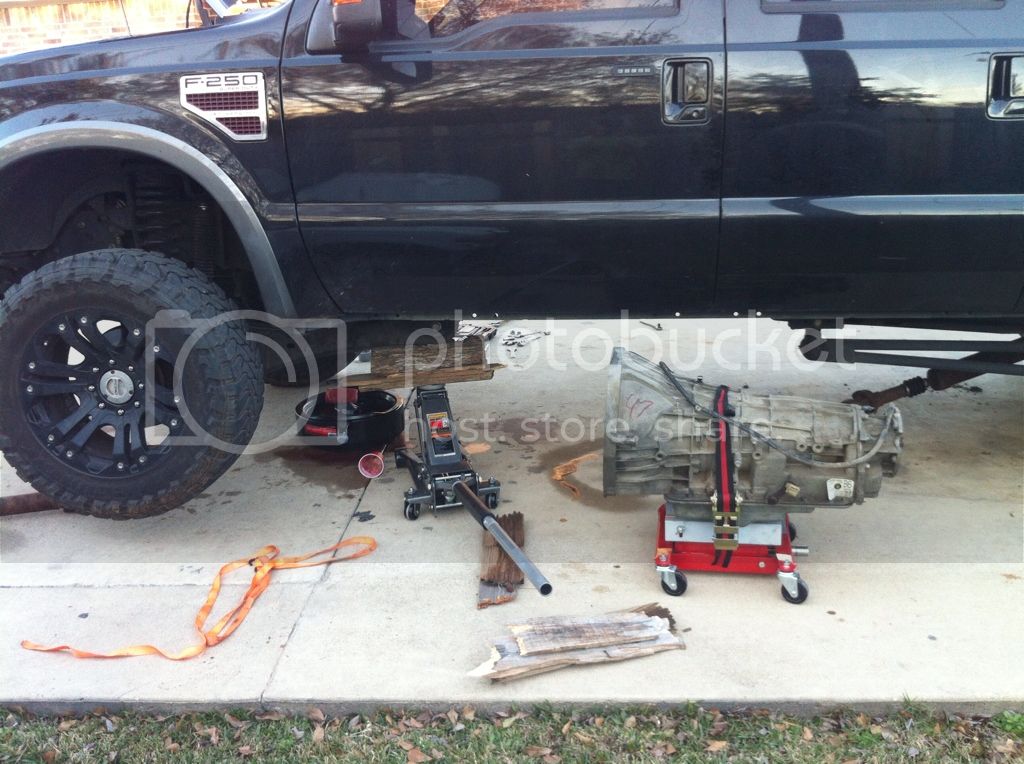

Currently in Houston for the holidays, will be back in cs by the 2nd I believe and will be dropping the auto driveline then, if you wanna help out, pm your number so I can let you know when I get started
