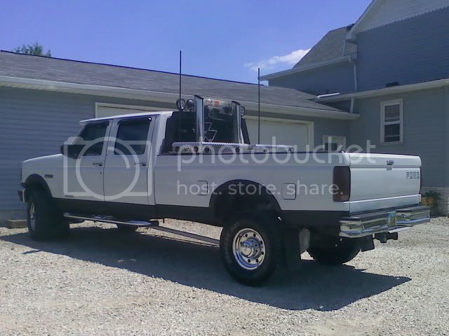

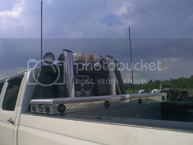

well here is latest thing on my OBS wanted something different then a single or out to the outside needs a little work yet but i like it :)
Fully custom bed kit that i am very proud of, 5 inch Y pipe off a semi and one 5 inch 90* and alot of time lol

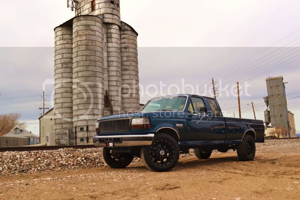

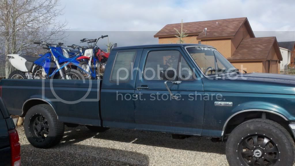

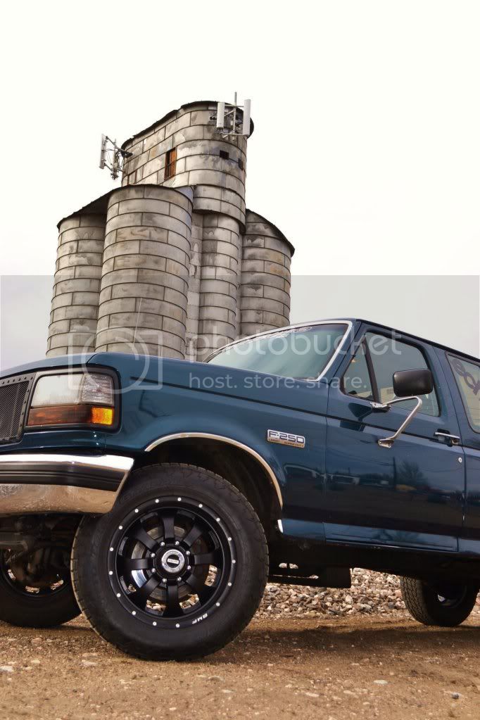

whys ya front sit high in the pictures???
but wish i could be by a beach lol
In the beach pics I didn't have my f350 blocks in, only my 2.5 add a leafs on the front. Ordering my drop pivot brackets to kill my camber probably next month.

Well got some f350 blocks put in the rear so that's step two on my lift, just need to find some 2.5 drop pivot brackets to go with my 2.5in add a leafs and ill be set..
What kind of 2.5in lift do you have? I want to do one on mine as well. Why do you need drop brackets for that little bit of lift?
FORD7.3
450
Its kind of pieced together.. they're tough country 2.5 add a leafs on 250 hd springs ( mine were not the hd springs ) and a factory F350 block in the rear (required new ubolts 14in long 3 1/2 wide on a round bend ) but it brough the front up like crazy cause the ttb has a pivot and as you push down on the outside it creates camber so the drop helps bring the pivot point down to the level of the springs.
