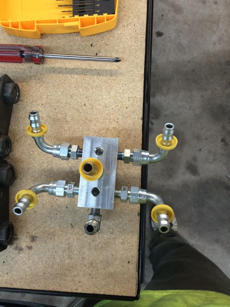

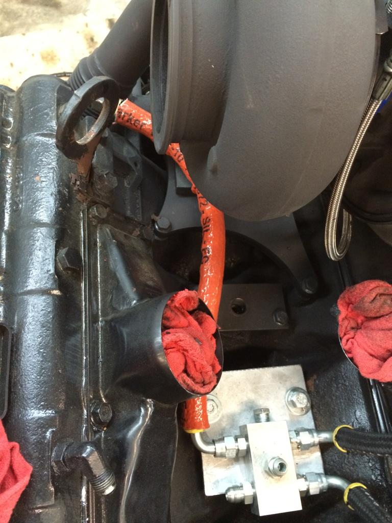

Here are a few pics of another 4 corner feed I did for a customer. The one on my personal truck is a little different but same basic design

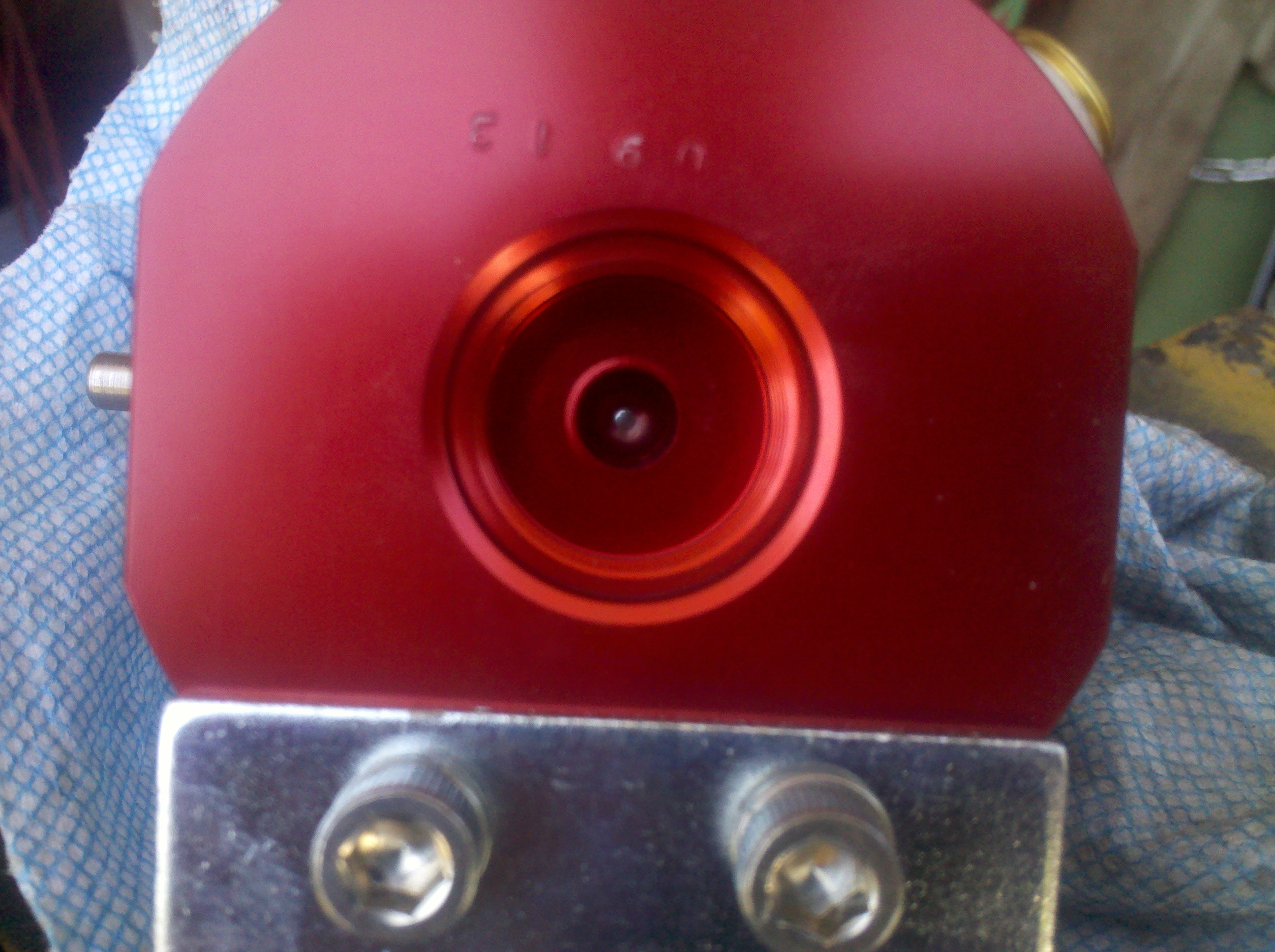

If you do this is your system then a dead head style? Or can you do this with a return?
it is what Aeromotive tells you to run. most likely due to the small passages from the 1/8npt to the banjo bolts.
you could call it a dead head as the fuel doesnt constant flow through the rails, but it does constant flow through the distribution block so the pump should be happier if the lines and fittings are upsized (the reg is still a very small orifice)
Pretty slick. What material did you make it out of? Looks like some grade of aluminum.
Oct 27, 2011
376
Waxhaw, NC
Just have my machine shop make them up out of billet aluminum. The way I do them now they bolt to a plate which bolts to the block on the front mounts in the valley. Looks real nice with anodized fittings and mounted block
That's cool. They look like something I could make on my lathe and mill. Thanks for posting!
