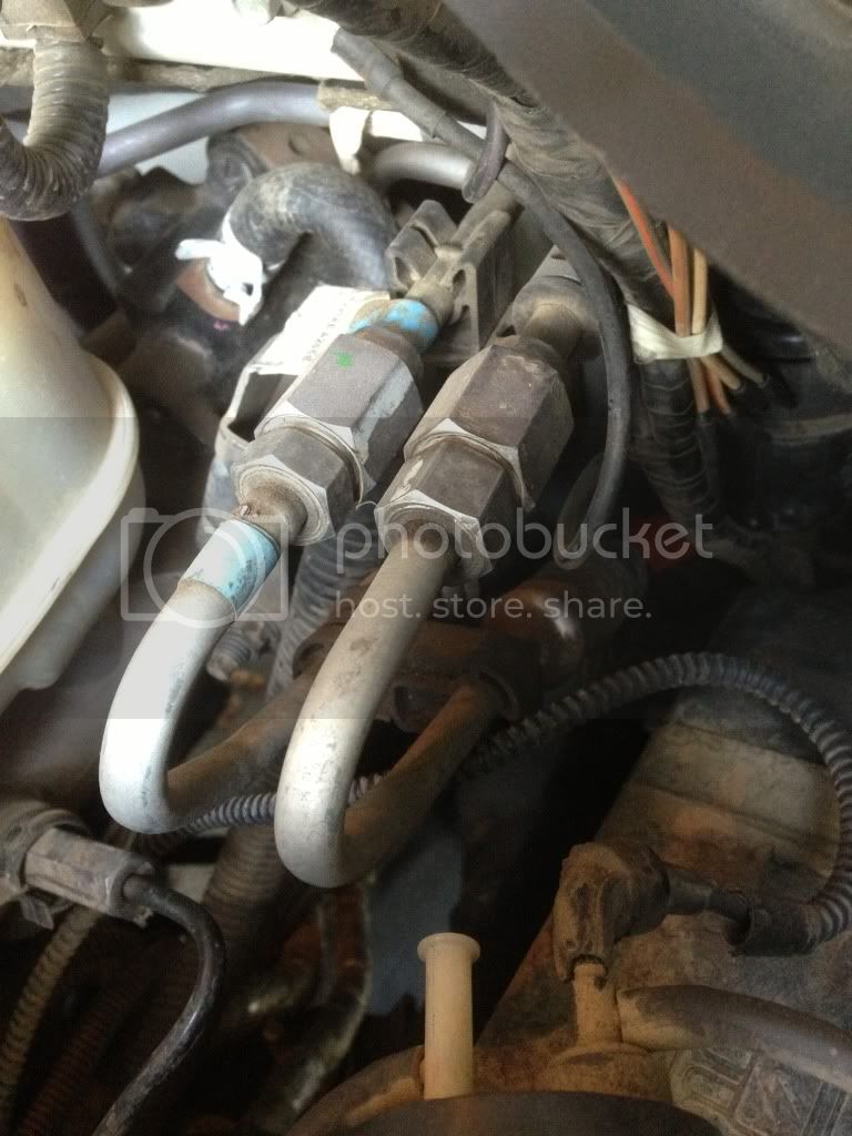

Having an issue with the brakes. When I push the pedal is makes a hissing noise and while driving it doesn't feel like a normal stop. But if I'm turning the steering wheel and pushing the pedal all is well. Anybody had this experience before?
I didn't undo any brake lines only took the master cylinder off when I had the cab off. All fluids are full

Makes sense because the little spacer that holds them together came off so I guessed at how they went on. Thanks man!

There is normally a blue tape or something around it so it won't get mixed up, just a small FYI
