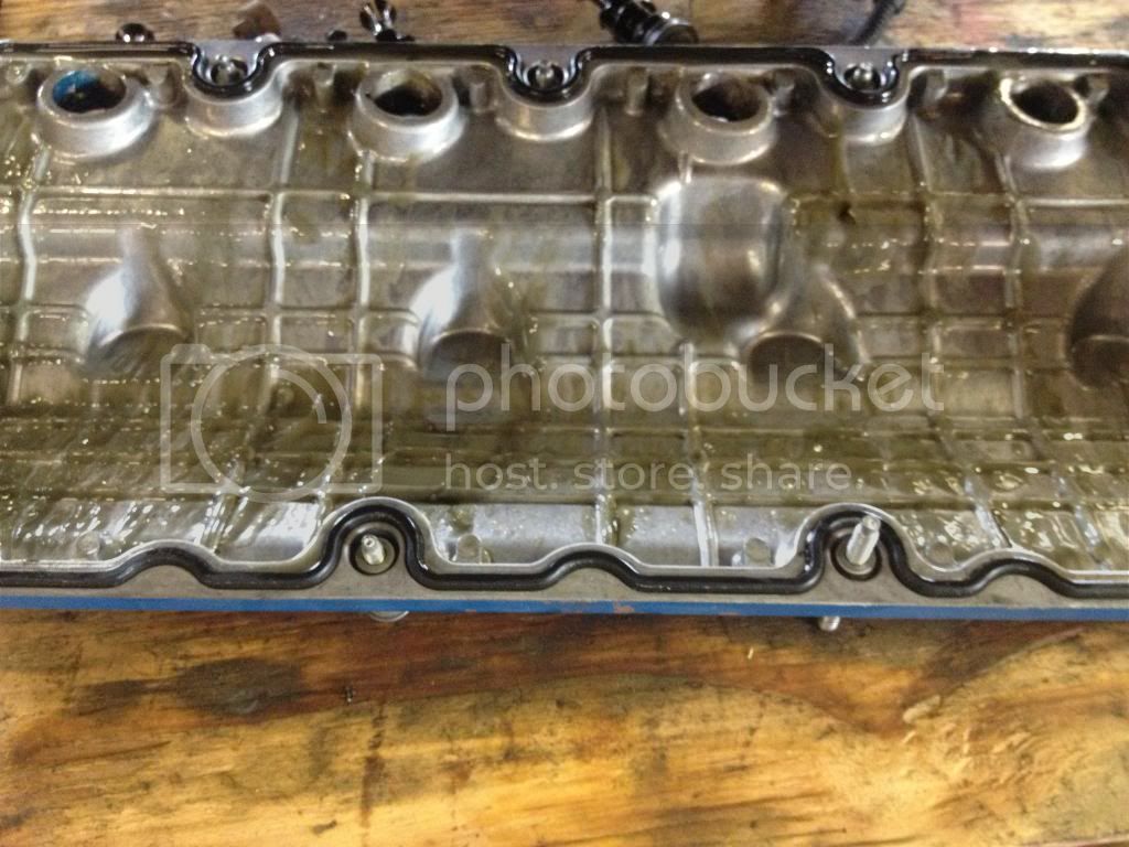

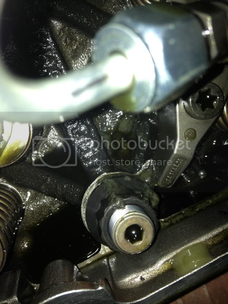

under drivers side valve cover
at first i thought this one was leaking but this is where the water was pooling up from the stud that was leaking right above

dude that is so ***ked. this cracked block phenomonen is insane, craziest part is the low torque value you just used.
i wonder if the stock bolts have a part in this, as they are torqued so tight.

A bolt will never put as much clamping force or load down vs a stud being torqued to the same spec. A bolt has to overcome way more friction, torsional loses and such.
As far as blocks cracking, there has to be a casting number relation.

Wanted to make for sure it was the block today before we called. I removed the stud and you can literally watch the water roll out of it when it's being pressurized. Calling them tomorrow
