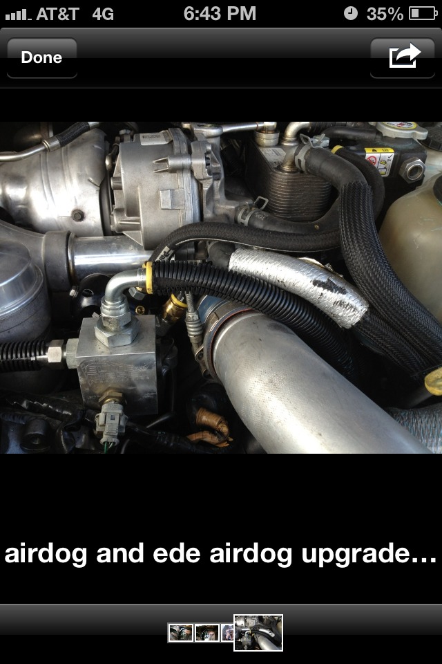

who knows that the thread pitch of the fitting is that comes out of the left side of the EDE fuel block? -8an on one side right? then a straight thread with oring on the other?

im not using steel braided lines. just the black hose thats braided. push lok fittings as well. i called my parker store last week and they said they dont have the double banjo bolt I'll be needing so gotta get that elsewhere. probably elite

Post a pic of the location if the fitting.
Coming out the left side of the block. Feeding the second pump.
