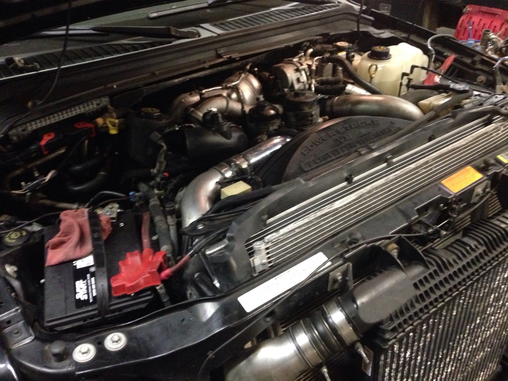

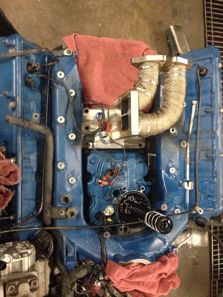

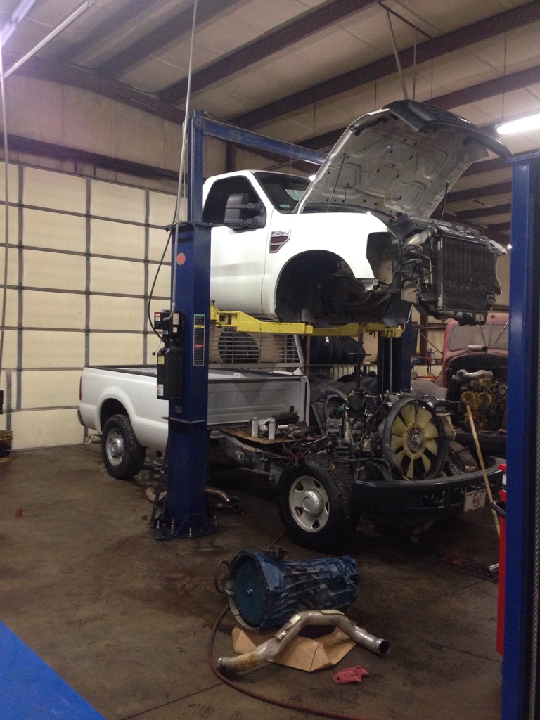

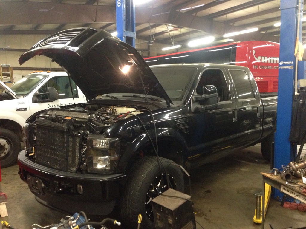

Cab is off the single cab. Fixing a few things, oil leak and exhaust leak, and it's ready to pull and put in the black truck.

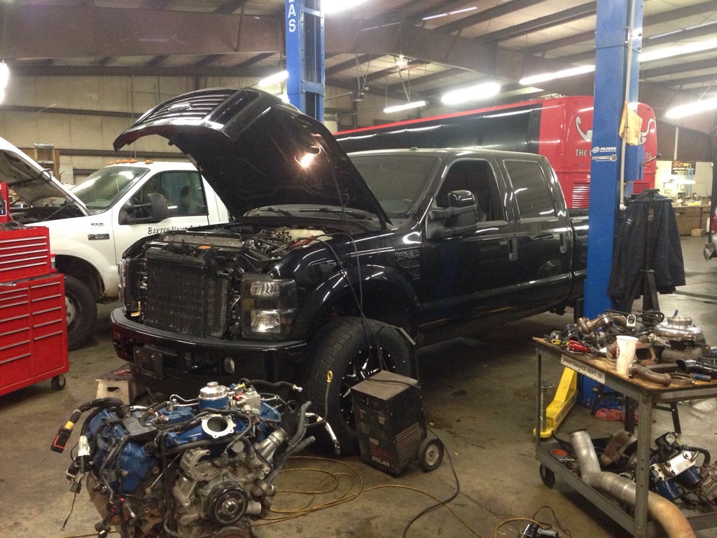

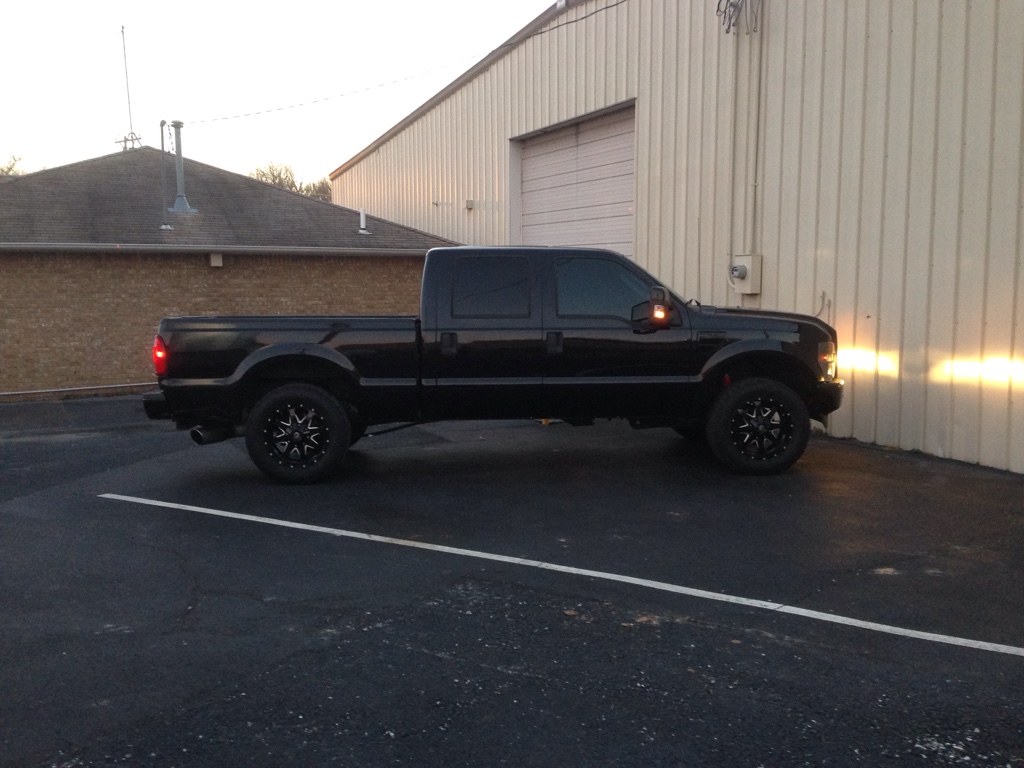

On another note the black truck got picked up by its new owner today. Local guy so hopefully he'll bring it back to us anytime it needs worked on. Got sold with the spartan, 5" flo pro, egr delete with elbow, and afe intake.

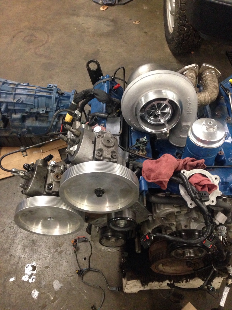

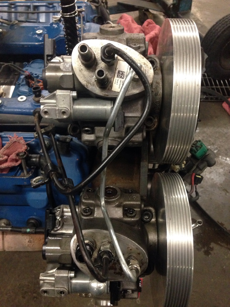

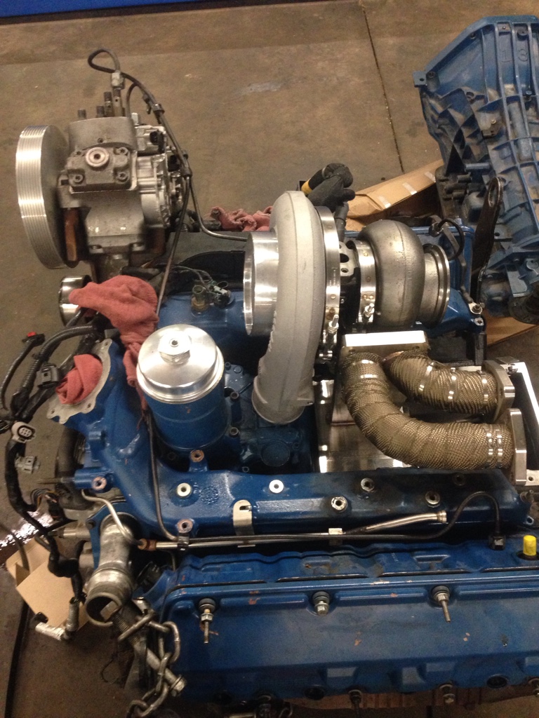

Little update for the day:
125% reman oem injectors showed up from RCD earlier this week.
Twin pump out front kit from Morgan showed up today so I mocked it up just to get an idea of how it would go together.
Thanks again to Jared for getting me the injectors so freakin fast and Morgan for selling me the kit off his pull truck.
