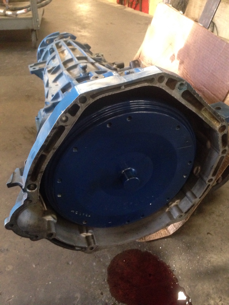

Time for a little update. Finally got a Friday open enough to where I could get this in at about 4 in the afternoon. Worked on it until 830 or so and got the wrecked stripped down to the frame and everything that won't be needed was unbolted and thrown in a pile.
Then pushed the frame outside and power washed all the mud and grime off of it.
Got the engine out of the corner and put the converter in the trans and got them bolted together.
Then got it all sat in the frame. Went in much easier than I expected it would.
The easy part has been done. Now onto building a fuel system and getting everything bolted on and into place.
