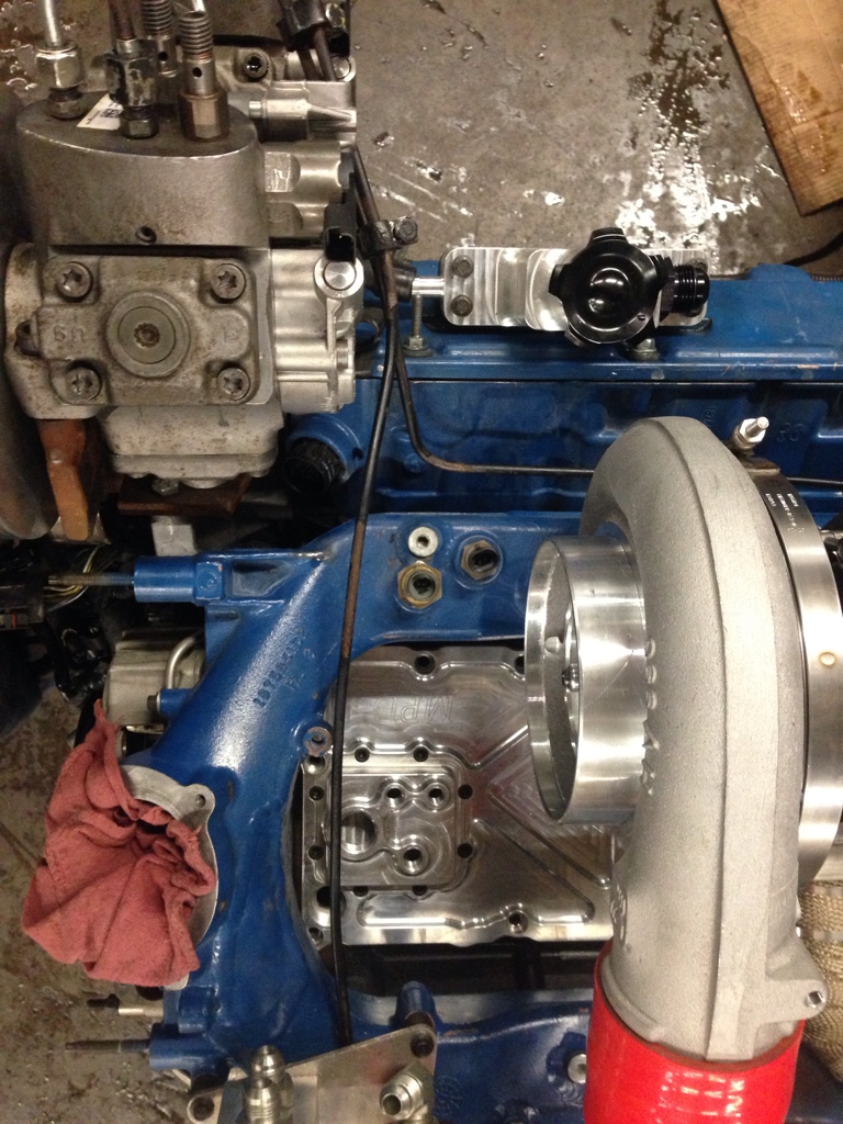

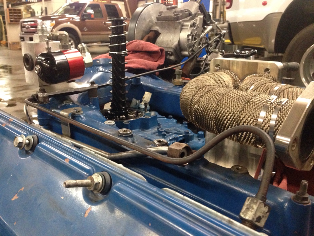

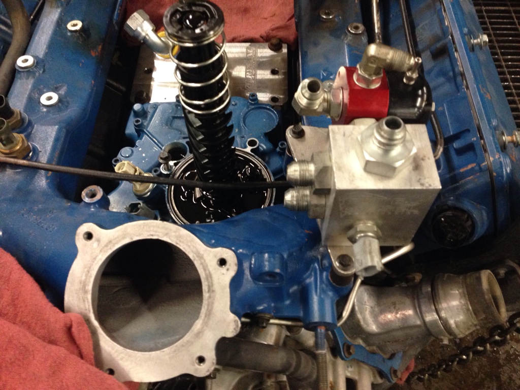

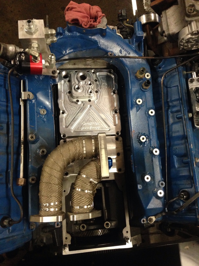

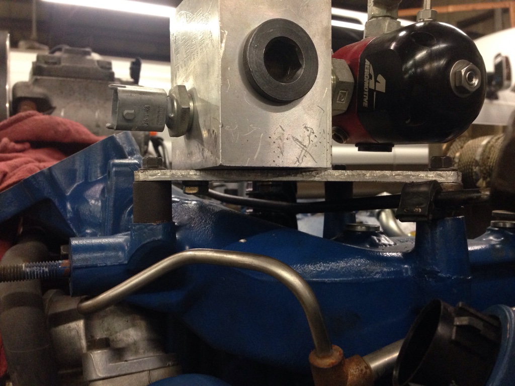

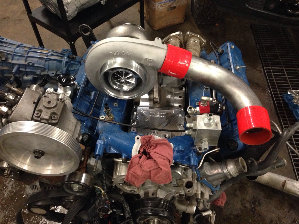

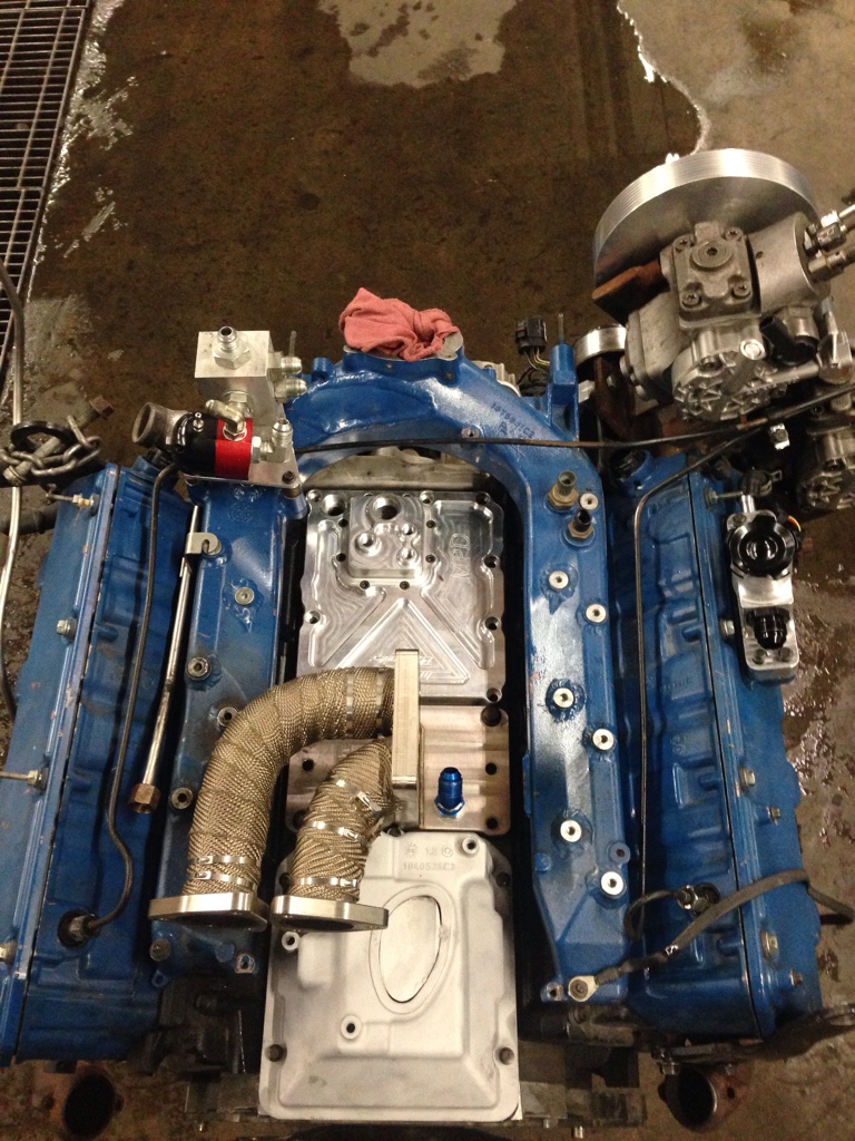

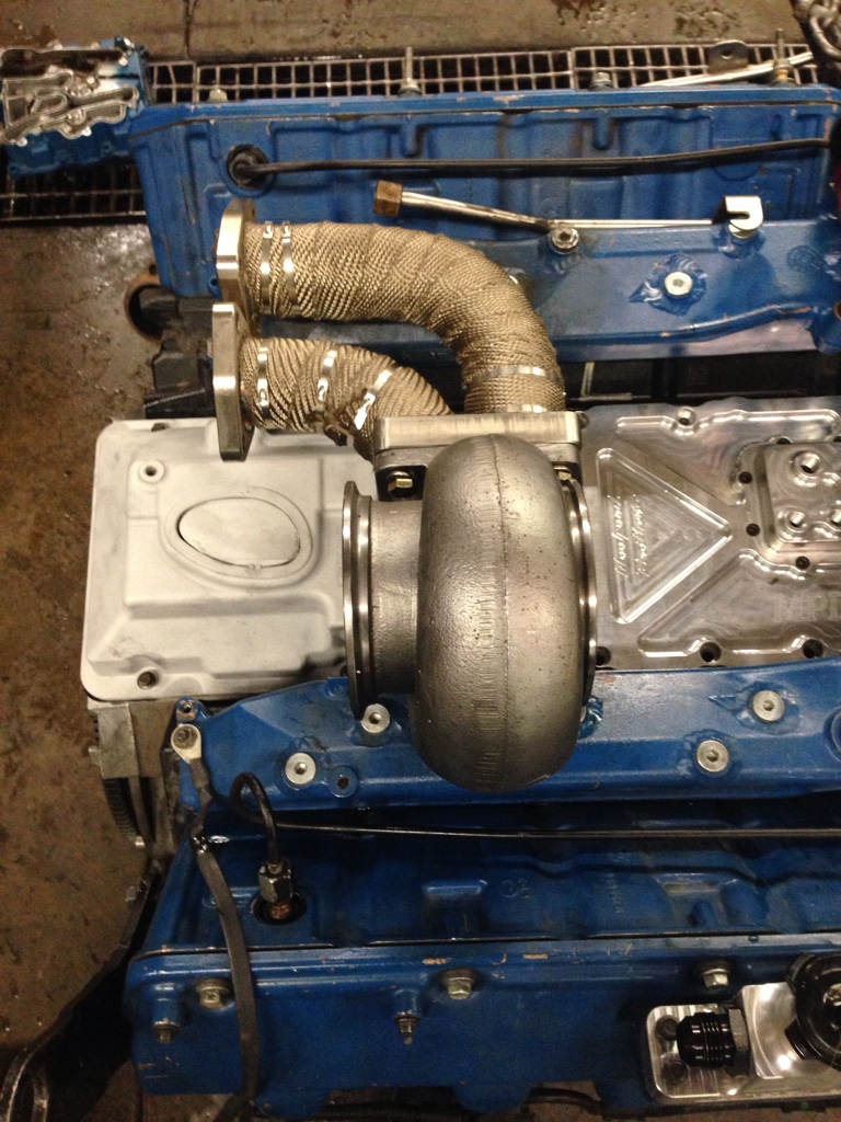

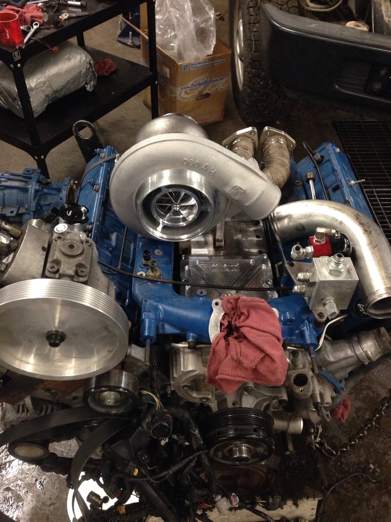

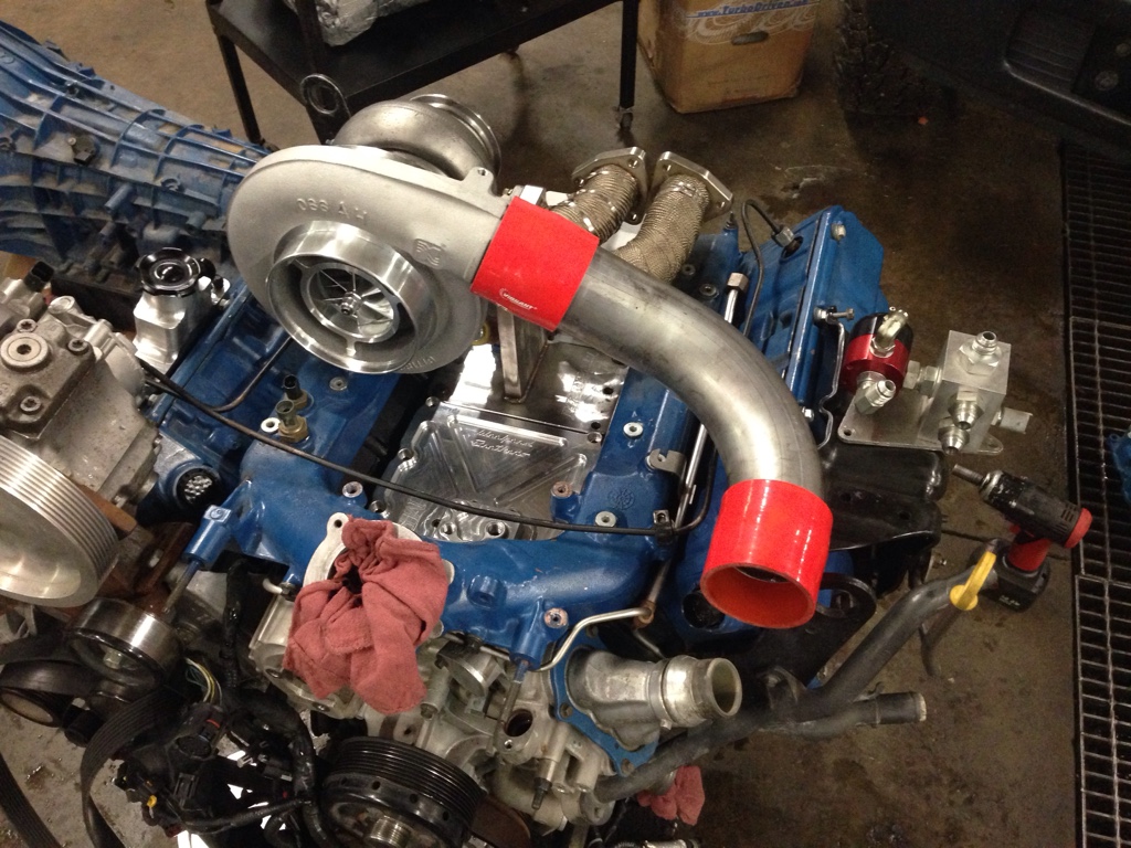

A few mock up pics to see how everything is going to fit

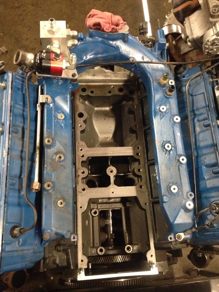

Fuel block may end up getting moved somewhere over on the valve cover to make room for an intake of some sort. Not much room for it to go to the passenger side so I think it'll be towards the drivers side.

Looking good Dylan. What is the estimated hp your gonna be pushing? Any idea
Corsilli did 910 on fuel with basically the same thing so somewhere around there. Over 1000 on nos id hope. Hopefully running high 10's in the quarter is the main goal.

Tree Trimmer
2,016
i'll wager it gives you more room elsewhere for turbo's etc etc.
it's probably not so much about advantages/disadvantages, but more about how to pack in everything under the hood that you want packed in, and relocating things is whats needed.

I sold the airdog and bowl delete. going to use an a1000 pump. where can i get the filter heads for the fuel filters?
Tree Trimmer
2,016
if your just going with a spin on fuel filter, we always use baldwin filter bases. really any parts store.
