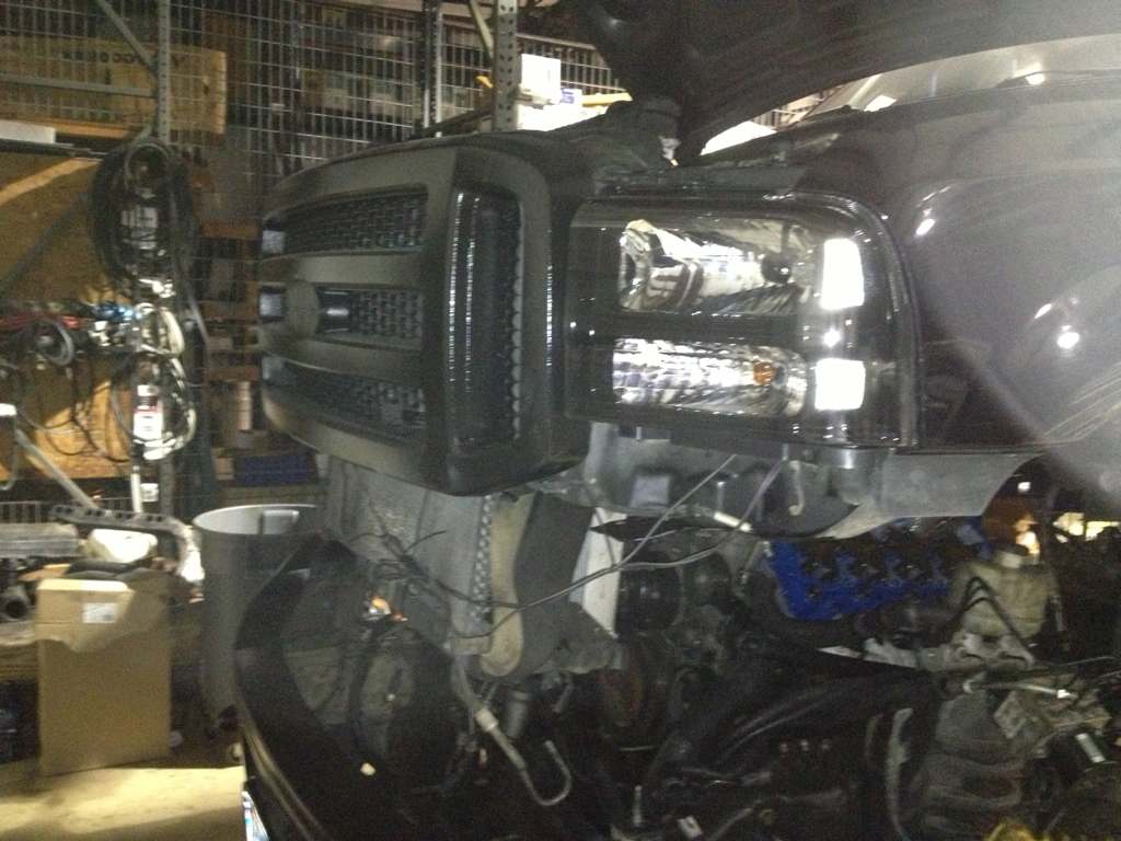

Morgan, Sweet looking build!! let me know if you need any help with coolant return lines for your manifold setup. I'd be glad to help!

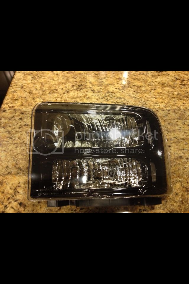

they're Depo Headlights from Complete Performance. They have clear reflectors which make them much more subtle then the OEM harley lights. And theyre awesome quality, just like a set of stockers.
