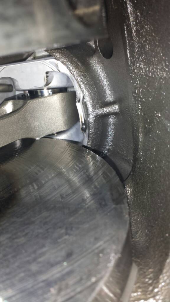

Yea slightly bent. Rotated crank and it still touches, move the rod side to side and it still touches.
