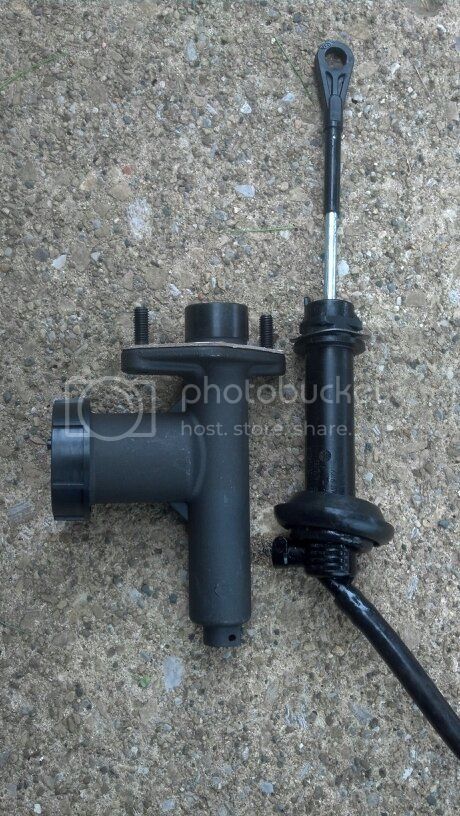

I bought a master cylinder from an 80s f150 and it was obviously bigger.
[/URL]
Unfortunately I had to make an adapter to use this bigger MC. This is what I quickly came up with to adapt it.
[/URL]
As I bench bled the MC it was obvious it also displaced a lot more fluid. Once installed the pedal was much stiffer. The new MC was a success!!

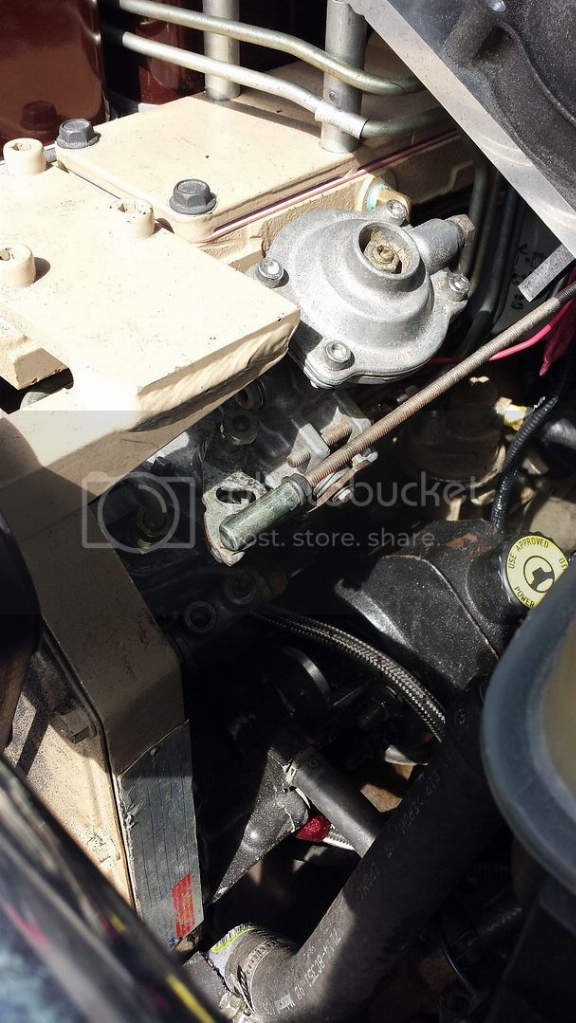

I've discussed it with bill at php and he didn't have any good input to resolve the tach or speedo. I've also read things about when converting some gasser ford's in order to get the tach working you got to wire in the cam sensor wires with the crank sensor wires. Unfortunately I removed wiring for them already. I can't find a good pinout of the pcm to replace these wires :( I am though getting a good signal produced through the orginal crank sensor and the machined harmonic balancer. I was actually getting about 10AC volts through it but I gapped the sensor out to obtain the desired .5-1AC volts, so I think the sensor is good. I've tried feeling around for a VSS on the rear differential but can't locate anything on it. I'm also thinking maybe the problems are tied together. All other gauges and accessories work on it it's just the 2 important ones I have failed on.....so far. Here's a few more pics.

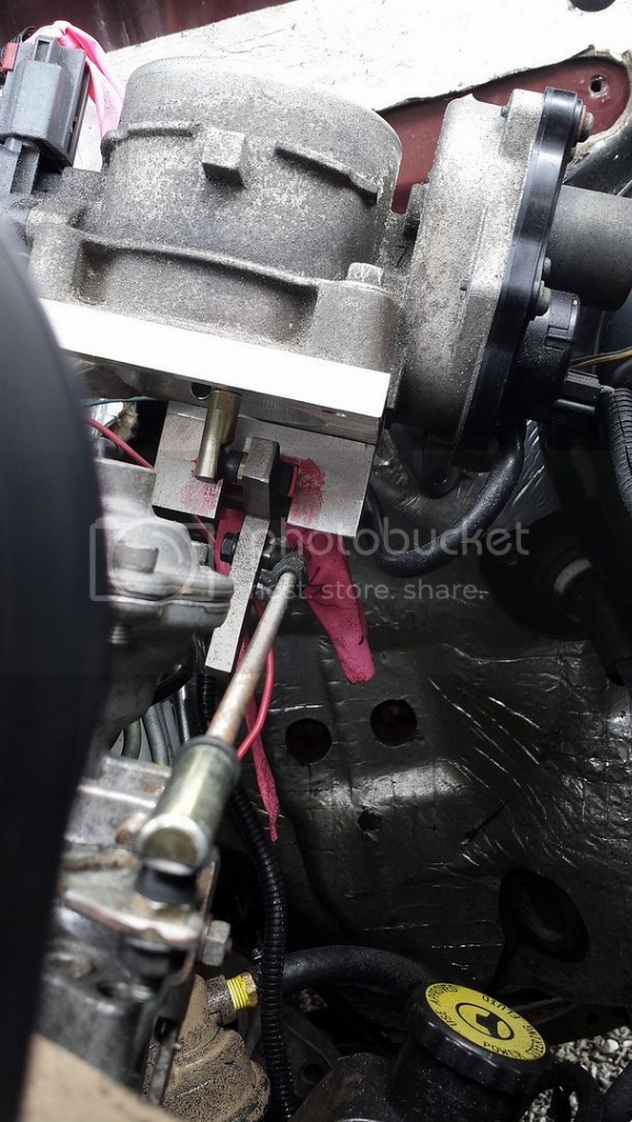

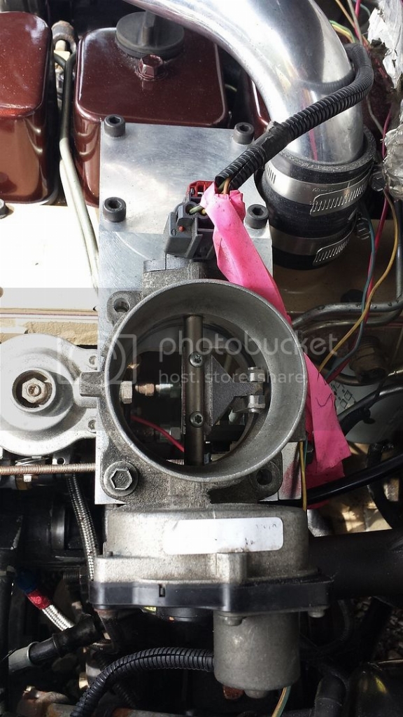

And here's a few of the throttle setup which I guess you could say is drive by wire. It works well except apparently in the original programming whenever you let off the throttle completely it will initially drop below idle and then reset to the idle position. So on the original 5.4 it would in theory completely cut off the air flow for a split second and then return to idle. This is the first I've ever noticed this on a vehicle. I hope to have this programmed out someday. Anyway here's the pics.
anyone have any input on these problem areas?? Thanks.

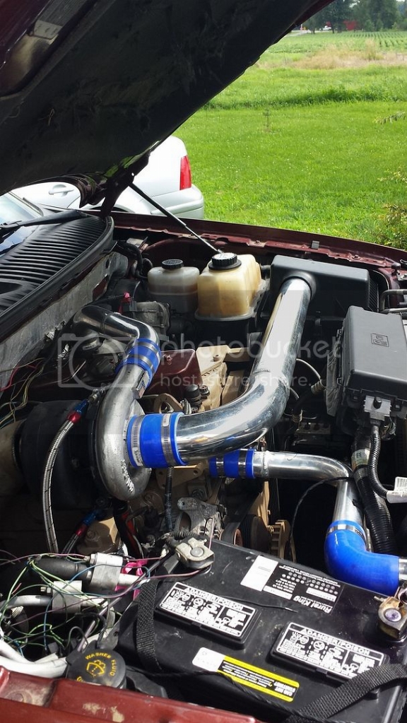

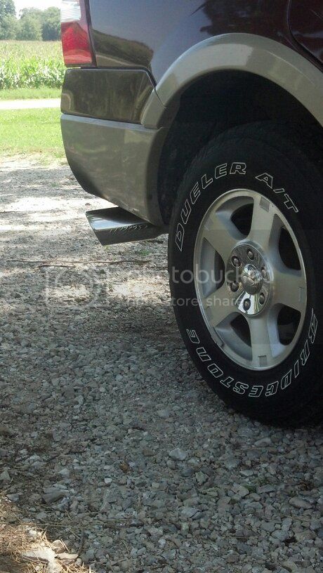

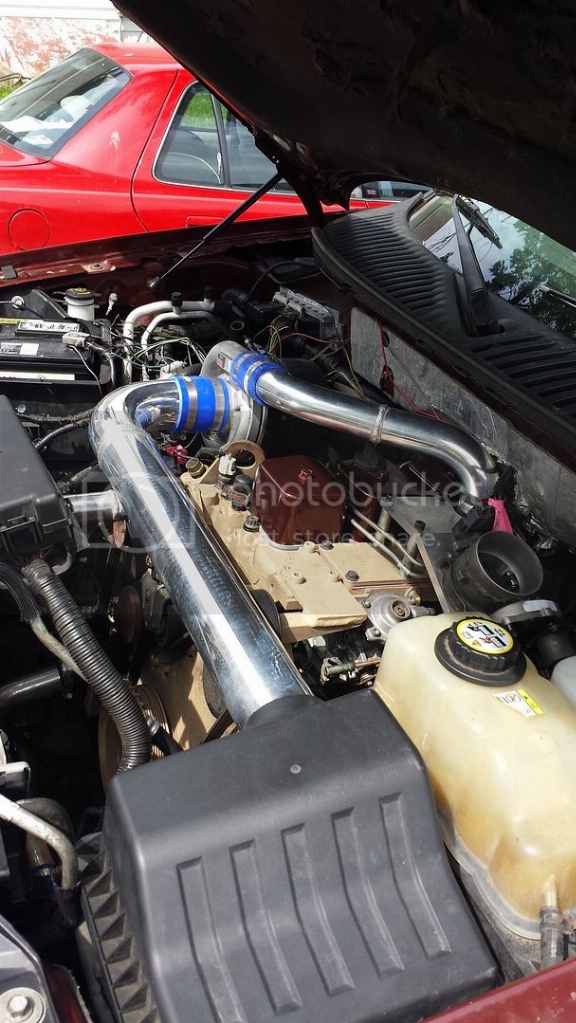

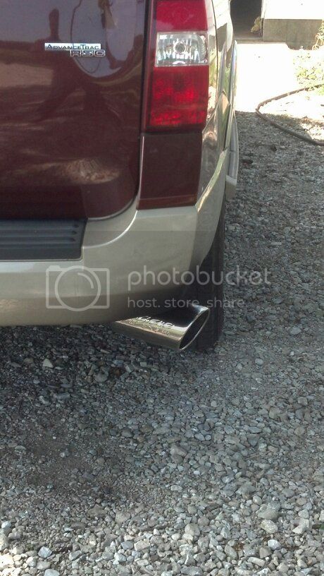

After a few more miles I don't think it's turbo surge. I think it's something in the fueling of the IP. I've been focusing on some other things on it as well. I got my complete 4" exhaust ran with a 5" mbrp tip. I think it looks pretty good. It's got a pretty descent exhaust tone as well. I also think the exhaust noise is just fine, not obnoxious. I also put a temporary boost gauge in as well. During a hard run it'll hit 30psi. I thought this was pretty good with this turbo. I currently need to replace the alternator as it spikes voltage at random times...18v. Especially when I get on it for a bit. Here's a couple pics of the tail pipe.
ja_cain
Aug 10, 2013
4,597
Looks good. You need to post a video of it, standing 6 or more feet away. Would love to hear what it sounds like.

Very impressive.
