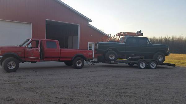

bringing it back from the fab man
What a hectic week...
Taxes are done, trucks done, swap meet was full, springs in the air (so more yard work)...
But I digress....
Picked up Eleanor Thursday night from Four On Fabrication. If you need a guy, I know a guy. Gary's a good dude who enjoys this type of work.
The Baja rack is secured in place know, properly thanks to Gary.
The big bumper wouldn't sit right on Eleanor, so Gary fixed that too. And then trying to use the 1978-1979 column shift mechanism, while hosting a 1996 Powerstroke drive train that was also column shifted, well Gary made that a possibility too by making the bracket to secure the shifter cable properly.
We were however, unable to devise a way to make those King Ranch seats fits without modifying the floor pan. I am not a tall guy, nor am I short. but mocking those seats in, I was literally an inch, maybe 2 from the roof. So....I don't know yet. Current plan is to get it drivable and use stock seating until I figure out another plan...

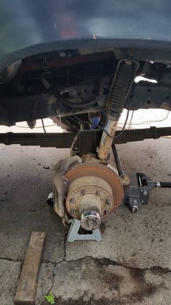

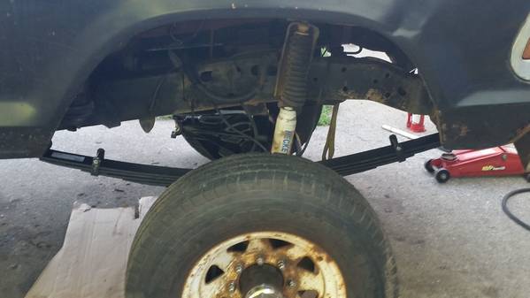

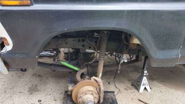

dana 60 upgrade, along with springs
rear spring shackle shows how stressed the suspension is from the new found weight...
1killerz
Feb 8, 2016
342
Western Michigan
skyjacker spring number as recommended by their tech service based on newly added weight on front side...

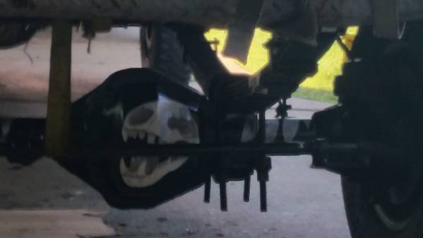

go time...
its in and situated
need to shorten the u-bolts. Has to re-use them from the monster spring packs that were on the axle when I bought it.
