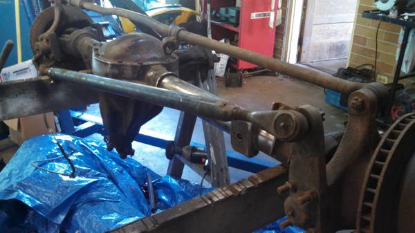

D60
Tired of looking at spaghetti (wires).
So I decided to take a night...or three, and clean up the D60.

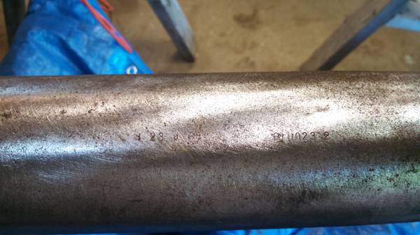

Even managed to find the factory stamping...
1killerz
Feb 8, 2016
342
Western Michigan
D60 drama...
So the good first:
* The Dana 60 is being done professionally (explain that in the bad news)
* The Full float sterling 10.25 axle in the crew cab when I bought it, is correct with a 4:10 gear ratio
* The engineering of the Sterling axle will make the swap of the disc brake set up on the donor sterling axle to my existing sterling axle easier than originally anticipated
* My buddy discussed temperatures created in axles under load and thusly talked me out of rhino lining the axles. Will be sticking with the chassis gloss black paint
The bad:
* The donor sterling has 3.53 gear ratio, and is weld locked. So I will not be using that axle but will instead be selling it once the disc brakes are swapped off.
* The donor D60 to replace my stock 44 has at he same 3.53 as they came off the same rig. This obviously necessitates a gear change in the D60.
* The previous owner had an issue with the lock hub on the D60, so he welded the internal clip. We had to get it off, and the outer shaft is no longer good.
* Some of the internal seals are bad, so essentially a full rebuild is coming.

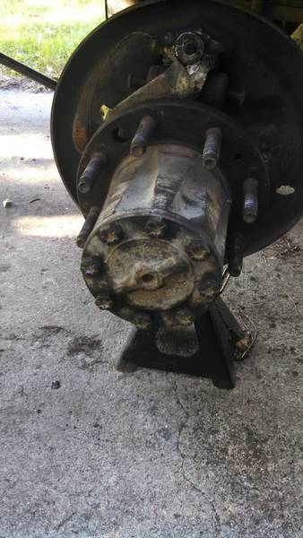

So step one. Open your beer. Charge up your air compressor. Look at tire....
Step two, remove the tire. Would have taken a picture, but I only have two hands; one for the beer and one for the tire.

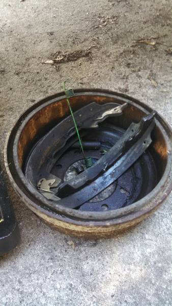

Step 3, remove the antiquated drum brakes that barely stopped your truck adequately.
Step 4, charge up air compressor again, open another beer (it's hot damn it). See all these bolts? They need to come off.
Don't lose these bolts, they are kind of important...
Step 5. Get a oil catch pan, it may get messy.

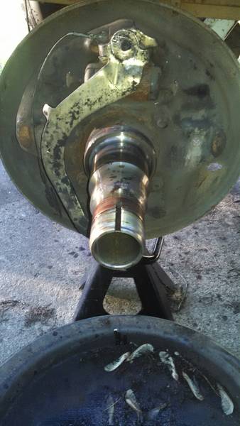

Remove the axle shaft
Treat that shaft like gold. Don't just drop it. Carefully guide it out of the axle tube.
Step 6. Grab another beer

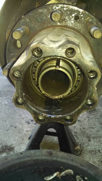

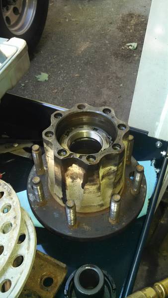

Step 7. There is a hub nut in here. It takes a four (4) pronged hub nut socket, not to be confused with the six (6) pronged hub nut socket found on older Dana 60's.
This is threaded specifically to the side of the truck it is on. Please consult book as I am no expert. But I believe the book set left hand thread for the passenger side and right hand thread for the driver side.
Step. 8 Comment about how hot it is and how much you love the smell of gear lube in the evening.

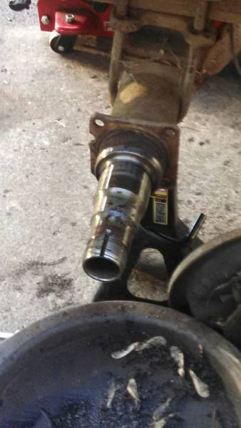

Step 9. Once its off, inspect the bearings for wear.
Step 10. If you can't get the hub off by hand (as some others have indicated you could do), and you can't find the part number related to the ford service manual for the step and the puller, gentle use of a slide hammer works as well.
I have no pictures here, as I was being careful as to not mar any parts, or damage any threads, etc.
I used the hub nut socket to assist in keeping the balance so as not to damage my threads.

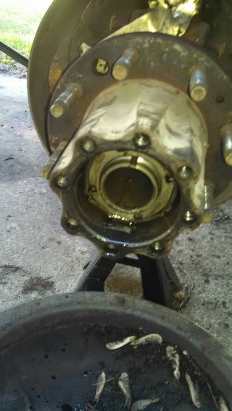

finishing up the rear
Freedom!
almost there...
Grab another beer, grab some primer, grab some paint, and grab a wire brush...
Where the hub was (back part) has some accumulated debris and rust. Clean that off and be sure not to get any of the gunk on the shiny metal...
Final step of tear down: belch loudly, realize you are out of beer, realize you don't have the axle seal outer for the hub to replace the parts that were on there, and you forget to get the donor rotors (in my case) turned prior to re installation.
