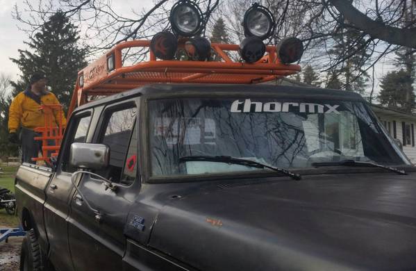

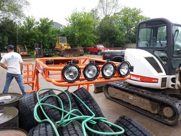

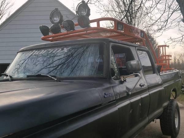

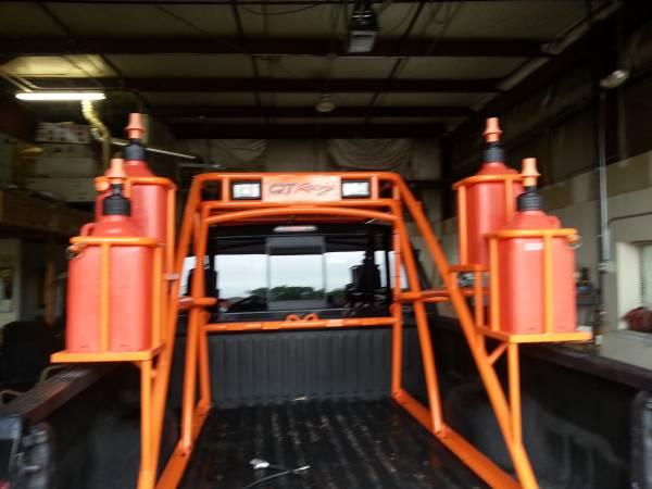

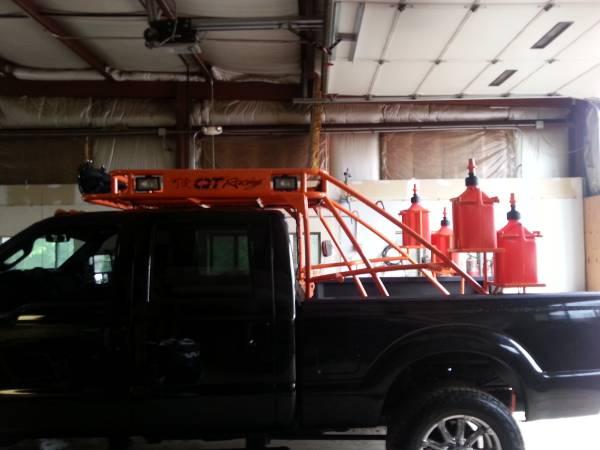

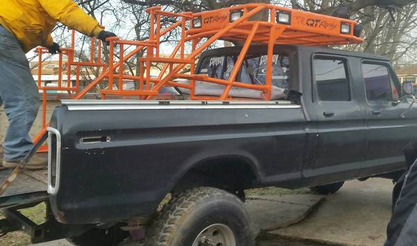

So not that I have stopped the process, its just that more of my time was spent with my little one as he has team sports currently. That didn't stop me though from Craigslist and ebay searches for what I needed/wanted, including a Baja rack.
For you purist on these old trucks, please turn away, back out etc. You will be more than likely be butt hurt by what I am adding to Eleanor (as if the diesel wasn't bad enough).
As for the rest of you that are not going to be butt hurt, This is essentially something I wanted all along, just not in this color...

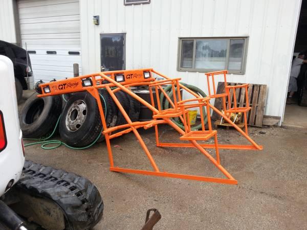

The good news is what I paid for it, I couldn't have even bought the metal to try and make it.
A quad will fit between the rails ( a smaller quad that it is), although it is designed to handle two dirt bikes.
It designed to handle two spare tires, but not sure if:
a. it will fit with these 37" MTR's
b. that would be a heavy lift.
Lights were included. Looking for military grade lockers (weather proof) such as Pelicans to put on the top rack for storage, etc.

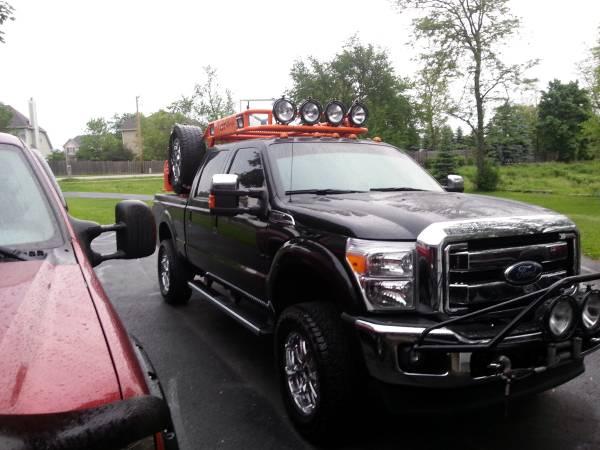

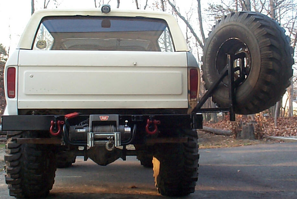

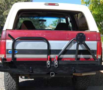

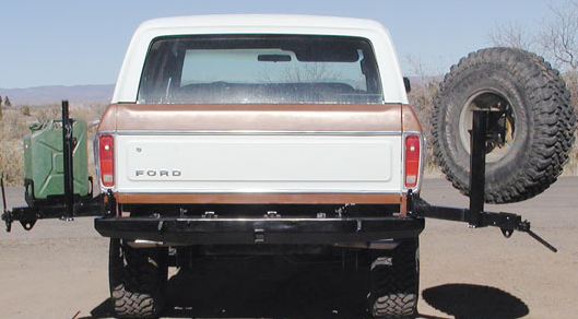

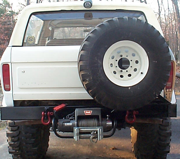

spare tire carrier ideas
38.5 and a half inch tire on a 78-79 bronco. would still have access to my bed with the bronco inspired design...
But since I am running 37's, and I know the possibility of finding a replacement tire in BFE would be a small challenge, I wanted to at least be able to run the capability of carrying two spares...left side is for Jerry Can style carrying...but replace and modify for another spare tire holder...

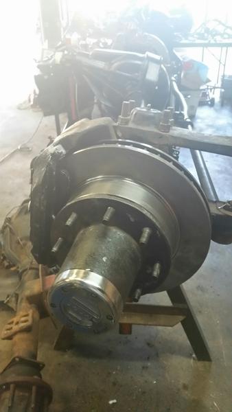

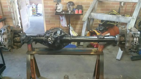

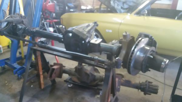

got the D60 back
New from end to end...
My better half has volunteered to add some artistic touches to the differential cover. We shall see...

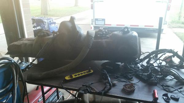

spaghetti...everywhere!
so I now have two steering columns, cause we butchered the first one unceremoniously. Master Chief Willard and I are hoping to patch the new column, the old harness, and all my crap and have a go at firing up Eleanor this coming weekend.
Mind you, not road ready, but after all this so far, it would be nice to hear her purr as only a diesel can. But we shall see.
If we manage to get everything situated, I will post a video.
